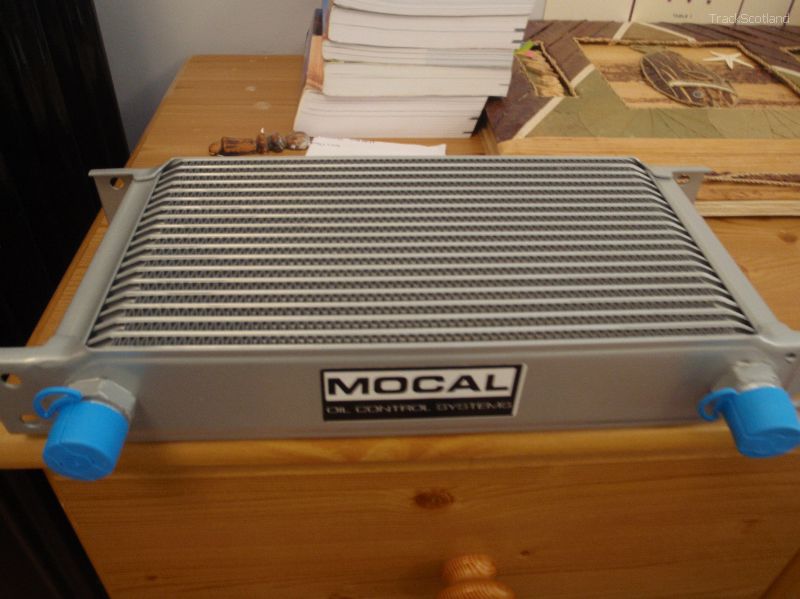

10th Sep 09 at 11:41   View User's Profile U2U Member Reply With Quote
new (bigger) oil cooler.
235mm wide, 19row -10 JIC fittings.
Replaces the 16row one that was onlt engine during bearing failure.

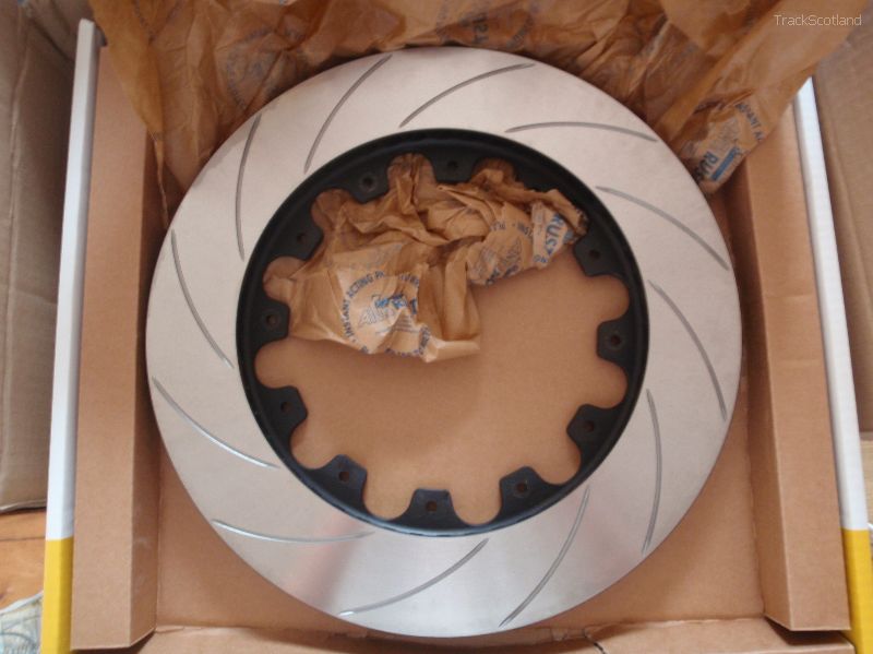

New AP 355mm x 32mm discs on the way to replace the cracked (snapped) 356mm KSports.

11th Sep 09 at 14:08   View User's Profile U2U Member Reply With Quote
some big AP discs....

11th Sep 09 at 16:18   View User's Profile U2U Member Reply With Quote
is it just me whose eyes go funny looking at tht oil cooler lol

22nd Sep 09 at 16:26   View User's Profile U2U Member Reply With Quote
new AP discs fitted to the KSport bells. Old KSport discs were in a shocking state. Not that worn (thickness wise) but one disc was just covered in cracks!

22nd Sep 09 at 19:29   View User's Profile U2U Member Reply With Quote
jesus that disk
I wonder if it went through a puddle after severe braking or something.

22nd Sep 09 at 19:39   View User's Profile U2U Member Reply With Quote
dont think that could be a possible cause.... who knows
sand-eel
Registered: 15th Mar 07
22nd Sep 09 at 20:08   View User's Profile U2U Member Reply With Quote
It could start off microscopic cracks, then just heat cycling made the cracks bigger maybe.
