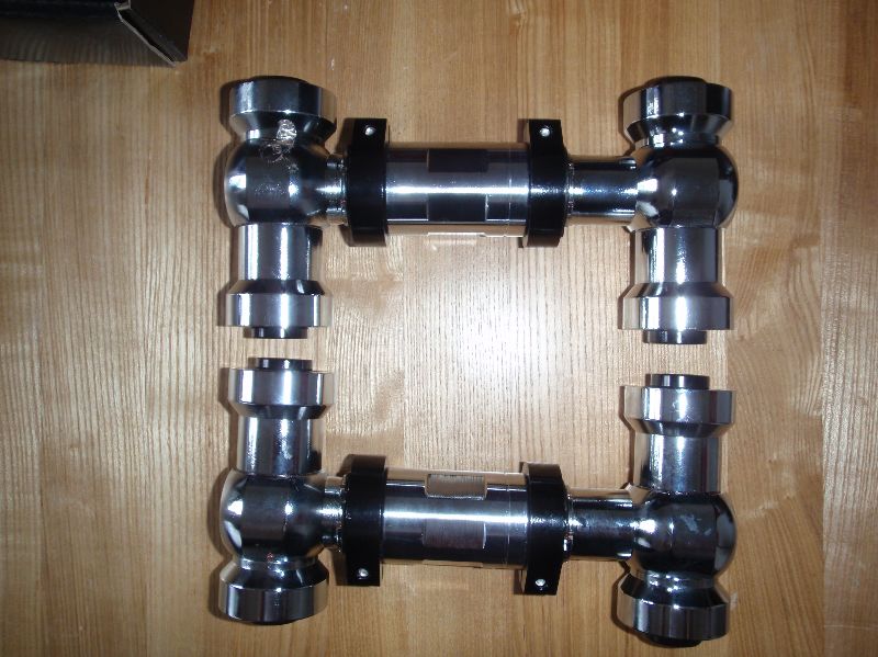

Super Wife Fee has been busy today
Fitted the tension rods:
Upper Camber Arms:
Then it'll be along to Wallace Performace to get the front end re-set. -3 deg camber and some positive caster

Positive caster will be as long as the track is smooth.

what does caster do? is this how far forwards / backwards he suspension strut is in relation to vertical? why - benefits?

effectivly gives more camber when cornering....
wheels go where they are meant to go, rather than trying to swivel round there centre axis.
AK
Registered: 5th Jul 00
Location: Aberdeen City
14th Jun 09 at 21:38   View User's Profile U2U Member Reply With Quote
Camber stays the same if the pivot (vertically) of the car suspension is zero. EG if you turn the wheel about its axis (steer not spin) it stays the same. BUT if the axis is at an angle (for and aft) then the more you steer the car, the more camber you get!
Its hard to relate, but if you imagine looking at the LHS of the cars wheel, with front to your left, if you grabbed the top of the axis and moved it back (to horizontal) with the wheel position staying still then this is castor, then imagine, if you turned the wheel to the right 90 degrees then the wheel will lay flat, this is obviously an extreme example but best explained.
SO, the more castor the more the wheel will increase negative camber the more you turn the wheel. BUT too much castor and the car will want to wander as it has less tendency to want to point straight ahead.
