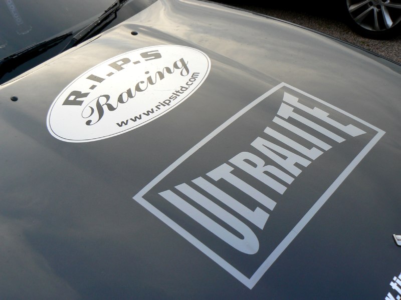

RIPS Stuff There work / products are amazing!
Looking good AK!

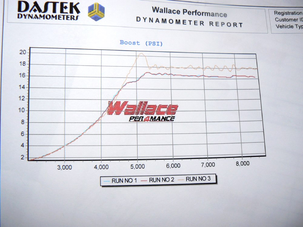

rollinroad done on phase1 engine state
410bhp
weigher car with half tank and shit in the boot - 1420kb (prob around 1400 with racing trim)
Run1 - 1.2bar
336WHP
393BHP @ 7618rpm
306lb/ft @ 6118rpm
VID http://www.trackscotland.co.uk/vid/RR/skyline_run1.wmv
Run2 - 1.2bar
337WHP
393BHP @ 8176rpm
303lb/ft @ 6023rpm
VID http://www.trackscotland.co.uk/vid/RR/skyline_run2.wmv
Run3 - 1.3 bar aim, but large fluctuations due to contoller self learning gain/ratio
357WHP
410BHP @ 8166rpm
328lb/ft @ 5394rpm
VID http://www.trackscotland.co.uk/vid/RR/skyline_run3.wmv
The last run was fine for A/F ratio, but the boost was all over the shop, prob would have been higher if there was time to get it setup correctly but it was very late by this point, and didnt want to ask Russ to hang around longer
A/F Ratio for all runs: aprox 14 at 3000rpm, and 10 at 8000rpm
Boost: Runs 1 & 2 - 17psi. Run3 peaked at 21psi, then fell then oscillated.
InjDuty on 3rd run..... wait for it 99.8% :O :O I'll be running it at 1.2bar still then
Graphs will be posted in the morning

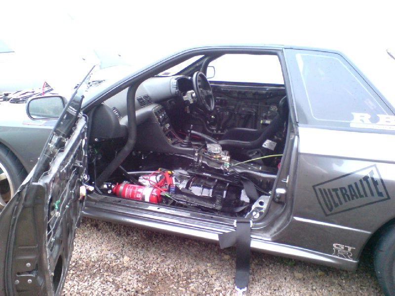

new seat
