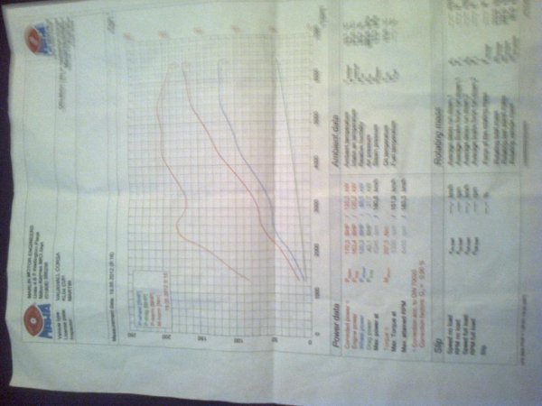

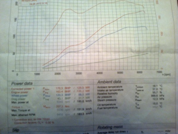

4th Mar 13 at 09:27   View Garage View User's Profile U2U Member Reply With Quote
[img][/img]
[img][/img]
just for those who doubt the figures of this car. sorry its not a very good pic but i dont hav a scaner.
chris_uk
Registered: 8th Jul 03
4th Mar 13 at 09:31   View Garage View User's Profile U2U Member Reply With Quote
Cant really see alot, i wonder why they didnt up the rev limit. Where is the torque?
davegreen
Registered: 20th May 12
Location: Oxfordshire
4th Mar 13 at 09:32   View Garage View User's Profile U2U Member Reply With Quote
thier only 256 degree cams so one step up from standard. will be going to a 268degree cam when i re do the engine. courteney recon its about average for the current mods. realy needs a remap now to get the best out of it now its got a freer flowing filter and exhaust system in the corsa. what cams you using? who mapped yours?
no point in upping rev limiter as max power is at 6350rpm doesnt make any power after that.
