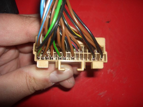

Originally posted by warren.g
get a pic that is in focus and remove the pin cover, like in my pic.
Warren G
Registered: 14th May 06
10th Apr 07 at 18:01   View User's Profile U2U Member Reply With Quote
will have to get o proper camera then! will do tomorrow then

switch round the wires in positions 6 and 11
Warren G
12th Apr 07 at 21:07   View User's Profile U2U Member Reply With Quote
okay will do that! what are the wires im swapping tho
ones knock sensor, and the other one is....
Dave A
Registered: 10th Dec 03
12th Apr 07 at 21:10   View User's Profile U2U Member Reply With Quote
both knock sensor wires, early sensors have only 1 wire, later ones have 2
the early ecu you are using only requires the signal from the screed wire so swopping them round will do the same job.

didnt work, made it missfire (number 6 is for injector 4!!!)
unless you no which one it is, because i cant see on wiring diagrams, i could undo the knock sensor and swap the pins over there if all else fails but would rather change it at the ecu end

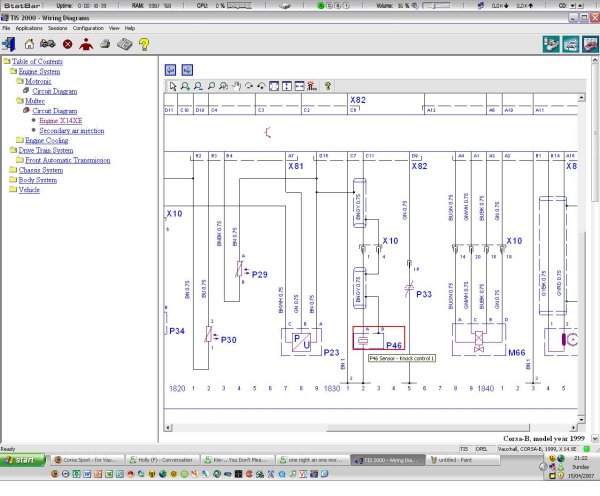

15th Apr 07 at 20:48   View User's Profile U2U Member Reply With Quote
P46 - knock sensor
X10 - is the blue plug which is next to the alterntator, has all injector wires too
the knock sensor has two wires (A/B)
A is connector C11 on the ECU loom plug
whats different on the single wire knock sensor loom/ecu????

do this:
Warren G
16th Apr 07 at 16:12   View User's Profile U2U Member Reply With Quote
c11 to c1 then! will do tomorrow

1m 99.9% sure that should solve it mate, got confused when I said pin 6 (or whatever I said was the injector one) as the wire looked red/brown but after investigating it should be pin 1.
