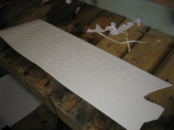

My word this takes a while.
3rd Sep 09 at 18:28   View Garage View User's Profile U2U Member Reply With Quote
When applying it to the car put a strip of masking tape straight down the centre, it will hold it still on the car, peel back the application paper and stick it to the car and smooth down from there, you should then be able to pull back the bottom bit of paper whilst smoothing the lettering on.
Also, if there is any bubbles in the lettering put a tiny hole in it with the tip of a razor and smooth them out with your finger, not a squeegy as it will most likely crease the lettering.
[Edited on 03-09-2009 by DannyB]
Leighton
Registered: 21st Feb 01
3rd Sep 09 at 19:08   View Garage View User's Profile U2U Member Reply With Quote
Not quite at the application stage yet, still getting it all cut.

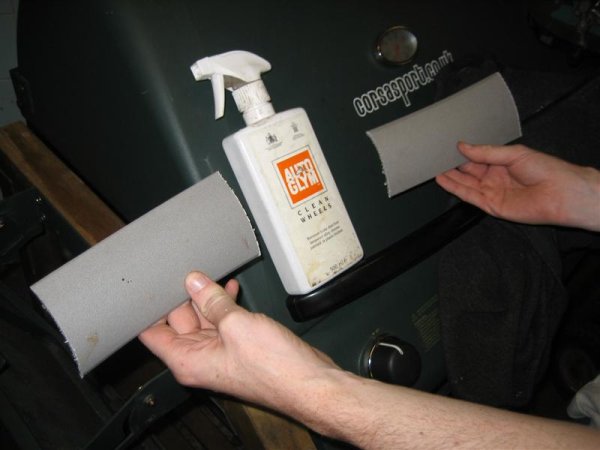

Ford OE Windscreen pillar squeegies and said Autoglym bottle, checka.
3rd Sep 09 at 20:23   View Garage View User's Profile U2U Member Reply With Quote
Cut them squeegies to credit card sized if you can, be much easier.
See my video above.
