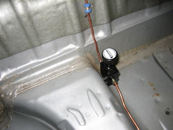

Bias valve is fitted and I've left Ian a nice puddle of dot 5.1 from cutting and flaring the pipes.
IAN: Ensure you top up the brake fluid reservoir and if needed, give it a quick bleed before you drive it. I've left a half made bracket on the bench. pics needed of it fitted

Decided against the bracket.
Just straightening the pipe then pics ahoy.
