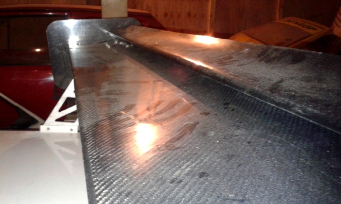

boot swapped for GRP skin, OE spoiler ditched too - saving about 10kg
Dual element wing fitted.... just inside the width, and in line with the roof

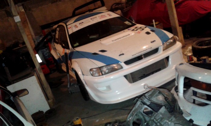

Front bumper 'editing' started... this is a replica of Fee's... and Fee's being a 22B shelled car it requires a bit of work to make it fit. Getting there though.

Mounted the 22B bumper to my 'thin' TypeR.... a few issues but fits. The ABW arches needed trimming, and makes me want 22B arches on this one even more
More of the wing and rear GRP boot skin mounted

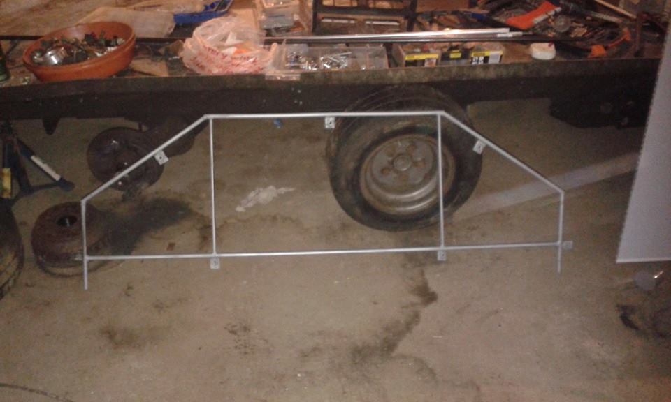

Frame made up for the composite splitter, and zinc primed. Used 12mm tube (1mm wall thickness) for the main frame, and 8mm for the braces.
Will work on mounting it to the car (triangulated uprights with tubes to bolt through) with 5 fixing points to the chassis. 14mm Tube for those

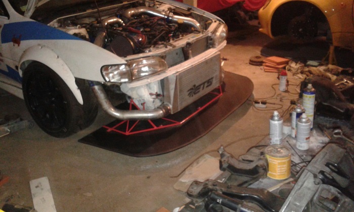

HDPE strip applied to base of bumper to bridge the gap.
I can lower the splitter easy enough, and could raise if needed with a bit of chopping and welding.

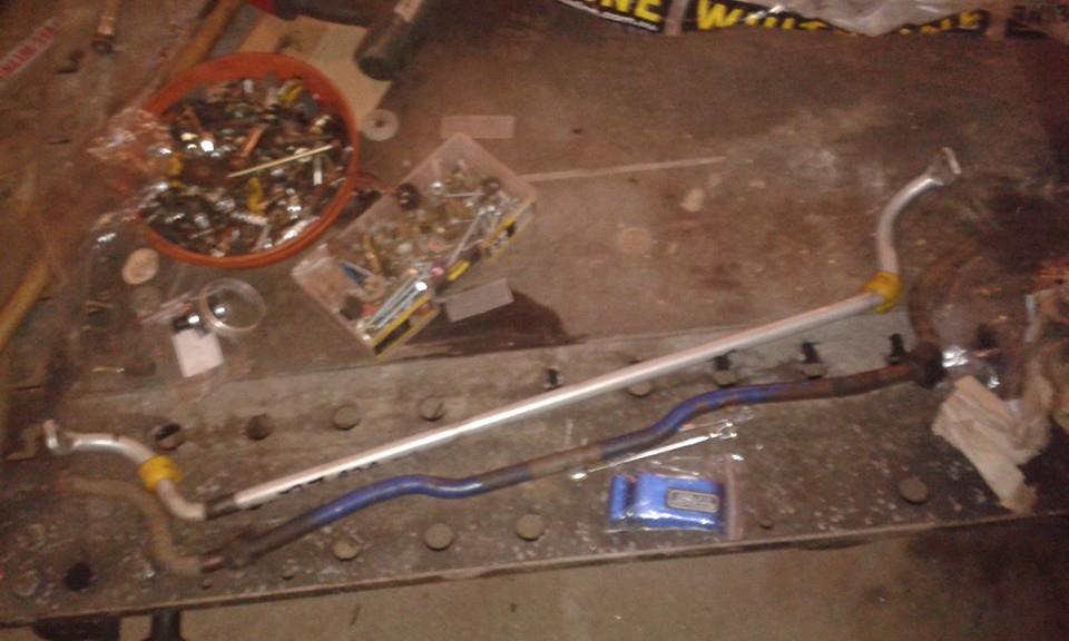

Braced the rear ARB mounts - rather than spending £££ on aftermarket ones
couple of tie-bars added to splitter
Headers on their way, so removed the old split ones and wrapped the spare up-pipe. Moved to 3 bolt pattern from 2. My old headers had horrible lagging on them so a bit itchy now!!!
Swapped my unknown front ARB for fee's old 22mm whiteline one. Its larger diameter, and a simpler design.
