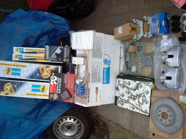

parts have arrived,
280mm brakes,
B12 suspension kit,
BF Goodridge brake hose's,
Piper cat back exhaust,
decat manifold,
K&N panel filter,
full service kit,
cam chain kit.

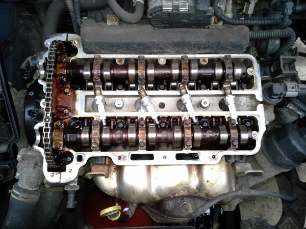

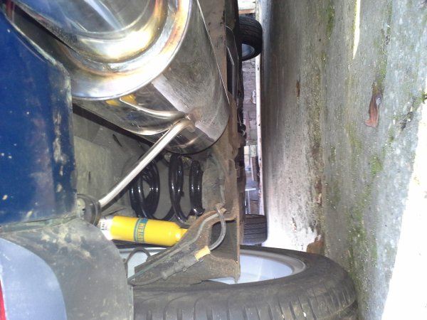

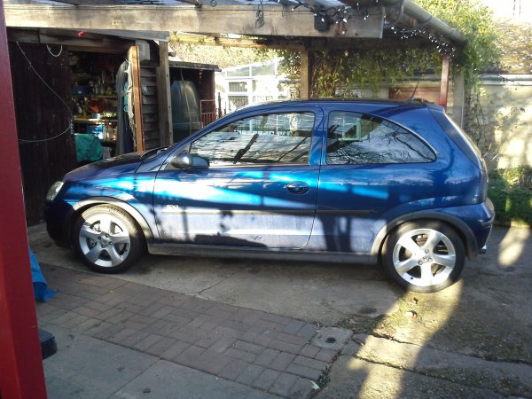

got most of the parts on last Sunday, brake's, hose's, exhaust, suspension and new wheels,
had a look in side the top of the engine and was surprised how good the chains are so left them alone. cleaned cam cover and breather tubes out fitted new plugs but the old ones look almost new as did the filters.

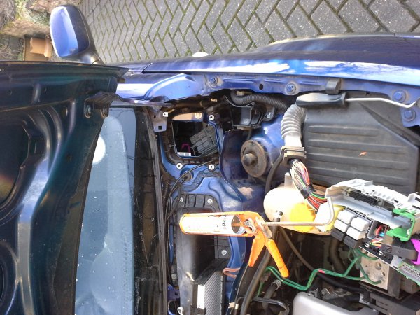

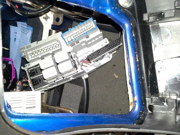

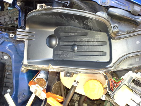

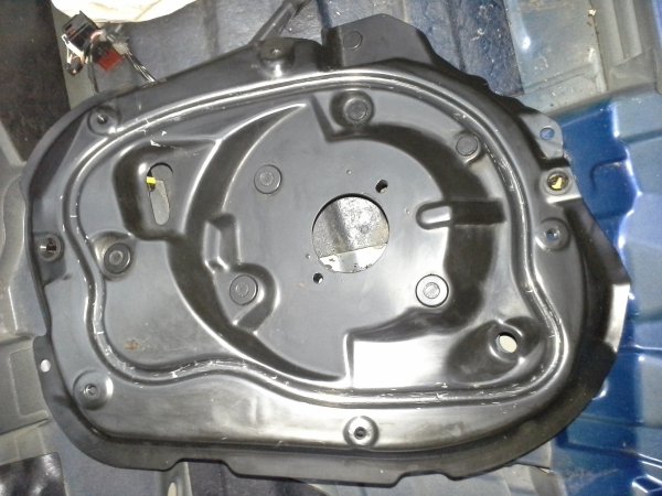

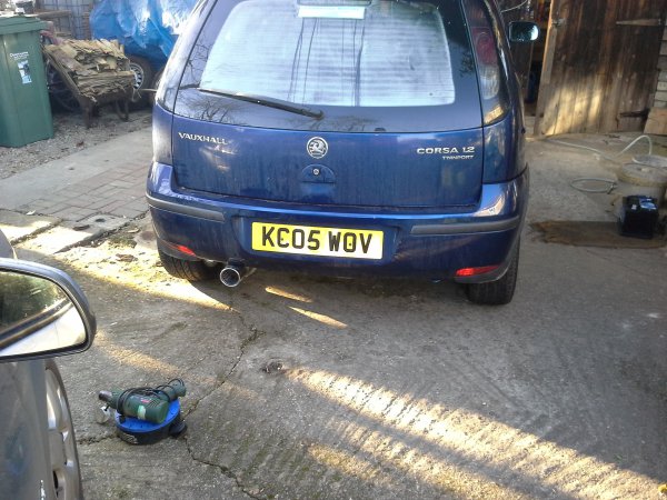

had some time this morning so fixed the water leak on mums Corsa from the bcu/relay box,
[img][/img]
[img][/img]
[img][/img]
used tiger seal to seal lower part to body then rtv sealant to seal top cover on in case I need to remove it in the future.

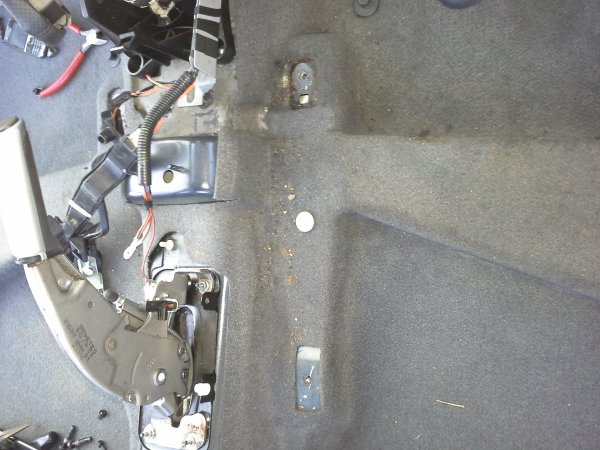

still had some time before Christmas dinner so started on my Corsa, removed seat's and found a golden nugget
[img][/img]

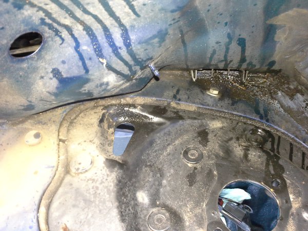

but good fortune soon came to an end when I lifted carpet out,
[img][/img]
at least I've had practise fixing water leaks on mums car now.

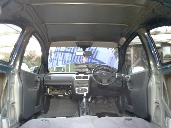

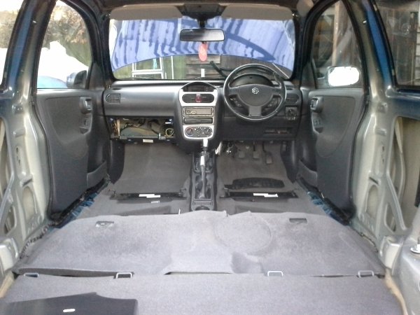

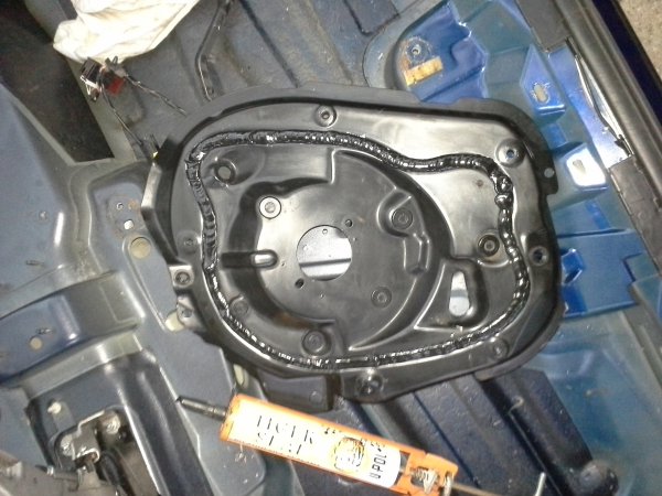

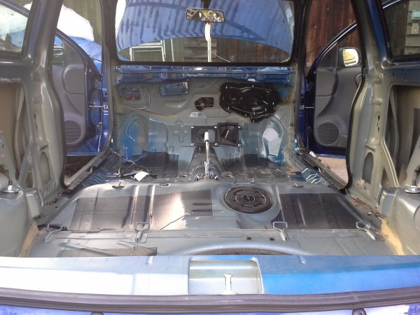

spent today removing the rest of the trim from the interior, fixed the brake servo seal water leak, cleaned and refitted trim and carried out several repairs/mods on the way including fitting tilt adjust steering column.
just need to modify the corsa b cobra seat sub frames to fit and the four points to bolt in.

as you can see the sealant has cracked around the bottom of the servo plate, also it was full of leaves and other muck,
[img][/img]
removed and cleaned the plate then applied plenty of tiger seal,

put all the needed interior trim parts back in,

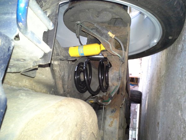

As for the dampers at the rear to answer a question
Most aftermarket dampers are for the sri which has a larger bolt. But with a sleeve that goes in the bottom of the shocker it reduces the size for the non sri rear beam

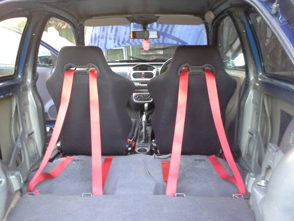

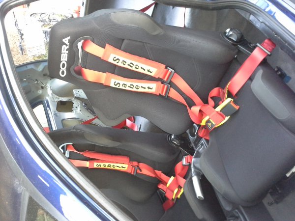

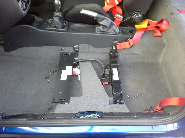

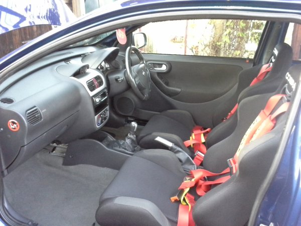

fitted the cobra seats today along with 4 point harnesses. only I forgot to drill the rear cross bar l/h and r/h
still only extra holes. wired up stereo, fitted dual tone horns and flat blades from the old corsa B, fitted spare head lamp I had as its in better condition than old one, bleed brakes and clutch, had to back bleed the clutch as it would not vacuum bleed at first, must of had an air lock?
just need a test drive to see if its improved and what exhaust sounds like now?

these came with a 10mm hole in the bush, no spacer's like the coilovers had on the other corsa C.

The little silver sleeves are reducers

didn't have them on this set, just a fixed hole. but have seen them on other sets.
