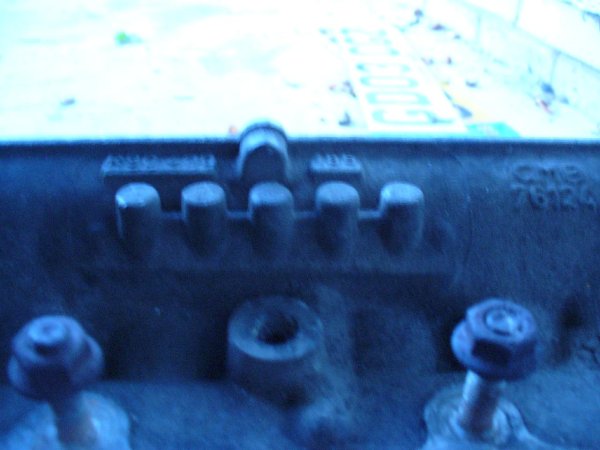

Looks the same as my C16XE head -
Vaux Lad
Registered: 15th Dec 04
Location: Stoke-on-Trent
13th May 07 at 12:41   View User's Profile U2U Member Reply With Quote
But that looks the same as my x16 head/\
Lmao
Scotty C
Registered: 6th Nov 05
13th May 07 at 12:43   View User's Profile U2U Member Reply With Quote
The X16XE head has bits of casting goin in between the spark plug holes.

Indeed it does, just looked at pics of mine.
Never noticed that before.
Scotty C
13th May 07 at 12:54   View User's Profile U2U Member Reply With Quote
WTF are they? they must serve some purpose.
Back to the original question, It MUST be the C16XE head then.
Vaux Lad
13th May 07 at 13:06   View User's Profile U2U Member Reply With Quote
Yup it must be c16xe.
As x14/x16xel ports are different.
And X16xe has casts near the plug holes.
Looking at them, they dont seem to serve any purpose, there just there,lol.

Went to warren.g's today and have confirmed that its not the right head
Its an X14xe / X16XEL as the inlet ports are smaller

ive seen x14/x16/c16 with and without those round castings in the head.

Originally posted by Monster
Originally posted by warren.g
5 dots - 1600 head
3 dots - 1400 head
inlet ports - 48mm for 1400 head
inlet ports - 54mm for 1600 head
as we found out today gavin!
Robin's 1400 head has 5 dots.
had 4 cylinder heads in front of me today..
the 5 'dots' you can see in the picture works out what head you have, the heads with 5 dots extruded where my c16xe head and gavins x16xe head
and the ones with 3 dots extuded (like in the picture, but not visable due to angle of picture) were my x16xel cylinder head (aka a 1400 one) and the new head gavin had, which tuned out to be a 1400 one
ports sizes were measured - 1400 head 48mm across inlet ports, 1600 head 54mm across inlet ports
and exhasut ports all the same

So, my X14XE head should have 3 sticky out dots and 2 flush ones?
13th May 07 at 19:25   View Garage View User's Profile U2U Member Reply With Quote
Which it doesn't -
and it is 100% a 1.4 head.

13th May 07 at 19:30   View Garage View User's Profile U2U Member Reply With Quote
I can't measure the port sizes Warren, it's a ported head
I don't think there's an actual way to tell by looking, unless you measure the ports TBH.

46mm exhaust, 55mm inlet on mine, I measured it anyway

surely the dots must be there for some reason
Dave A
Registered: 10th Dec 03
13th May 07 at 20:14   View User's Profile U2U Member Reply With Quote
same dots are there on my z18xe....

okay
DOTS
x14xe x16xe c16xe
3 5 5
3
5
do continue
