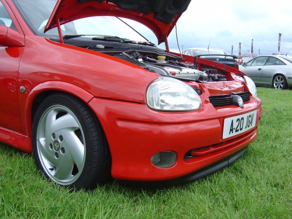

Looks so Hot. Have another pic in my Garage.

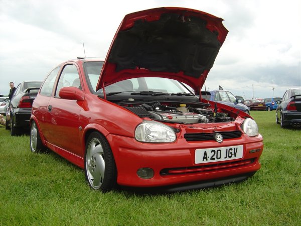

Both taken at PVS 2005
