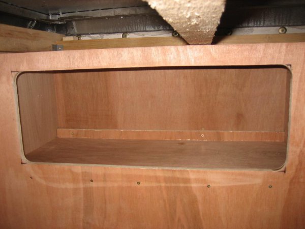

Today's job - wardrobe interior and face, toilet wall which joins the shower room wall which we did yesterday. Also put a shelf above the top bed which you can't really see but that finishes off the bed section, all tied in nice and strong now.
Going to spend some time on sizing up the kitchen then we can get the pipes run alongside fitting the Kingspan which is coming this week.
