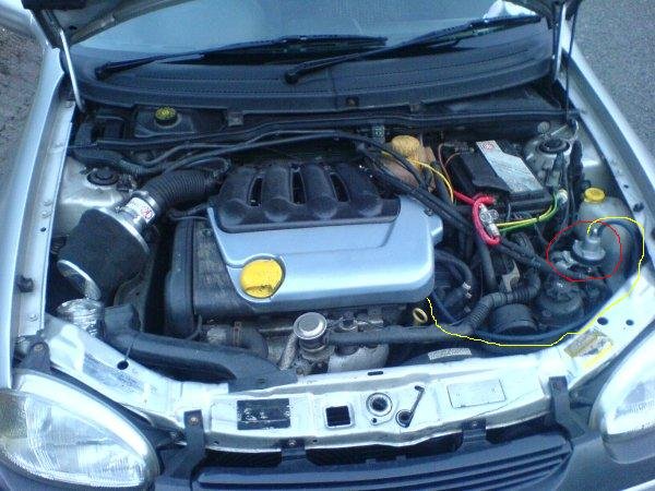

scaron5188
Organiser: South West
Registered: 17th Apr 08
14th Apr 09 at 23:00   View User's Profile U2U Member Reply With Quote
alright mate, it has standard inlet, but i have just looked at a pic in gregs garage, and remembered when we brought the car he was selling a power boost valve aswell, as im sure it is in the picture circled in red. and the hose im on about i've drew a yellow line by it.
seems he may have took the boost valve off and just stuck the hose back where it should be. so mayb this is what was causing it.
so do you think i put the correct size hose on it will be ok? or at least improve it?
cheers, aaron

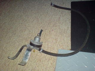

14th Apr 09 at 23:06   View User's Profile U2U Member Reply With Quote
this seems to be what was on there...
from greg-turbos for sale thead
Richardhhha
Registered: 29th Sep 07
Location: Croydon, Greater London
14th Apr 09 at 23:08   View User's Profile U2U Member Reply With Quote
holy fook thats way to long....
the hose thats sposed to go on the FPR is 3mm hose or is it 4mm canny remember but mine had 3mm put on it after i found my hoses to have split.
it should be only about 20cm long and be running off the inlet manifold.
this could be the problem.. also the fact he put a boost valve on it might be asking why.....

scaron5188
14th Apr 09 at 23:12   View User's Profile U2U Member Reply With Quote
dont know why i never questioned that hose before. yea he must have connected the hose back to the fpr when he took that shit thing off, so it is currently connected from the inlet to the fpr (the right place) but just way to big? well compared to mine it is lol
so may well be the problem. fingers crossed.
you've been a really great help rich. cheers
