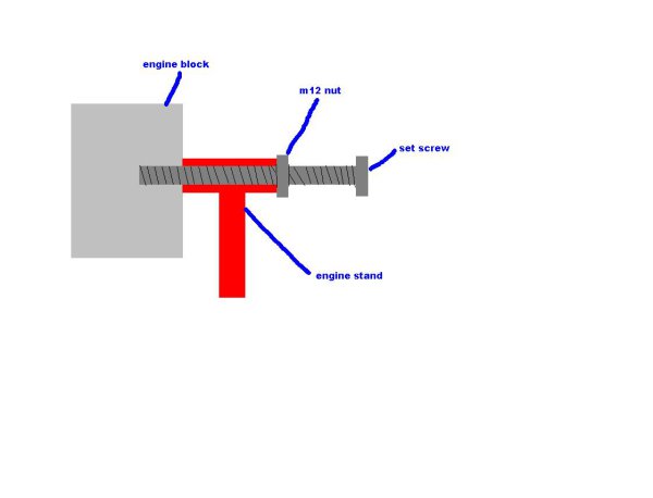

The way I do it is with M12 x 120 set screws and screw a nut on all the way first. then line up the engine on the stand, screw the set into it till it bottoms out, then tighten the nut to clamp it together. You can't do that with bolts as they aren't threaded all the way up.

you use that method in order to space the engine away from the stand you mean? pretty smart. Set screws have a long neck on them then? Worth looking into, simple way of spacing it off

This is what I meant, the nut acts as a shortner for the set screw and means you can vary it's length without cutting it. Just ensure you don't have it too long or you won't be able to spin the engine stand over as they will catch.
