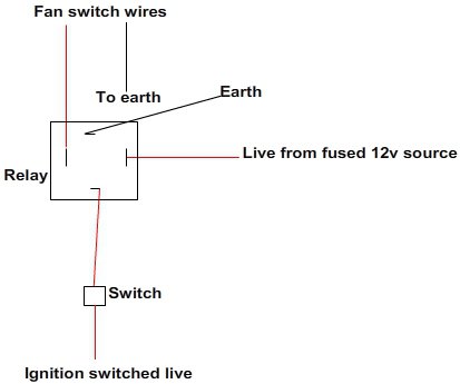

I would like a diagram to put my rad on a switch1 thanks

Something like this...
Cant remember pin numbers on the relay.
Easy to find out just put 12 across 2 opposite pins. If it clicks then they are the switching ones that goto ground and your switch

Excuse my shite drawing. Couldnt be arsed looking for the correct symbols etc

The problem is i converted my corsa to a xe and the fan used to come on but now dont. When im driving temp is fine bout 90ish but when stuck in trafic or still goes up to 100 and no fan any more so was gona try puting on a manual switch

OK use that wiring diagram but where it says fan switch wires, just take that as the +ve and -ve out of the fan motor and will work fine.
Before you do that check the fan is wired to the fan switch (in the rad normally) if so touch those wires together and see if it comes on. If it does its a faulty switch, if not then it'll either be a dicky fan motor or dogey wiring

Ok thanks. The fan has worke since its been a redtop
Gary
Registered: 22nd Nov 06
17th Feb 11 at 17:31   View Garage View User's Profile U2U Member Reply With Quote
It has worked?
My money is on a dogey fan switch then
corsabrad
Registered: 16th May 09
Location: Tamworth, Staffordshire
17th Feb 11 at 18:06   View User's Profile U2U Member Reply With Quote
Yeah has worked. Il bridge the fan switch sat and see if it comes on. Thanks for your help
