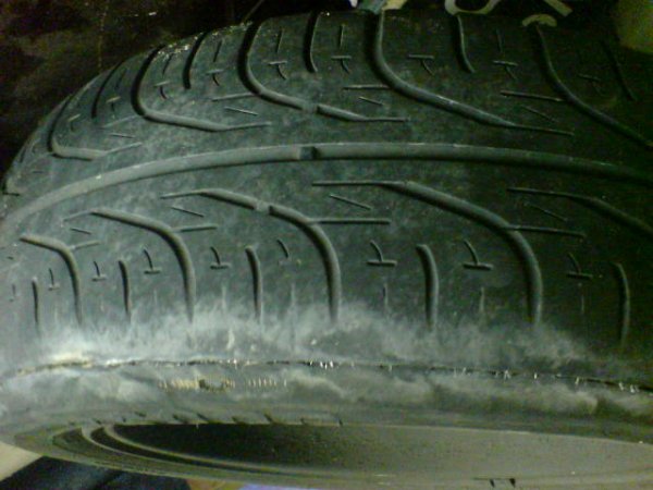

Some pics of the damage...
Got 2 new tyres and had the tracking done now... hopefully should be ok...

Did they say the tracking was out?
Shelly
Registered: 15th Nov 00
13th Nov 07 at 19:20   View Garage View User's Profile U2U Member Reply With Quote
I had no idea they were that bad...
Yeah the mechanic said thats what it would be, hopefully all sorted now.
Steve X16XE
Registered: 31st Dec 06
13th Nov 07 at 19:28   View User's Profile U2U Member Reply With Quote
So nothing is damaged under there?
Shelly
13th Nov 07 at 19:31   View Garage View User's Profile U2U Member Reply With Quote
I don't think so, the garage checked it over anyway...
