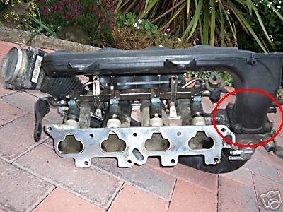

Looking at the inlet/engine last night ive noticed a problem
The lexmaul inlet has a round section that goes to the throttle body but on the actual plastic inlet its square which joins onto the flat part of the throttle body with 4 bolts!
Rob Marriot said use a section of hose and jubilees but theres nothing that i can see that you'll be able to join it to???
anyone?
Rob
19th Oct 06 at 07:09   View User's Profile U2U Member Reply With Quote
i'll have a look rob as mine was fine with the standard c16 intake pipe for the inlet
Rob_Lee
Registered: 9th Dec 05
19th Oct 06 at 07:13   View User's Profile U2U Member Reply With Quote
Did you use the C16xe throttle body?
Cos i cant see how the round inlet on the lexmaul will fit onto the square section shown above
lee mitchell
Registered: 26th Jan 01
19th Oct 06 at 07:15   View User's Profile U2U Member Reply With Quote
jr u may have had a x16 body i think
19th Oct 06 at 07:29   View User's Profile U2U Member Reply With Quote
thats true, but does the car run a TPS sensor of the TB ?
as i was using a c16 loom, so would the c16 loom run a x16 tb ?
19th Oct 06 at 07:30   View User's Profile U2U Member Reply With Quote
ignor that as my tb was round
Rob_Lee
19th Oct 06 at 07:38   View User's Profile U2U Member Reply With Quote
So i do need and X16XE tb then
lee mitchell
19th Oct 06 at 08:28   View User's Profile U2U Member Reply With Quote
yea im sure
Dave A
Registered: 10th Dec 03
19th Oct 06 at 09:50   View User's Profile U2U Member Reply With Quote
and x16xe lower inlet as the tb mountings are different
Rob_Lee
19th Oct 06 at 10:01   View User's Profile U2U Member Reply With Quote
yeah all sorted that end... Lees gonna check see if he has both
19th Oct 06 at 10:39   View User's Profile U2U Member Reply With Quote
im 99% sure ive got both rob
Rob_Lee
19th Oct 06 at 10:42   View User's Profile U2U Member Reply With Quote
well let me know cos i NEED them for weekend!
As said ill collect on saturday
