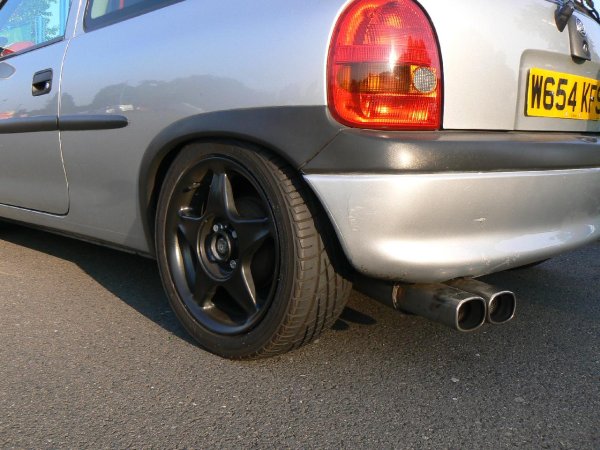

tsw pace on a corsa b:
i had them, were et42 on low profile tyres (195/45/15) and lowered 50mm

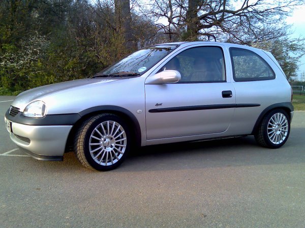

i've sold mine and is now on et45...even better...so take your time and get the correct wheels so that when coming to lowering, there's no problem at all

Speedlines:
