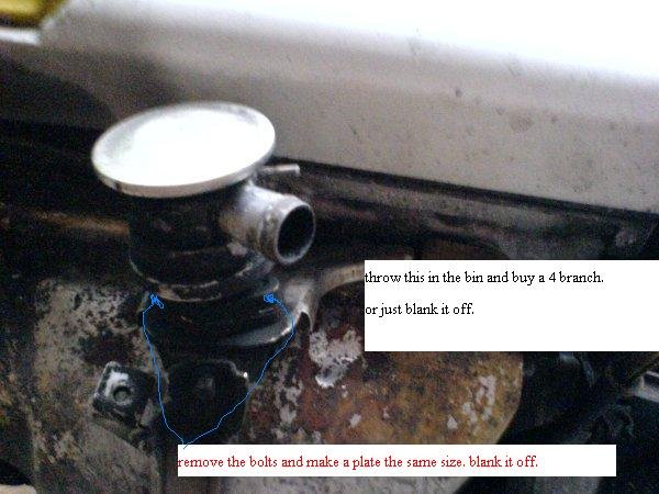

5th Oct 05 at 10:55   View User's Profile U2U Member Reply With Quote
Bin that secondary air pump, pointless waist of space.

5th Oct 05 at 11:00   View User's Profile U2U Member Reply With Quote
This one mate
Rileysport
Registered: 18th Jun 04
5th Oct 05 at 11:05   View User's Profile U2U Member Reply With Quote
thats where it pumps to... if your getting janspeed then that gets rid of that... its a big circular type effort, you have it in one of your pictures
Rob B
Registered: 8th Jan 04
5th Oct 05 at 11:07   View User's Profile U2U Member Reply With Quote
Ok cool ill probably end up with a four branch

when you bin this and the secondary air pump what do you do with the small sensor on the suspension strut that has a pipe or two (cant remember) going in to it. It also has a pipe that goes to fuel vewnt pipe i believe

10th Oct 05 at 08:41   View User's Profile U2U Member Reply With Quote
the little vacuumhose? close the end by putting a cap on it
