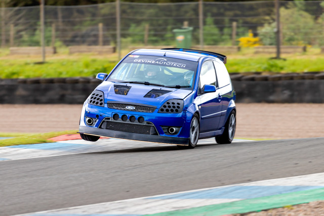

24th Jul 26 at 13:23   View Garage View User's Profile U2U Member Reply With Quote
Hello lurkers, a wee update.
The car is still going strong, alot has changed since my last reply. It's no longer road legal, it now weighs about a tonne and is currently 383bhp. It did do 403 but we turned it down.
Recent additions;
Full polycarb windows
doors/bonnet/boot have been single skinned
Tubular front end
S280 is now on
Chassis mounted front splitter
Rear diffuser with hidden centre exit exhaust
St180 EBC apollo 300mm 4pot floating disc brake set up
Gripper diff
Fiesta R5 msport full carbon rear spoiler
Loads I've probably forgot but yeah, just getting out there and driving it. It's done about 40 track days so far with a few wee issues but nothing crazy.
Very fun little car
