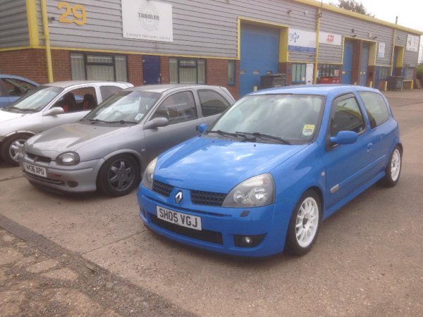

Not really a build thread this as the car is basically all done, only a cage, ported inlets and maybe some Wilwoods in the future.
Picked it up like this -
Gave it a quick service then set about getting the stripes off. Nightmare job, took about 3 hours!
Stripped the rear of the car
Swapped the steering wheel for an OMP suede one
Then got a load of bits ordered, bargain bucket seats (£300 for the pair)
Bargain Team Dynamics Pro Race 1.2s (£220 brand new)
Six point TRS harnesses
Vibra Technics engine mounts and a Powerflex dogbone mount
Ferodo DS2500 pads
S2000 aerial
Nankang NS2-R 195/50 15 tyres
Kam Racing solid top mounts
Got some Spax RSX coilovers coming tomorrow
So it's all being put together as we speak, ready for the wife to do Croft next weekend!
Seats are in tonight, will all be in one piece by the end of next week ready to use.

It's all done!
Got a picture of the vibratechnics mount fitted (can't see the other one but it is fitted!)
Had to replace the brake fluid cap, for some reason, after bleeding the brakes, the warning light was on.
Then we got the seats in, as I don't intend to put the car back to standard at any point, this was the easiest solution, got some bars welded in with captive nuts for the seat rails to mount to, also welded the plate for harness eyelets to screw into, then got the seats in for the final time.
Also replaced the wheelnuts with some with a smaller hex on them and ditched the locker as it was tight on the wheel and I didn't want to damage them.
Had to remove the fitting shims from the calipers too as the pads were binding but with them off there's no trouble, hopefully they'll be fine when they are red hot and I don't need to grind the ends of the pad down too.
It's round at Jamsport having the geometry done now and the Mrs is going to give it a good clean and polish before heading up to Croft.
[Edited on 06-06-2014 by Robin]
