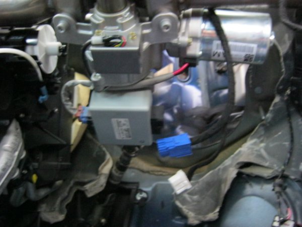

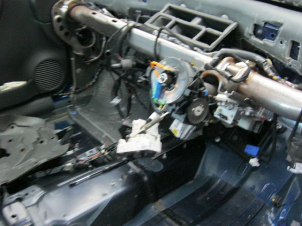

just fixed my mums corsa which had the same problem, only it was the plate that the pedals bolt to.
sealant had gone hard and split along the bottom edge. major job to strip and reseal, dash out, steering column out, around 12 hours in total.
best way to be sure where your leak is from is to get some one to pour water around the suspected area once you have carpet and under lay removed and watch for leaks.

not to bad to remove seats and carpet. underlay is a pig if you don't want to cut it as its one piece that goes behind heater matrix assembly. I cut mine then tapped it up when refitted. left carpets out for a week to dry. fitted underlay from the corsa im breaking. its not to bad job just a bit fiddly.

fuck, i did my girlfriends one as it had done the same and didnt have to do all that , i just took scuttle panel off, wiper motor then if you disconnect the brake pedal inside you can pull the servo out the way enough to re seal it , took me 1 hr 30 mins in total , then 30 mins to pull the carpet out been fine for the last 8 months

this was the plate the servo bolts to, never been seal 100% from factory and the only way to remove it is a strip out. servo seal was ok. and as you say an easy fix.
