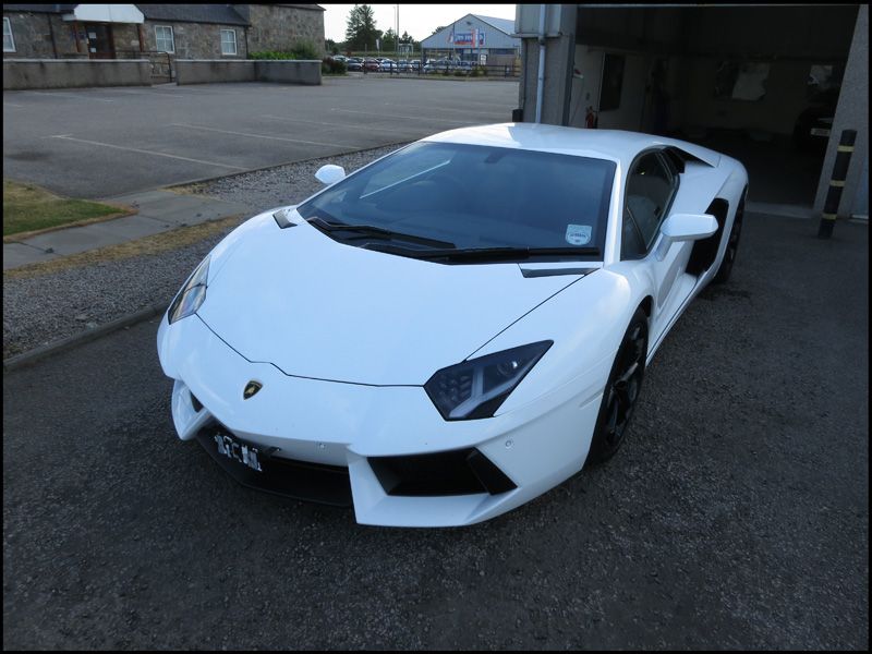

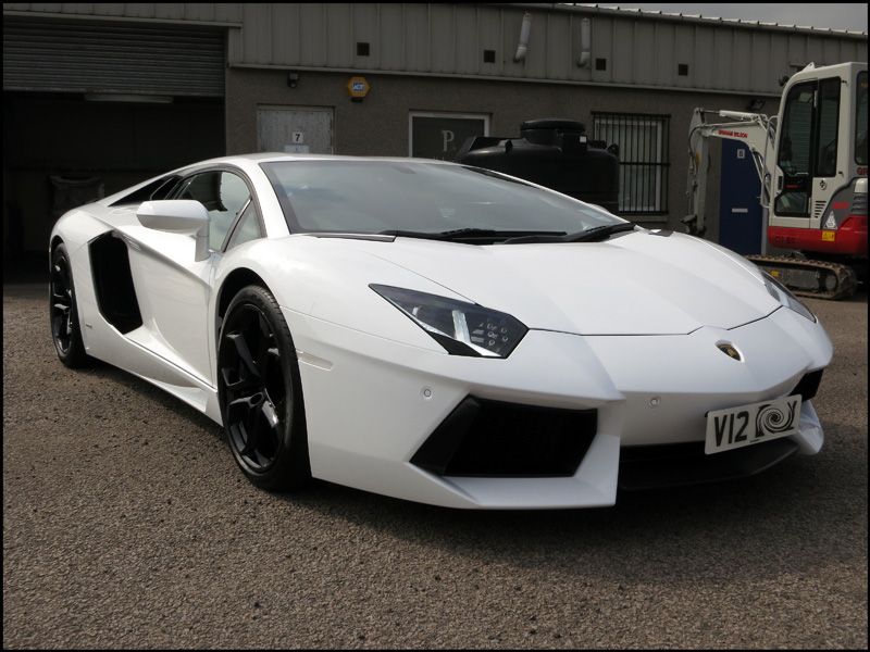

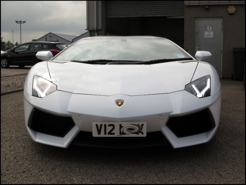

The car on arrival, still quite clean as I'd only washed it the week previous:

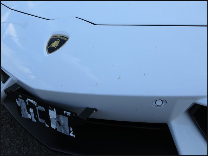

After a wash and going over with Tardis to remove any fresh tar spots I used a Speedy Surface Prep Pad to remove a couple of small iron deposits:

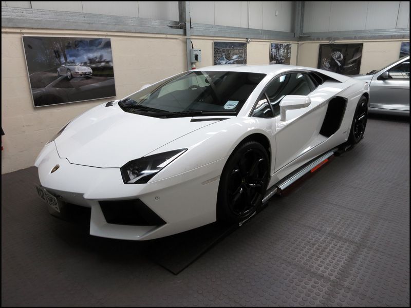

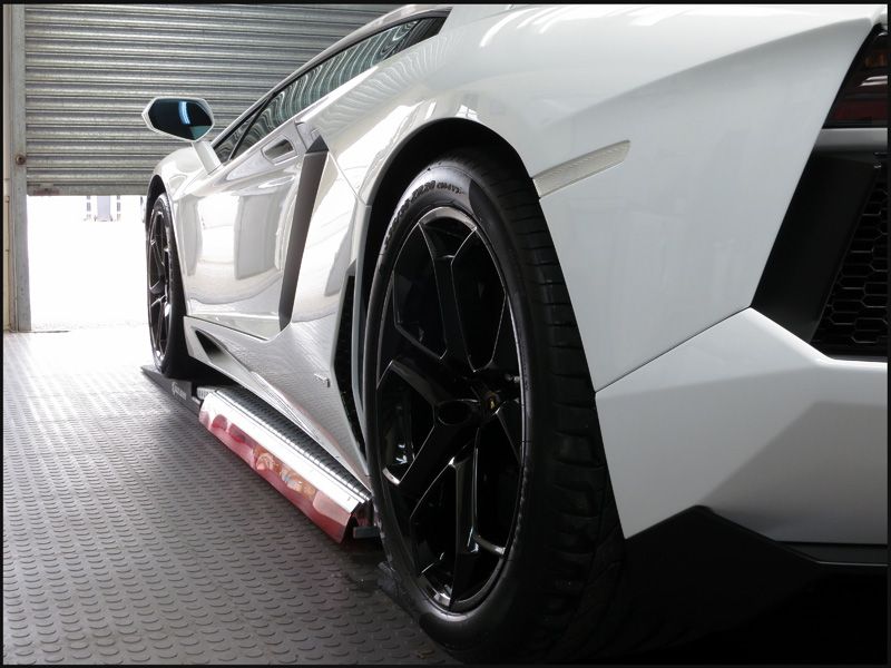

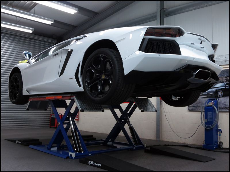

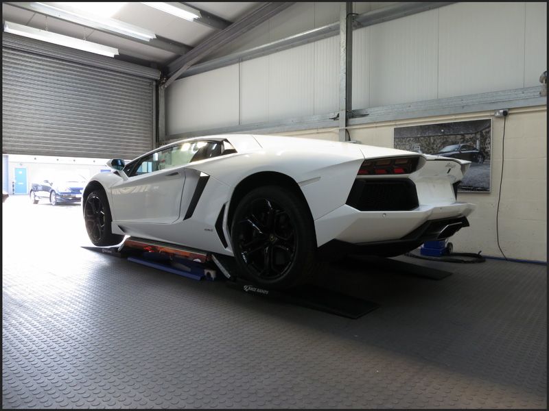

The car was then dried off with a PB Luxury Drying Towel and the Metro Vac before being put into position in the studio:

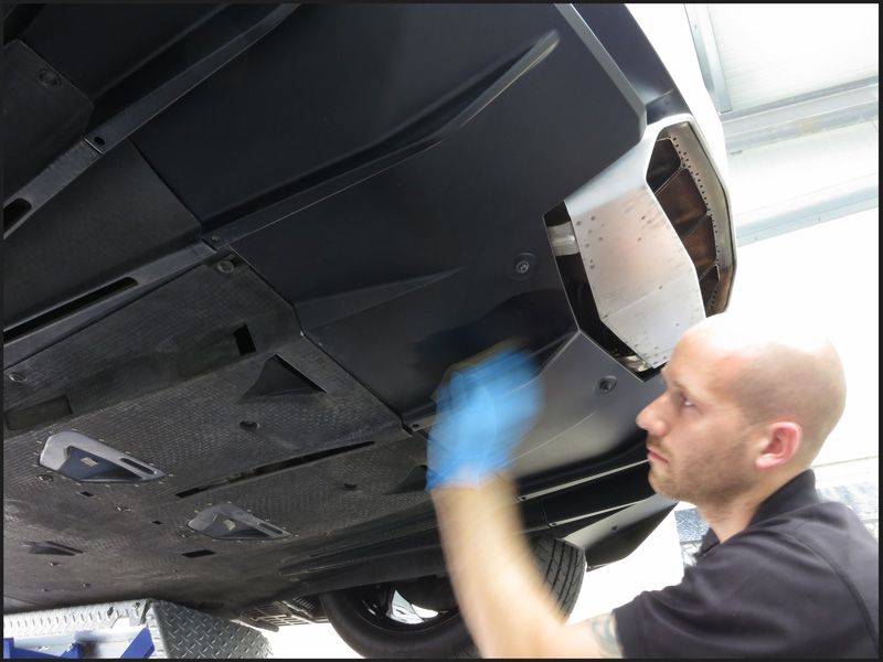

I no longer have to crawl around on my knees when doing the lower parts of cars :thumb:

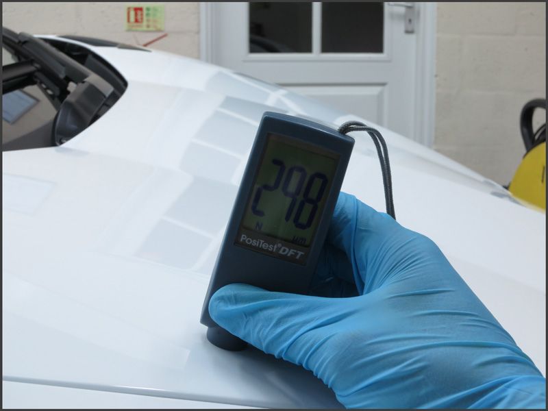

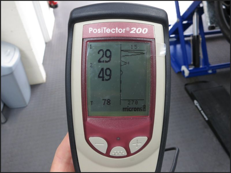

Paint readings were then taken:
Composites gauge for the non metal panels (of which there are many):
Metals gauge:

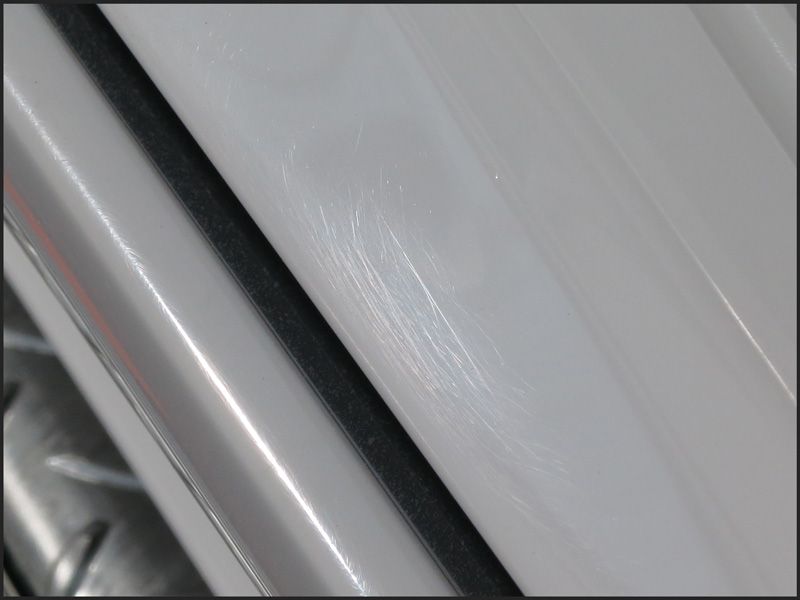

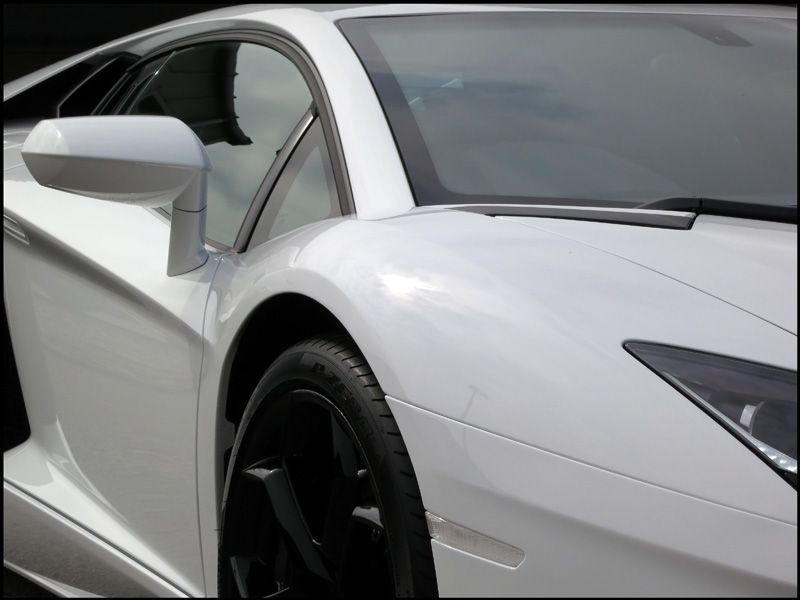

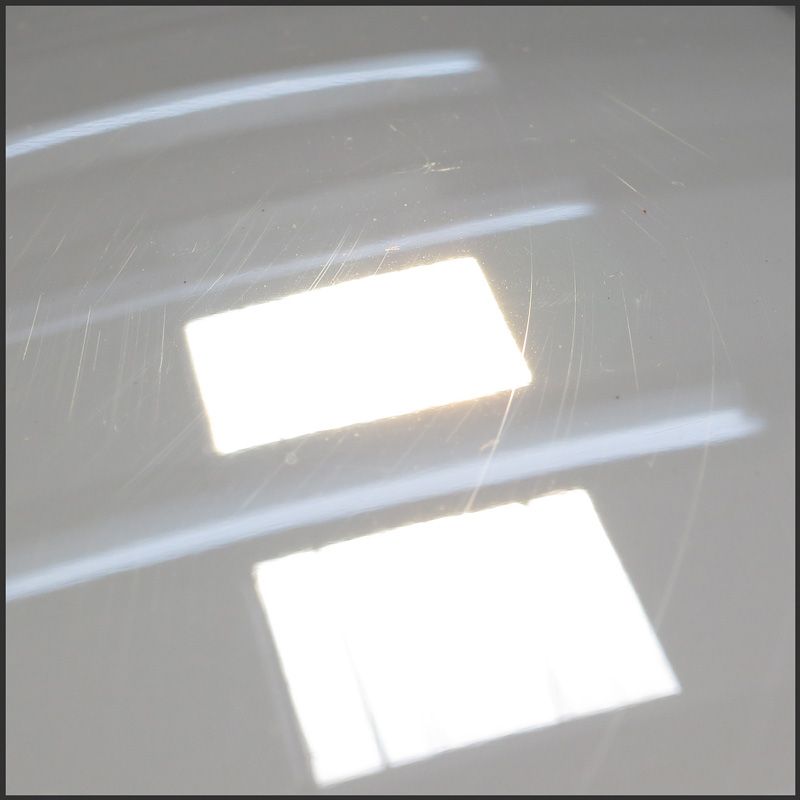

The usual scratches:
Loads of little nicks and scuffs on the majority of panels:

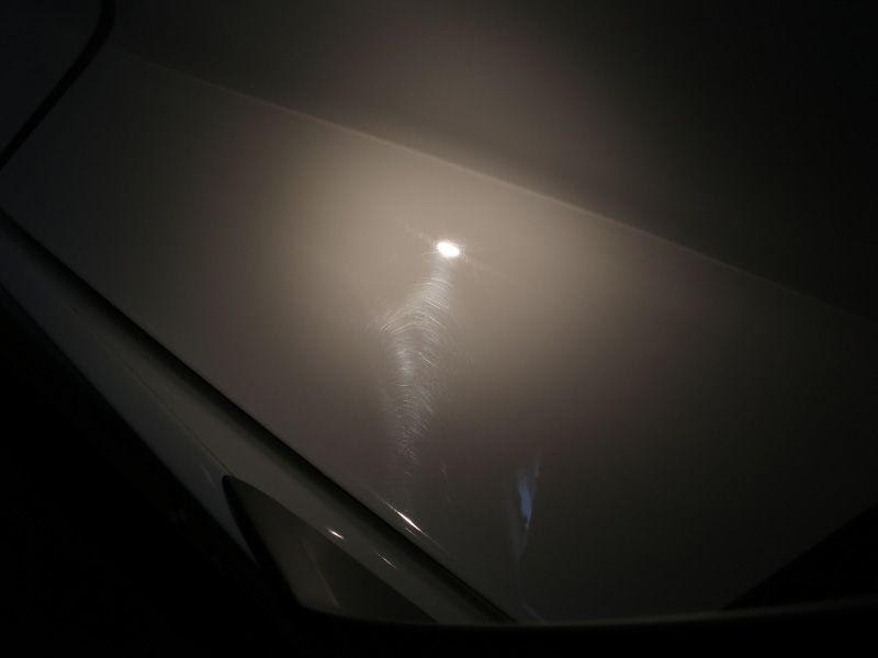

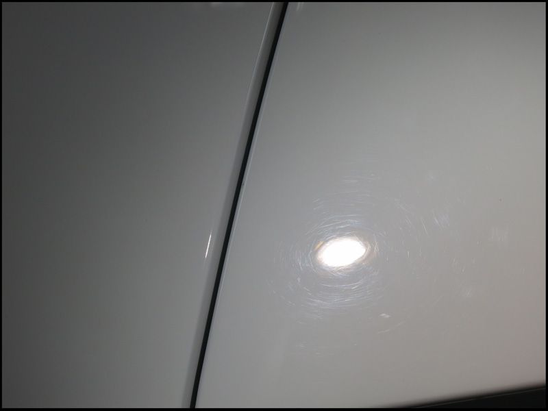

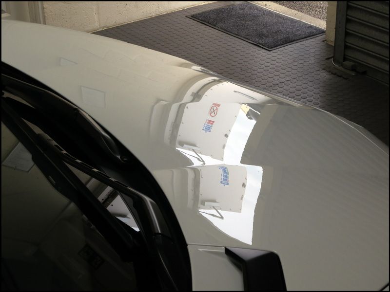

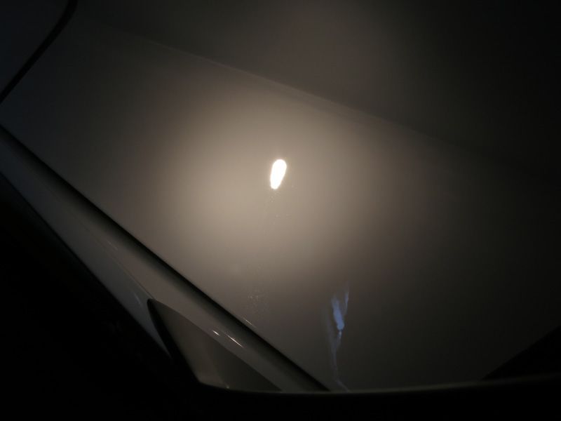

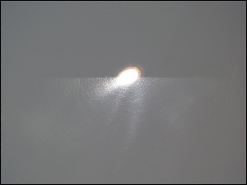

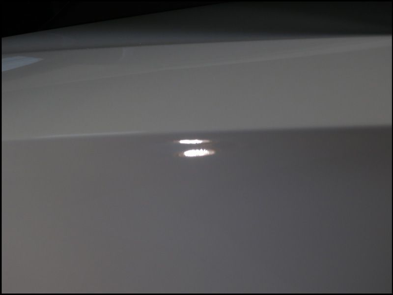

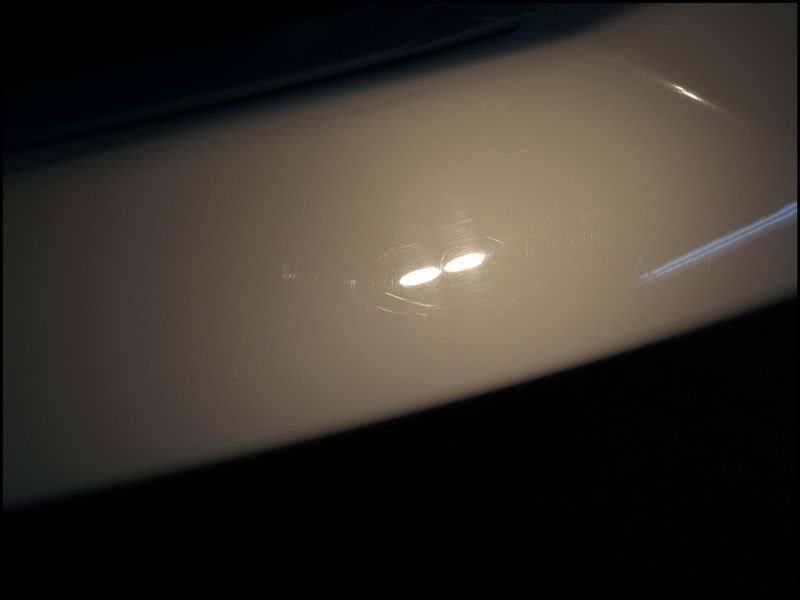

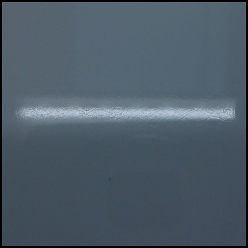

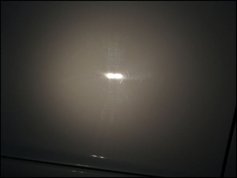

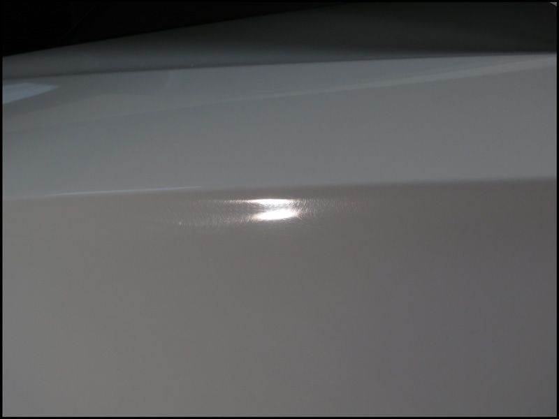

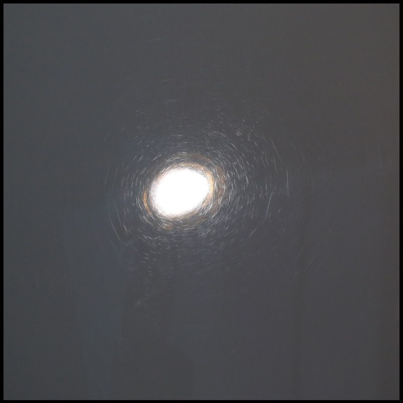

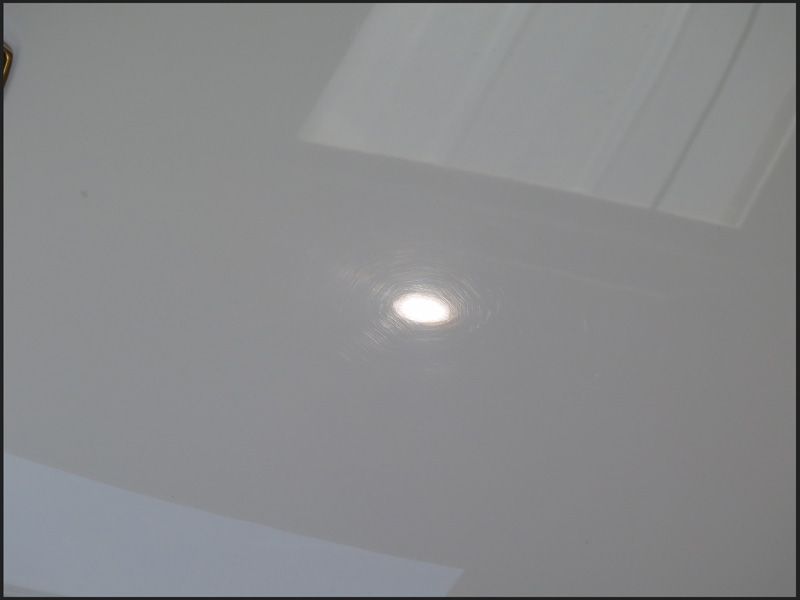

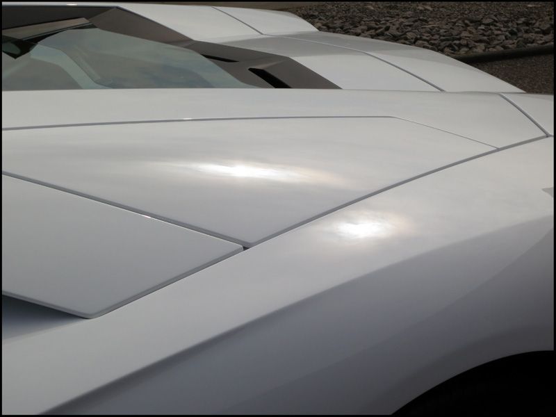

Really deep pig tailing (top right to bottom left):
This was in the middle of the bonnet:
Shocking!!

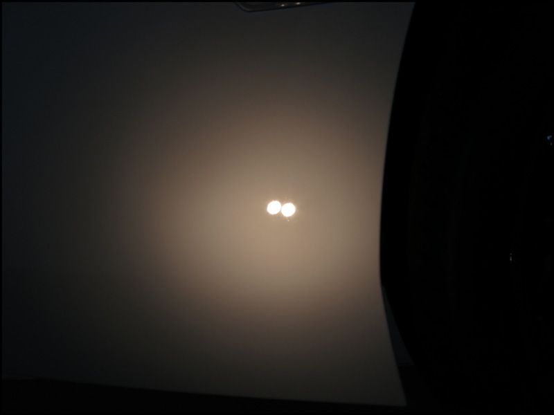

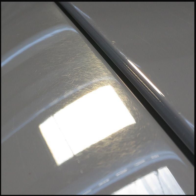

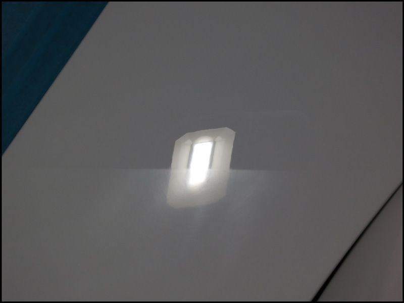

You know its bad when you can quite easily see the sanding haze on a white car!

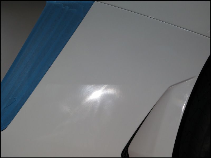

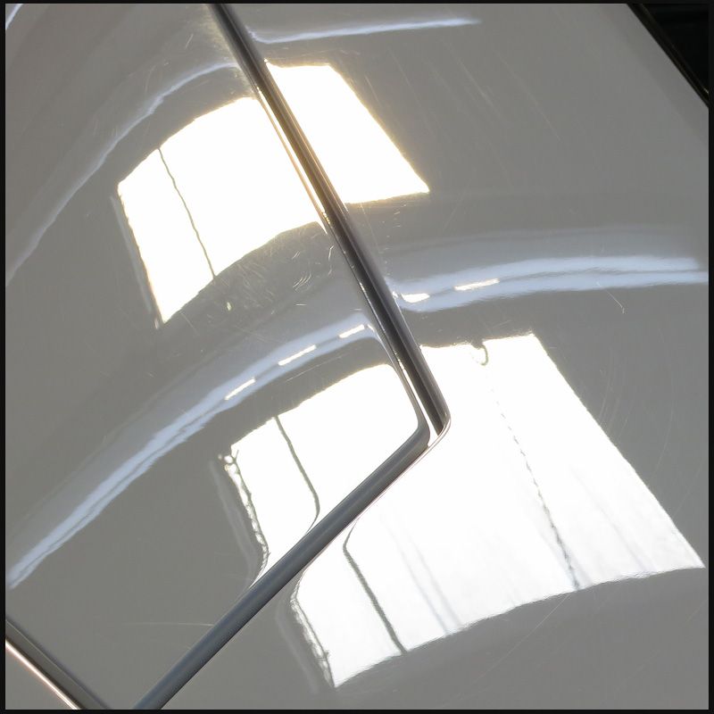

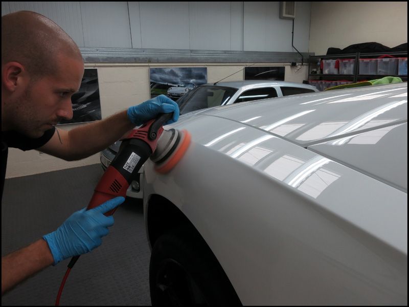

The paint was rock hard so correction was achieved via the Flex VRG 3401 and Microfibre Cutting Discs with Meguiars 105:

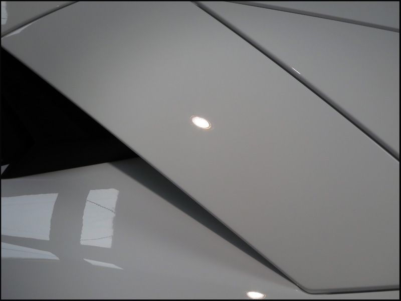

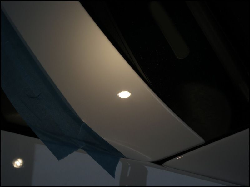

Correction shots, in no specific order:

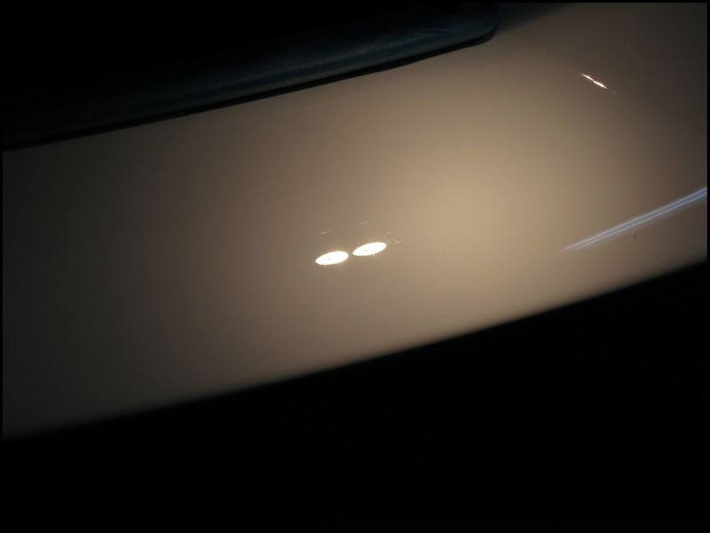

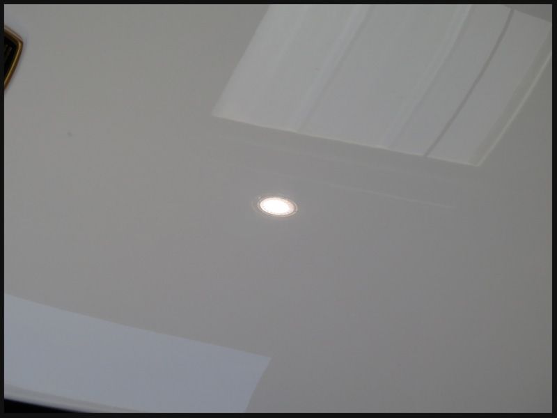

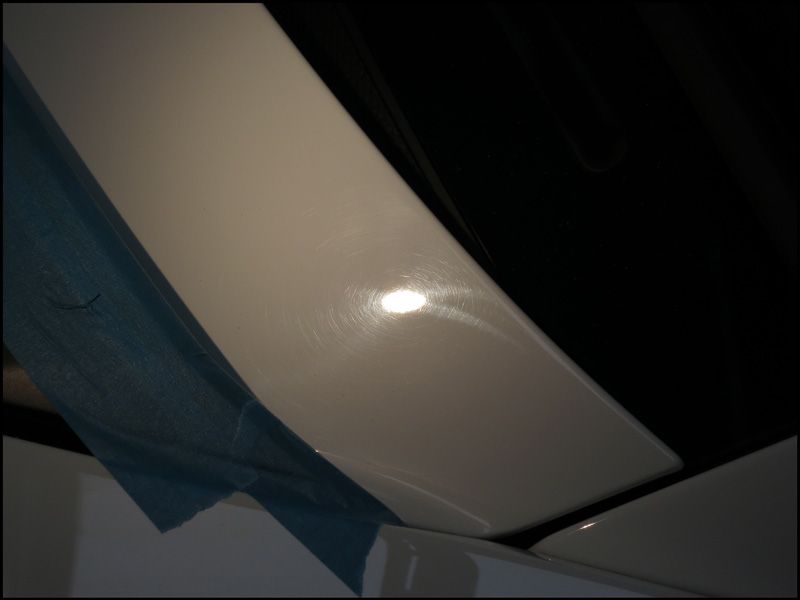

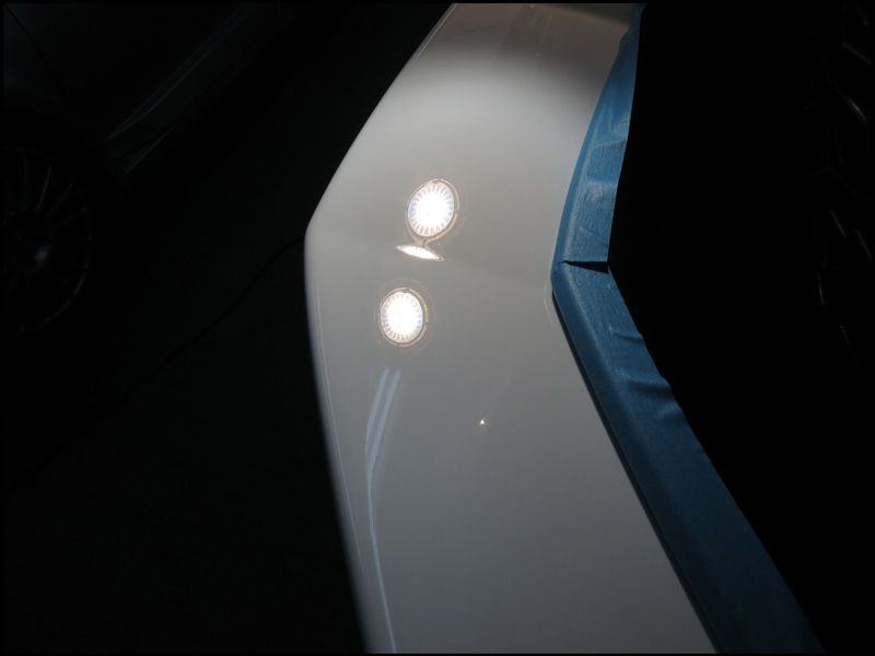

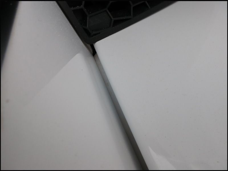

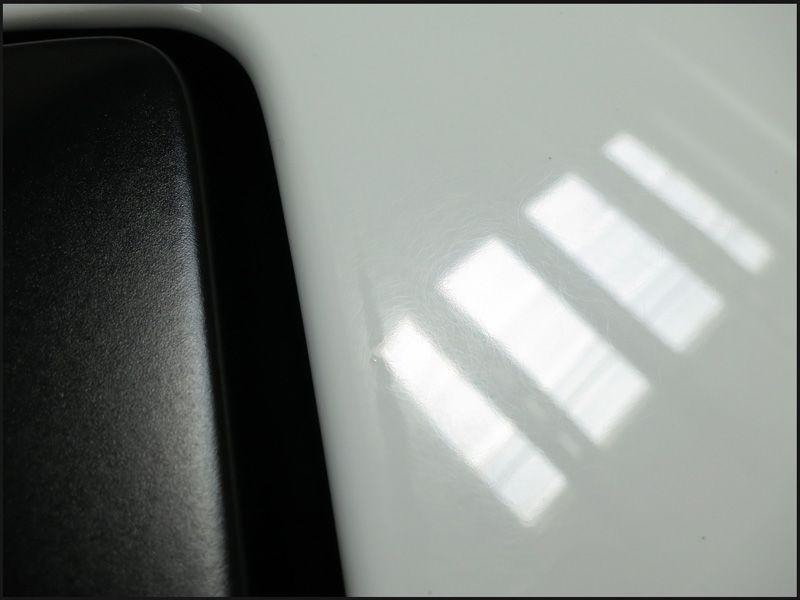

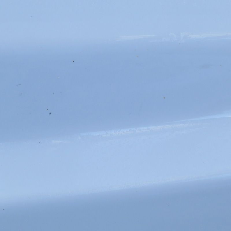

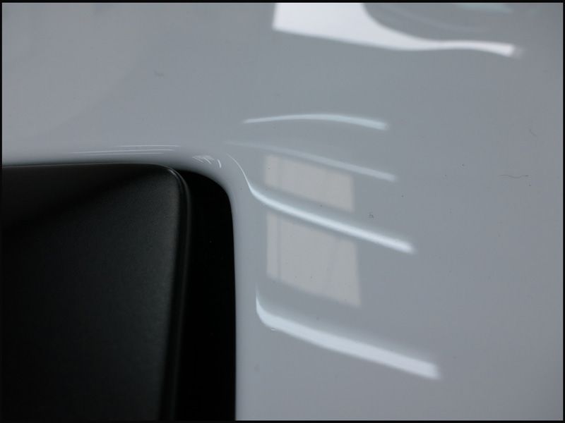

Sanding marks on the edge of the roof:

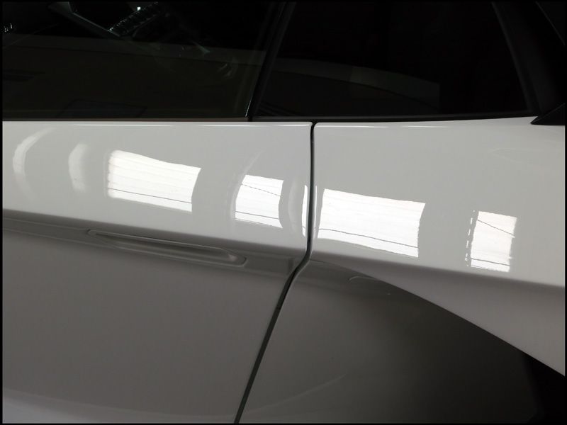

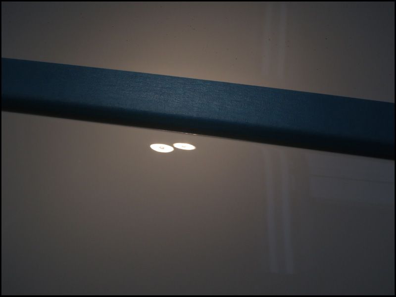

Top of drivers door:

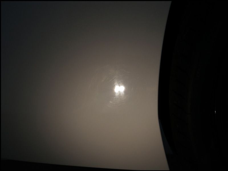

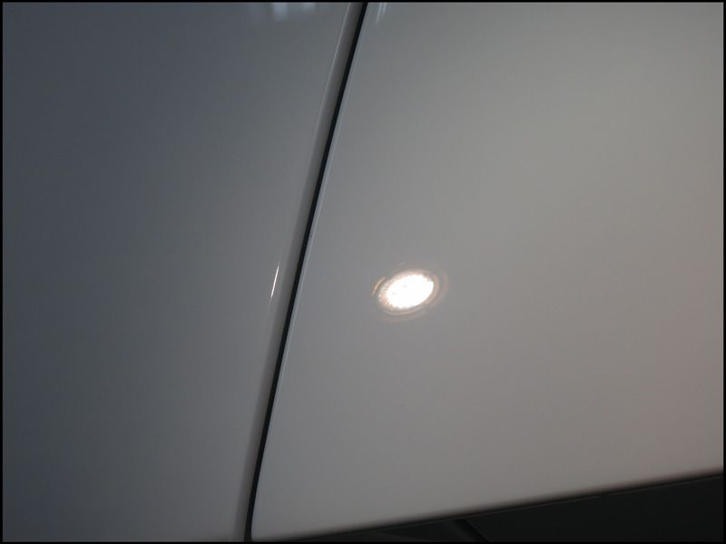

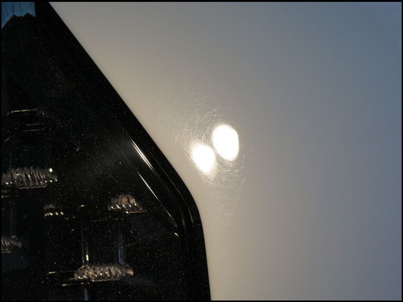

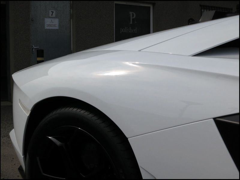

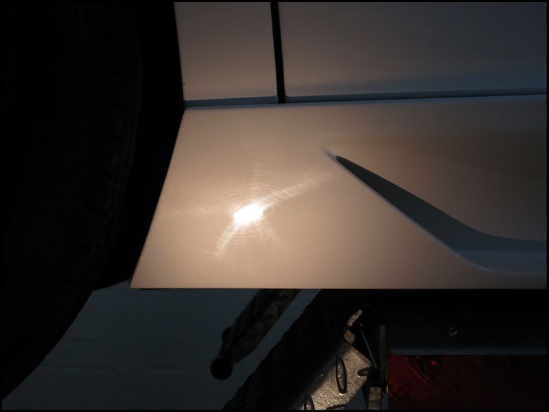

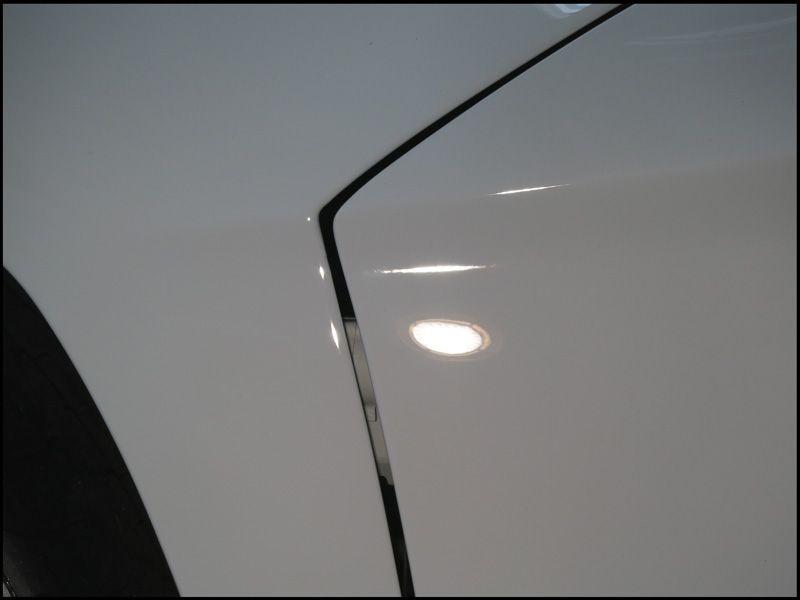

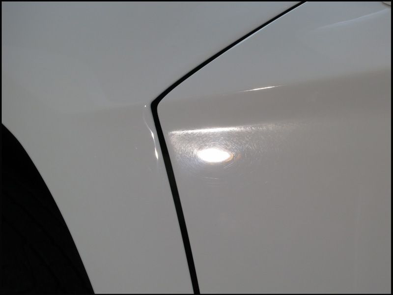

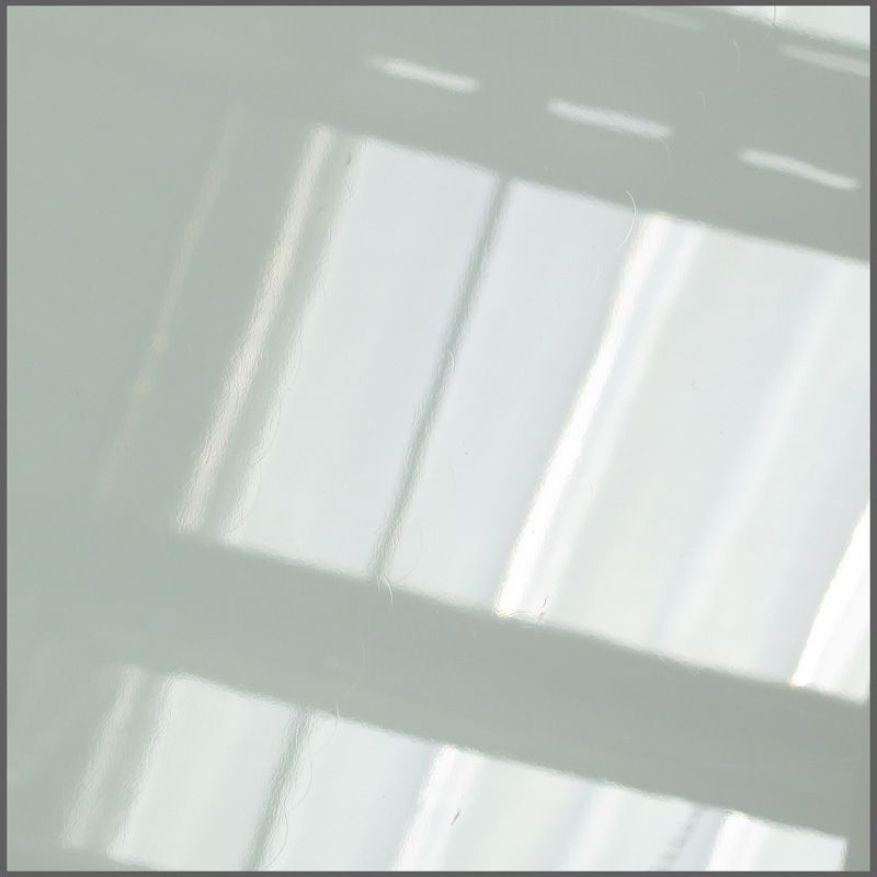

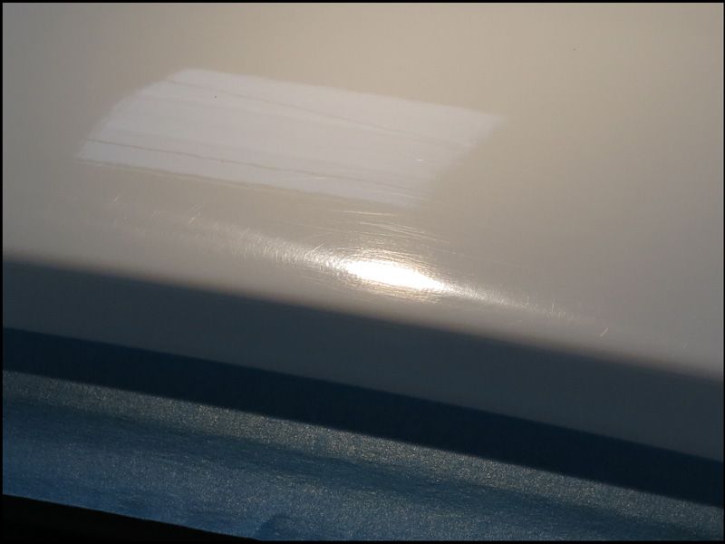

On the corner of the bonnet, pig tailing before and after:

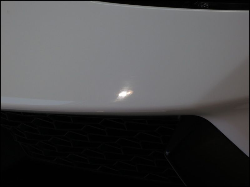

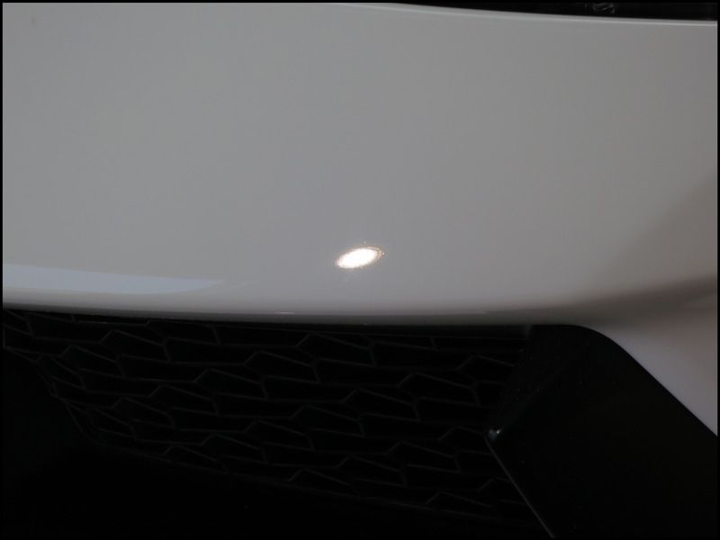

Front bumper:
Some 50/50's:
Top of the rear bumper:
Front bumper again:

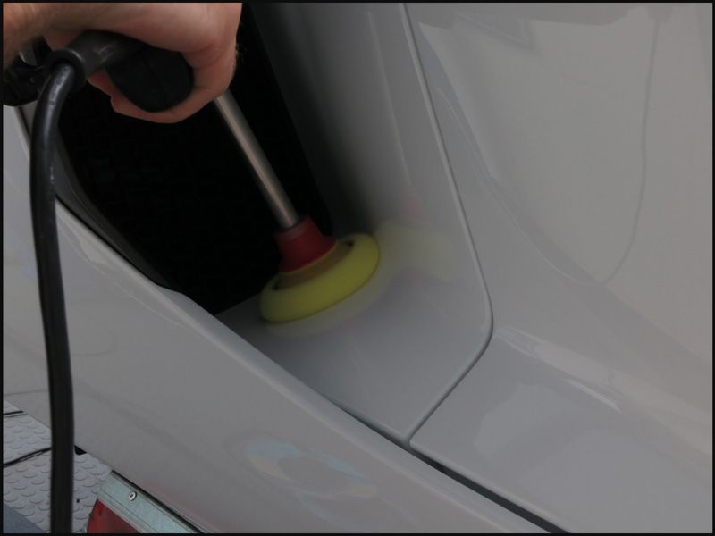

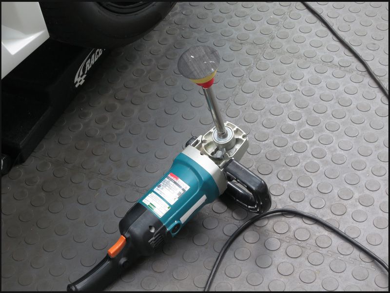

Change of machine for some of the more awkward parts to get to:

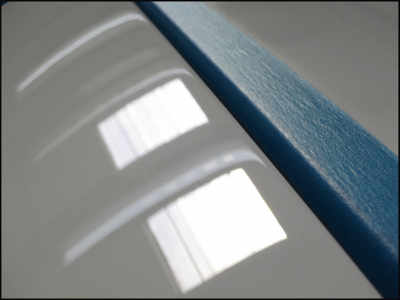

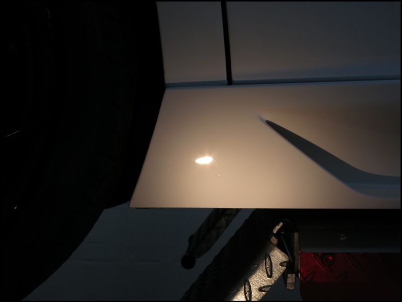

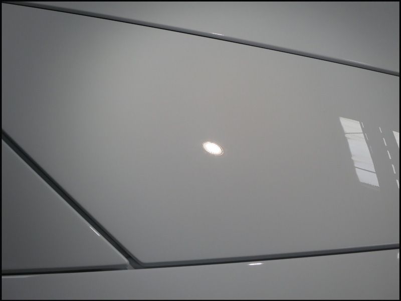

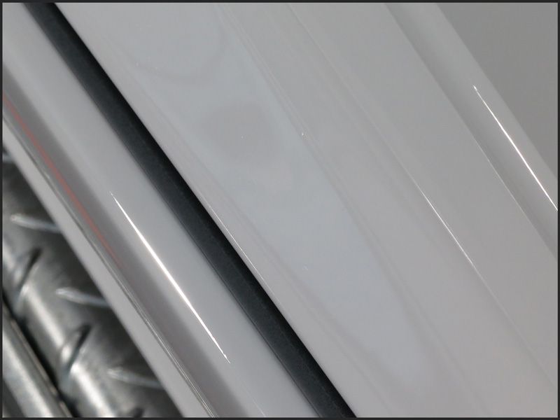

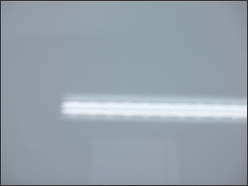

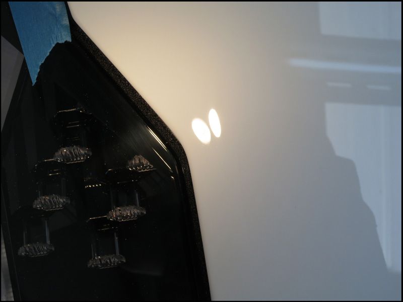

Theses picture give a good indication of the "levelling" effect that microfiber discs can have when used correctly:

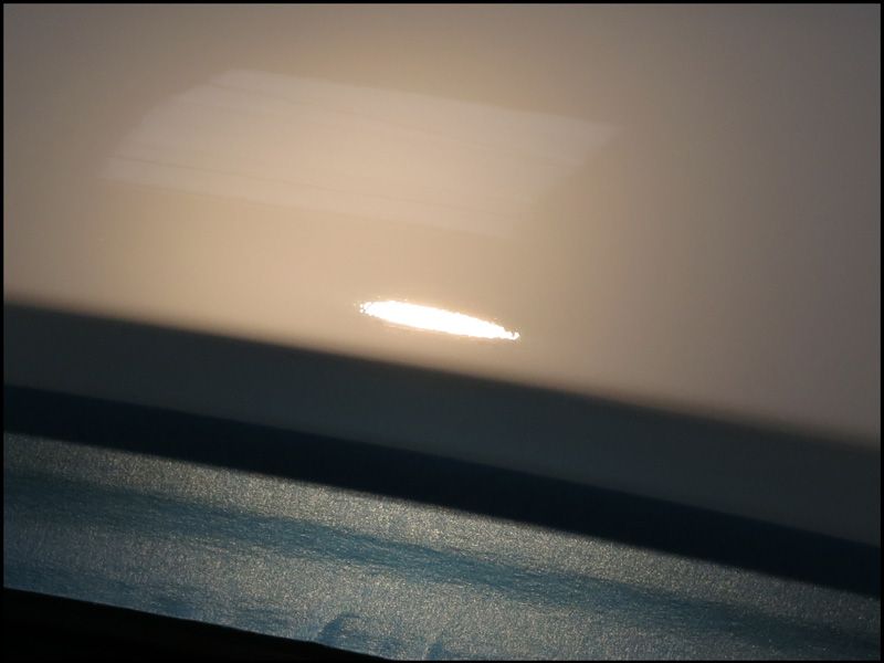

Before polishing:
After the 1st hit with the disc the edges of the pig tails have been rounded off significantly and as a result they don't catch the light in the same way (a further 2 or 3 were needed to completely remove everything):

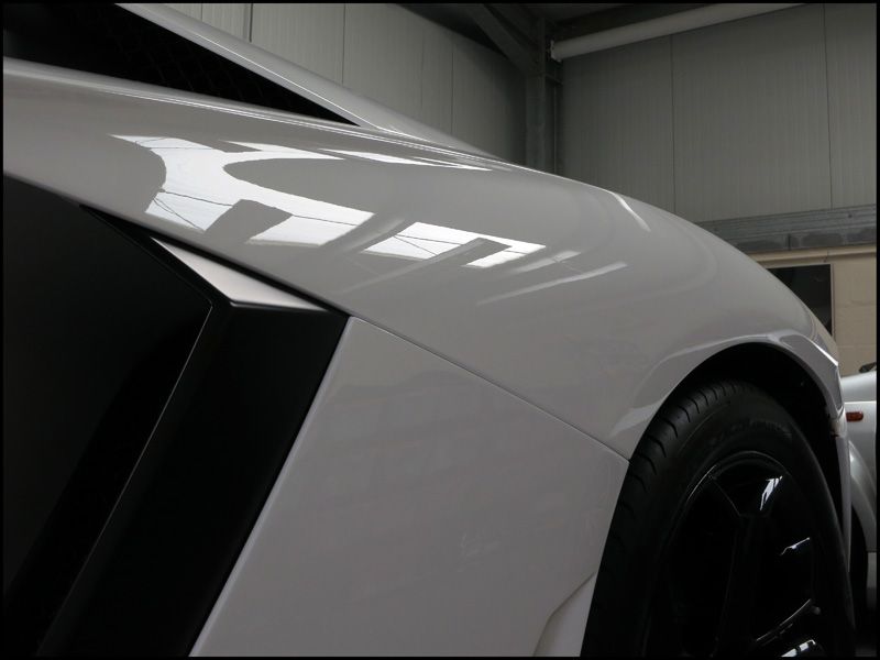

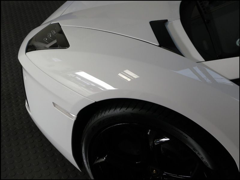

Once the main correction work was done I gave the car a thorough rinse and wash before refining the paintwork with a Lake Country Polishing Pad and Menzerna 106FA:

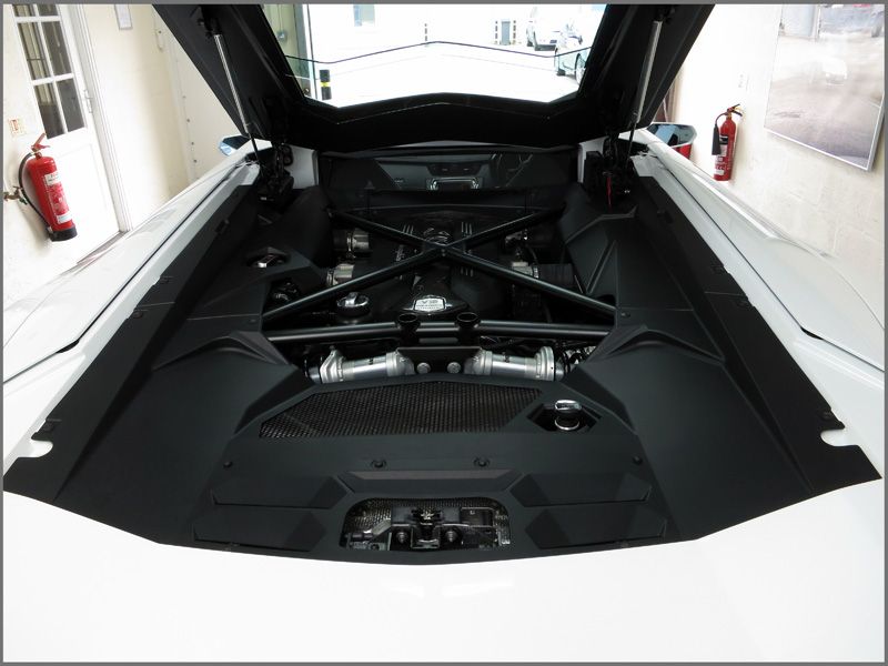

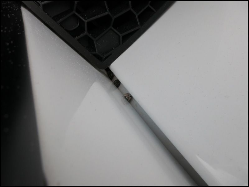

These cars have an annoying habit of collecting small stones in the intakes so these were carefully removed too:

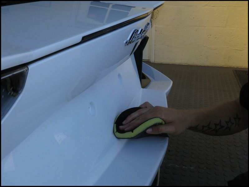

With all the polishing complete, I gave the car a careful going over with a lambswool duster and then applied Auto Finesse Desire:

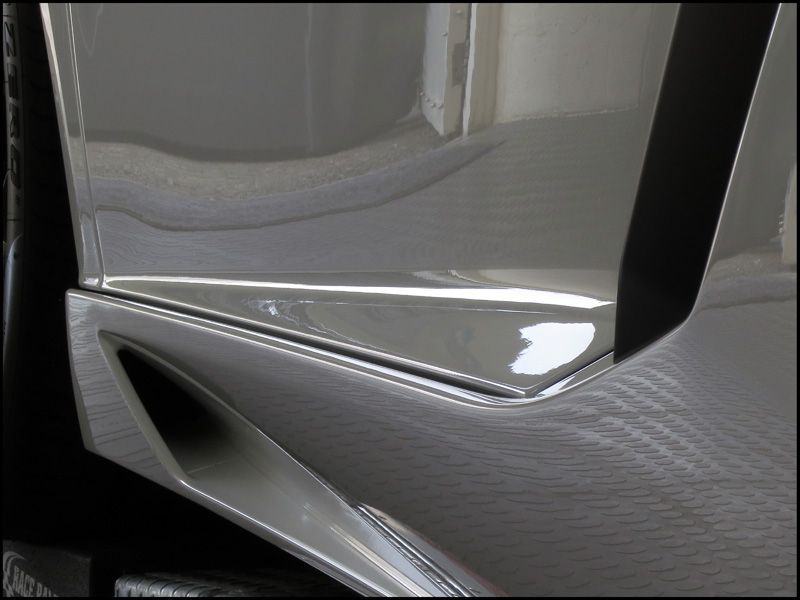

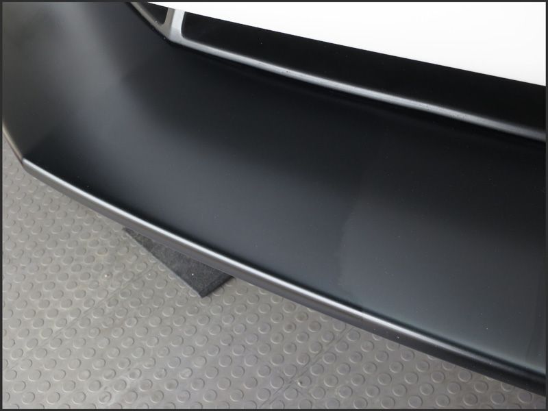

Swissvax Opaque was used on the matt surfaces:
Including the rear diffuser:

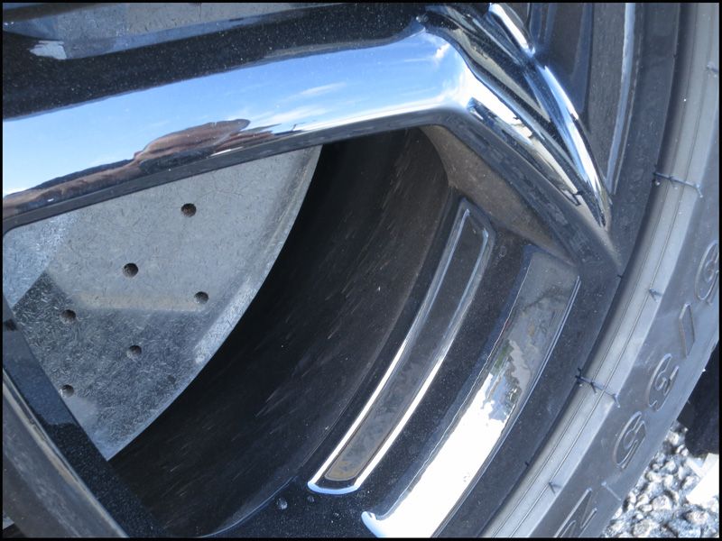

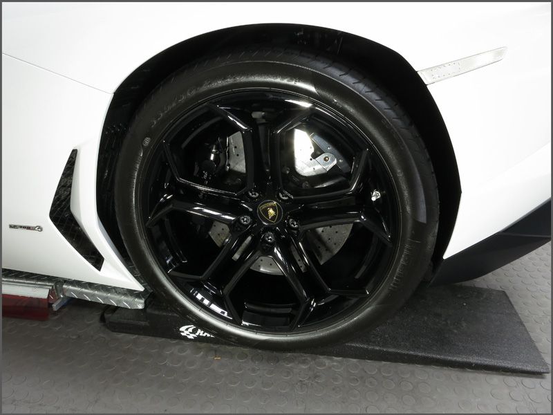

The wheels were lightly machined with Swissvax Cleaner Fluid Professional Finish and protected with Swissvax Autobahn:

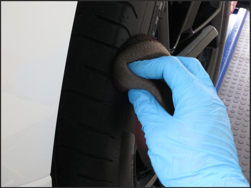

Swissvax Pneu for the tyres:

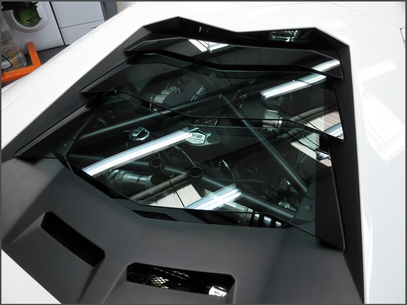

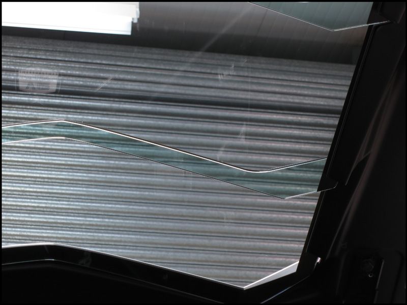

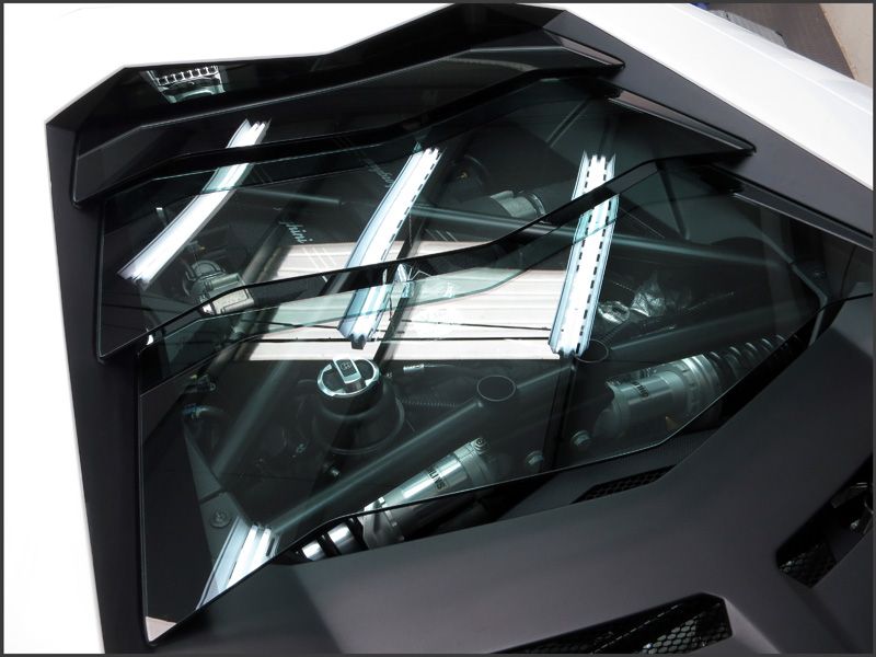

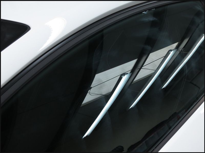

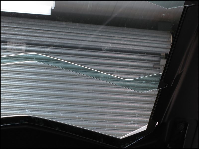

Prime Strong was used to good effect on the glass:
Particularly on the engine cover glass where there were some stubborn water marks:

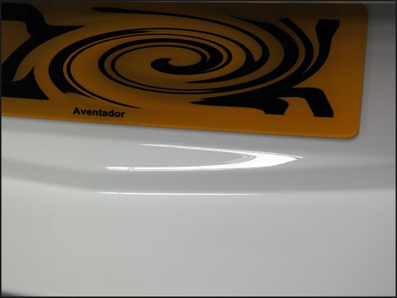

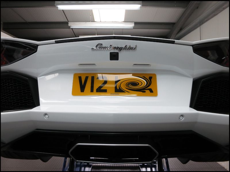

Last job on the list before I was done was to fit some new number plates that we had made up for the Client:

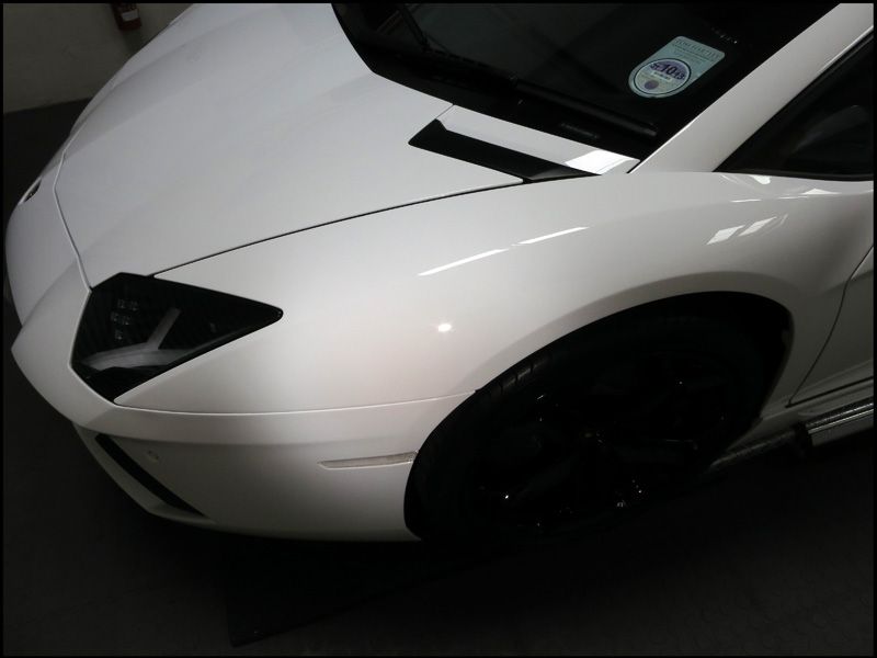

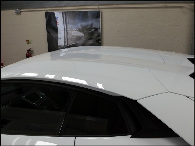

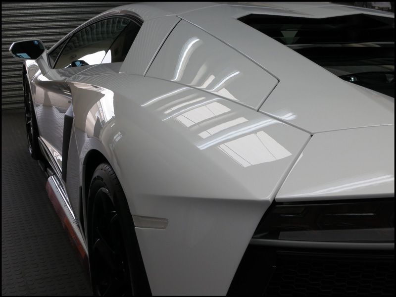

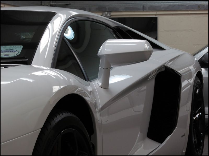

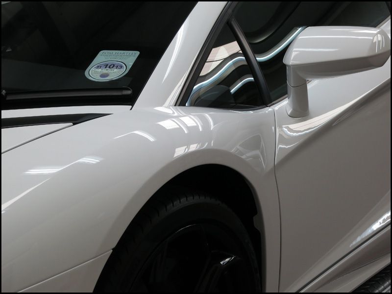

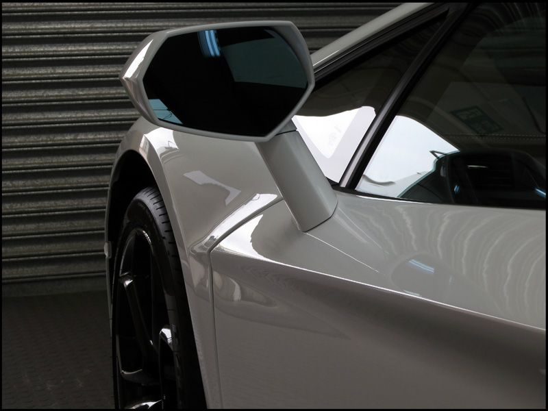

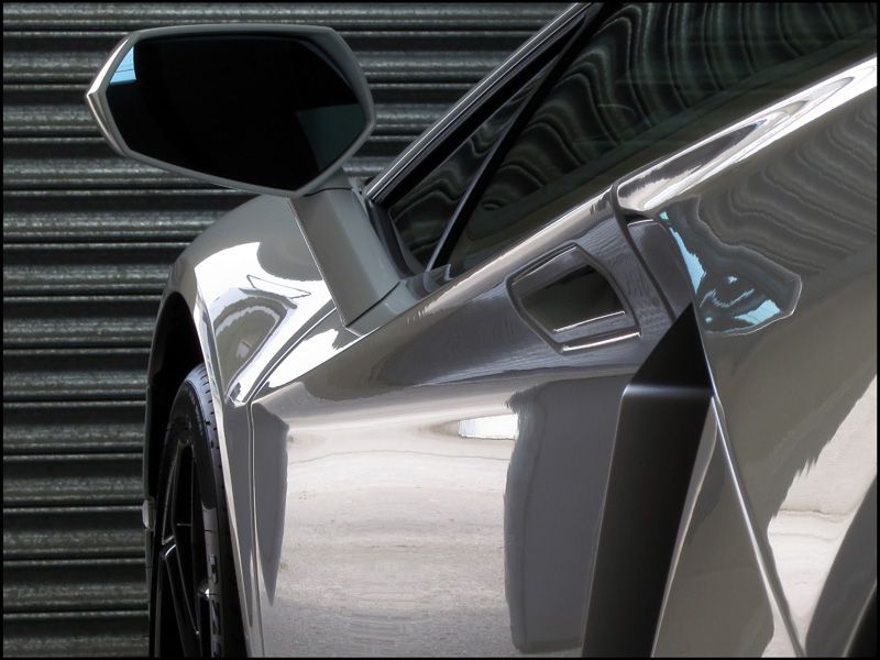

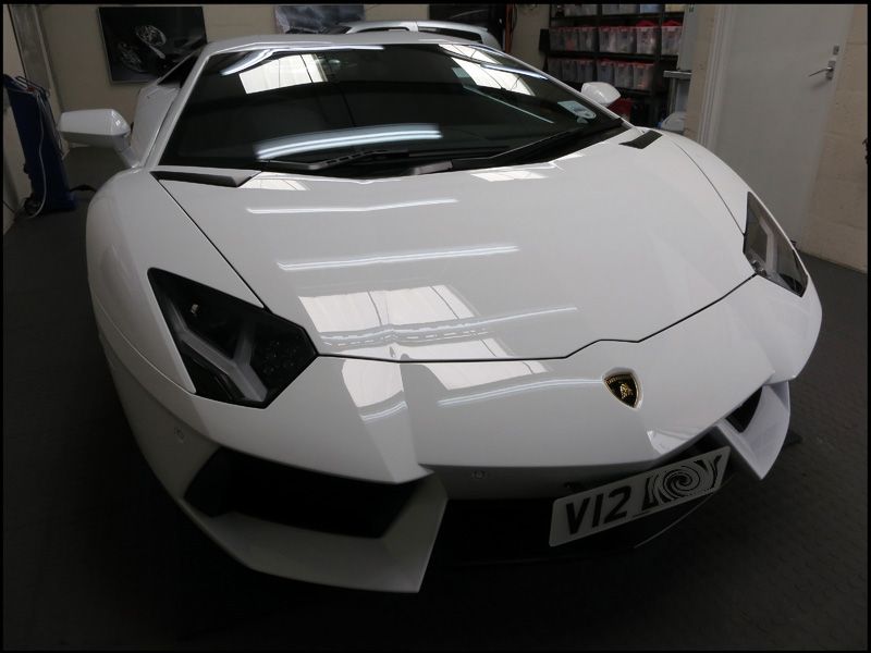

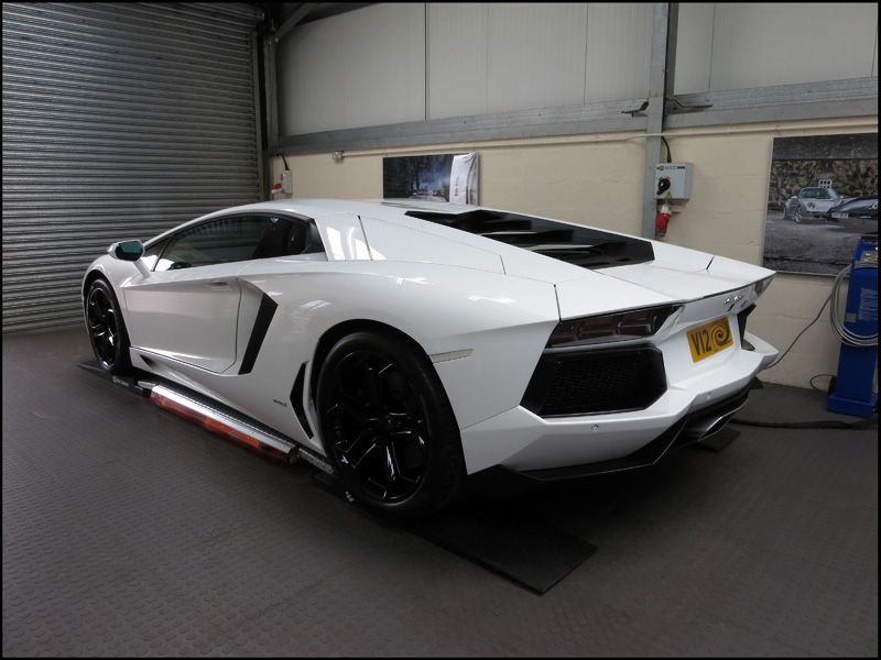

And here's the end result
Thanks for looking
