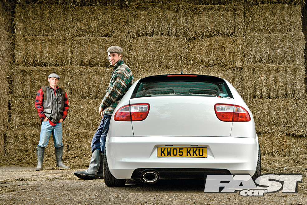

http://4.bp.blogspot.com/-BHdaStxHRBo/T46wEQkaQRI/AAAAAAAATKI/erTfw4eTEpw/s1600/leon1.jpg
There 9.5j on the rear.

mines mk2 so unsure if they would fit, missed out on them anyway... well i say that they didnt sell on egay.
