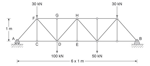

I'm having a bit of brain fade today for some reason I just can get my head around this problem.
I'm looking to resolve the forces in section GH (so, Fgh)
I worked out the reaction force at support A to be 113.3kN ^
Method of joints to give forces AF as 160.2 kN and AC as 113.3kN (think this is all to shit)
Orig structure
I've split the structure like so
any help resolving Force at GH using sections???

What the fuck has got your back up? My post being over zealous showing how technical my work is!?!? This has NOTHING to do with my work! I'm doing an OU degree, and I remembered there were a couple of folk on here doing mech/structural engineering so thought I'd ask for some help.
I have an answer, but I just doesnt feel right. -13.3kN

ok,
so I'll have a bash again...
Taking moments about D
SUM Md = 0
Reaction Force at A = 113.3kN
-(113.3*2m)+(30kN*1m)-(Fgh*1m) = 0
so Fgh = -196.6kN
Na, thats not fucking right

Start from the fixed point and work your way to the roller at the left hand side. start your nodal at the 30kn

I have to do it via sections, not joints (working from fixed point) :S

4th Jun 12 at 21:06   View User's Profile U2U Member Reply With Quote
so I'll have a bash again... Noticed a cock up in the 1st one
SUM Md = 0
-(113.3*2m)+(30kN*1m)-(Fgh*2m) = 0
so Fgh = -98.3kN
So 98.3kN (compression)

had a chat with another guy thats doing the course and he did it the same way.
So.... i'll just go with that :S

i made it 132.2

Can you explain how you got to that?
