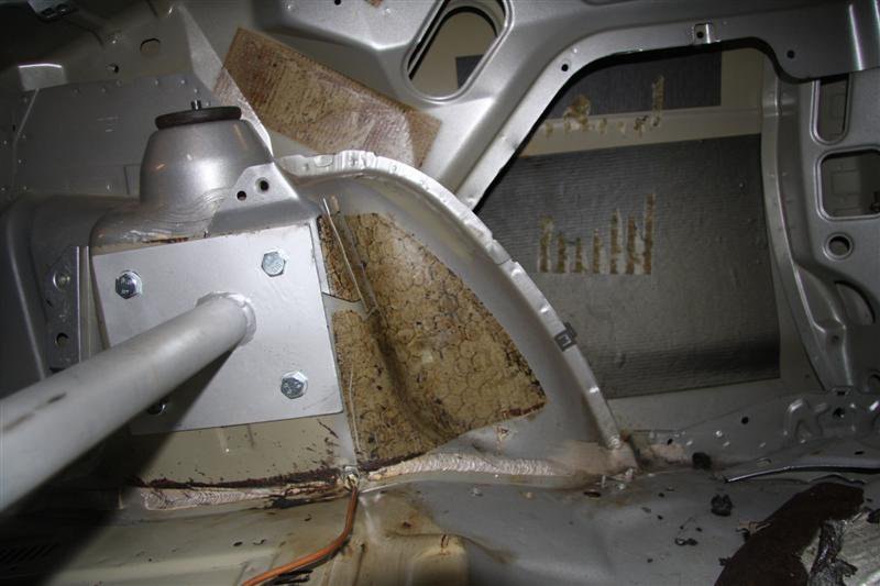

28th Mar 12 at 20:47   View Garage View User's Profile U2U Member Reply With Quote
What's wrong with that harness bar?
28th Mar 12 at 21:27   View Garage View User's Profile U2U Member Reply With Quote
Several things mainly that its not a harness bar its.designed for inwards force from the struts to stop them flexing, the metal on the bracket the bolts go through you could probably bend with your hands, the bolts won't be high tensile and relatively thin, no spreader plates behind the bolts, and the high lateral force that will be on that bar in a crash something like 400kgs per person from memory its just going to rip straight off
[Edited on 28-03-2012 by Steve]

28th Mar 12 at 21:34   View Garage View User's Profile U2U Member Reply With Quote
Standard bolts tend to be rated at 8.8. I think they'll be ok.
28th Mar 12 at 21:38   View Garage View User's Profile U2U Member Reply With Quote
No way they are only m8 or m6 way too thin, If they are like mine they will only be self tapper bolts also. Even if there is a nut behind its just going to rip straight through the metal bracket on the bar or the metal sheet of the car. Totally unsuitable and not fit for purpose, go find YouTube vids of people towing there cars on strut braces and see how easy they tear off, not designed for that load type or force
28th Mar 12 at 21:39   View Garage View User's Profile U2U Member Reply With Quote
Harness bar needs to be welded as part of a cage or welded securely to the strut housing
28th Mar 12 at 23:04   View Garage View User's Profile U2U Member Reply With Quote
Does mine get your approval
28th Mar 12 at 23:38   View Garage View User's Profile U2U Member Reply With Quote
Better far more metal there and fixings id be inclined to weld it though imo just incase but its your car to make how you like lol. On the subject of fastnings the OEM seat belt bolts are made of different material similar to impact sockets I think they actually stretch on impact rather then shatter like the normal silver ones

28th Mar 12 at 23:52   View Garage View User's Profile U2U Member Reply With Quote
They're either M10 or M12 8.8s, spread in the arch.
29th Mar 12 at 00:01   View Garage View User's Profile U2U Member Reply With Quote
Consider this, say you experience 7 g in a crash which is perfectly possibly with a deceleration from 60mph in about half a second. That means a human body with a mass of 55kgs will place a load on that bar of about 360kgs roughly. Now that's a light person someone like Barnes and you may have to double it. Anyway let's say you have a passengar of similar ilk your looking at a total load of around 720kgs which is about 3 engines with ancillarys. Now would you hang 3 puma engines off that bar I posted and stand underneath relying on that thin metal and rubbish bolts ? Also bearing in mind that's a calc done based on lowish speeds and light people and a fairly long relative deceleration speed, you could realistically be looking at 4 engines worth of weight on that bar
[Edited on 29-03-2012 by Steve]
29th Mar 12 at 00:07   View Garage View User's Profile U2U Member Reply With Quote
With regards to yours Ian it sounds a hell of a lot better then what I posted especially if its spread at the back
29th Mar 12 at 00:11   View Garage View User's Profile U2U Member Reply With Quote
Comparable to the OE mount point then.
When I scrap that shell I might do a deformation test with some machinery.
29th Mar 12 at 00:18   View Garage View User's Profile U2U Member Reply With Quote
Be interesting to see, video it if its shocking would be worth using it to show these people relying on a couple of self tapping bolts holding there harnesses in lol
29th Mar 12 at 00:26   View Garage View User's Profile U2U Member Reply With Quote
In fact, could mock up a few different ones on a few different shells and push the car in to something using the bar.
