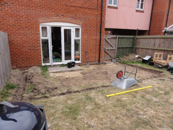

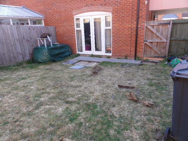

So the great patio project begins...
Never done it before, gotta learn some way, so gonna give it a go.
Heres the starting point
Set out a little while ago, and have dug out a perimeter to give me something to work to. The garden is on a slight uphill gradient, so its going to need a fair amount of digging at the edge.
Heres the perimeter. It will be 5.4m x 3.16m.
Im planning on using some new sleepers to give a step up from the patio to the rest of the garden.
Perimeter

25th May 11 at 09:00   View Garage View User's Profile U2U Member Reply With Quote
Disaster one has already struck!
Bloody paving supplier told me the packs i have had a laying pattern that makes 1.8m x 3.15m.
When infact, they are 1.98m x 2.75m
So the boundary i dug to long and not wide enough. Not to much of an issue, but just means more excavation to the sides, and ill have to fill in the bit thats to long.
Just sat waiting fo a skip to arrive now. Itching to get on!

27th May 11 at 18:57   View Garage View User's Profile U2U Member Reply With Quote
Fuck me it's hard working digging out. I have about a meter by 2 meters left to dig out. It's over a foot down at the garden end. I've just about filled a 2yard skip. Pics to follow
