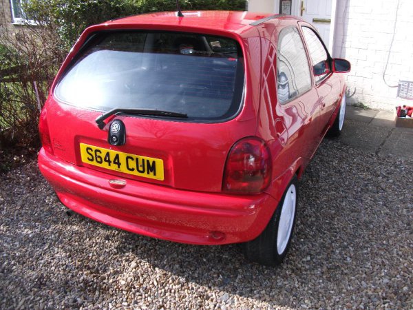

Mine were sprayed on the exterior side, the whole light turn't out real shiny

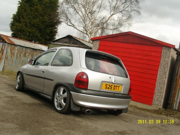

Yea it's easy dude!
Just mask off the reflector and keep giving it so many coats untill your happy with them,don't do to many layers though because your indicator still needs to flash orange
