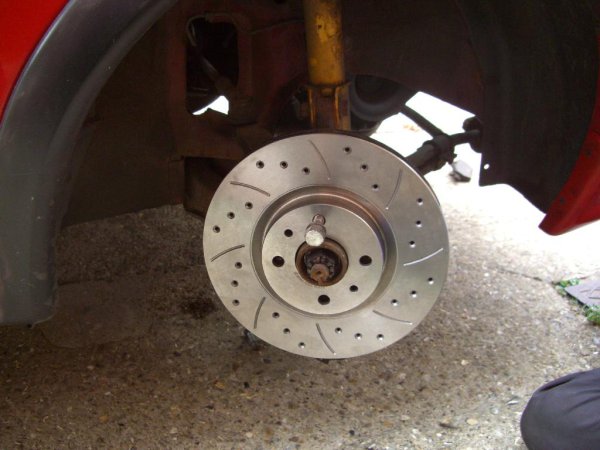

is it true that fiat coupe turbo brakes fit a corsa b? is it a straight fit or do you have to by adaptor plates?
28th Feb 11 at 20:26   View Garage View User's Profile U2U Member Reply With Quote
the discs are used when fitting vauxhall v6 calipers
doubt the fiat calipers will fit straight on though
.Matt
Registered: 28th Jan 09
28th Feb 11 at 23:17   View User's Profile U2U Member Reply With Quote
Ones i purchased like so are for 4Stud 1.8T; using the V6 calipers.
[Edited on 28-02-2011 by .Matt]
JaffaTB
Registered: 7th Oct 09
1st Mar 11 at 10:19   View User's Profile U2U Member Reply With Quote
get meriva disks, already 4 stud and arent as thin as the fiat ones iirc
1st Mar 11 at 11:20   View Garage View User's Profile U2U Member Reply With Quote
im using meriva ones
just make sure you dont wear the pads down too far because the discs are 280mm instead of 284mm
JaffaTB
1st Mar 11 at 11:28   View User's Profile U2U Member Reply With Quote
me too, but i dont think if they wear down it will cause problems cos on the proper sized disk the pads wear a lip on the outside anyway (i.e. they dont touch the very edge bit)
