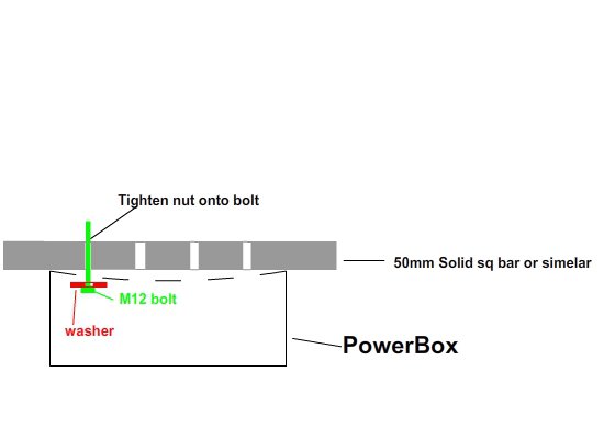

Gary
Registered: 22nd Nov 06
16th Feb 11 at 16:48   View Garage View User's Profile U2U Member Reply With Quote
Easy fix.
If you do something like that and tighten the nuts up on all 4 holes at the same time it should pull it straight.
May need to put a spacer at each end of the box where the bar would sit on to pull it past straight and spring back to how you want it.
alan-g-w
Registered: 9th Nov 07
16th Feb 11 at 18:18   View User's Profile U2U Member Reply With Quote
That might only work if you put a spacer under each end and actually pull it out a tad too far Gary, I reckon that just pulling it up against that bar flat to the box wouldn't be enough.
I'd be cutting the buckled side off and just replacing it with a bit of 4 or 5mm plate.
