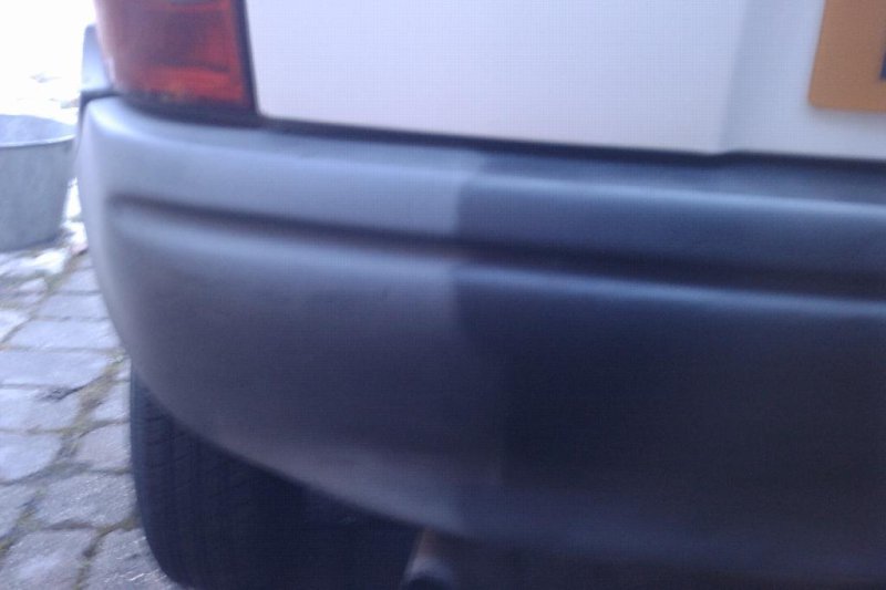

Pow's top tip for the day, heatgun on a bumper really does work!

I couldn't belive it, got a £10 heatgun from screwfix and it's really bought the colour back to the bumpers. It's a little patchy but a little bumper gel should hide that nicely.

£10 TITAN heatgun from screwfix - I really bought this to do the KA as that has all black bumpers and really suffered from bumper fade but I thought I'd risk melting bumpers on this first!
I washed the bumpers when i washed the car and also gave them a quick wipe with some panel prep wipes to remove any shit left on them. Produced the above result which I am VERY pleased with!

I dried the rear bumper and arches off with a towel as I wanted to see how good/bad the heatgun had done in the light!

28th Dec 10 at 14:53   View User's Profile U2U Member Reply With Quote
Thats done a great job! I'm off to get one tomorrow

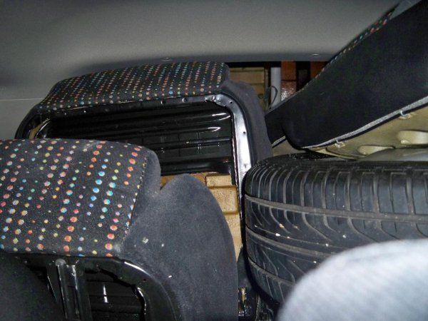

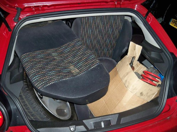

Trip to reading for a little cash returned this little lot!
Full sport interior
4 Sport Alloys with tyres
Bilstien shocks and springs.
FUCK KNOWS how I got that all in the worlds most impractical hatchback

Looks proper wedged in the Alfa there mate

I'm impressed that all fitted in the Mito

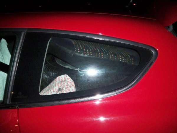

I'm shocked it all went in as well

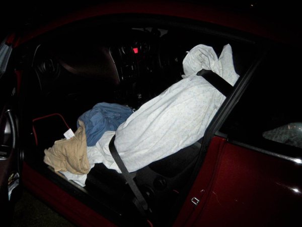

2nd Jan 11 at 11:20   View User's Profile U2U Member Reply With Quote
looks like you've got a dead body in the pasenger seat
Mark.W
2nd Jan 11 at 12:37   View User's Profile U2U Member Reply With Quote
I was going to say the same thing
