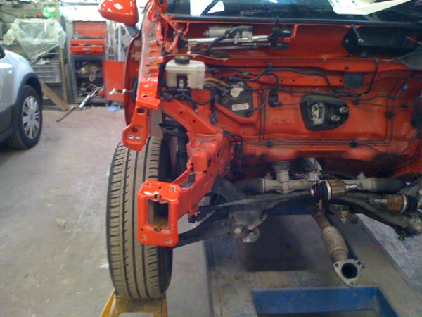

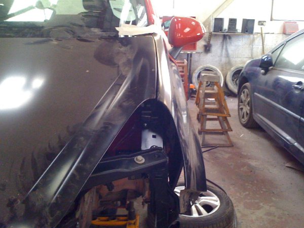

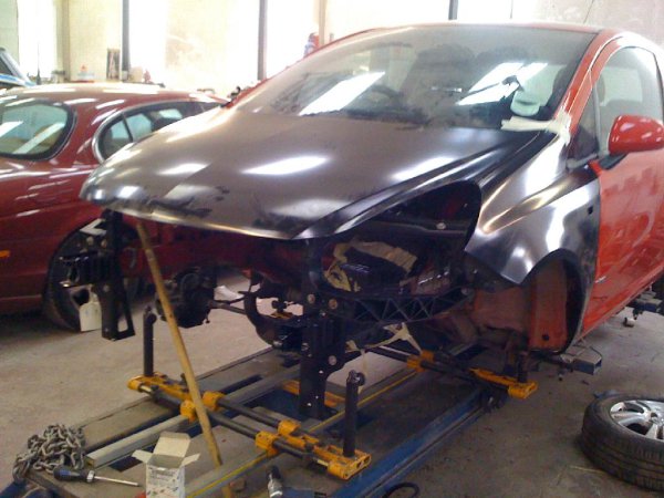

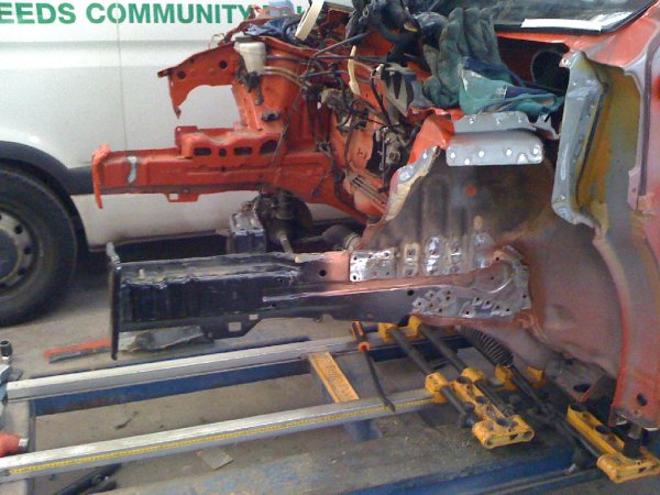

Thought id bung a few pics up of a ""little" job ive been doing at work recently. Its a friend of the managers, bought as a write off to repair and go back on the road. Its a 08 plate Corsa Breeze.
How the car turned up for me:
As you can see, both chassis legs are bent to fuck

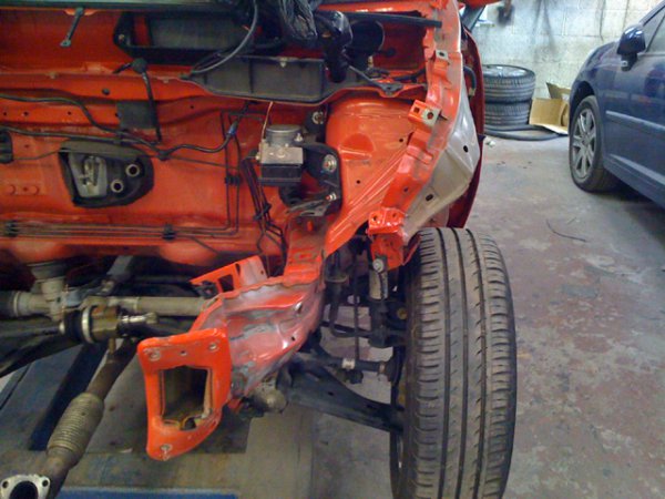

Also you can see the passenger inner wing is fuubarred

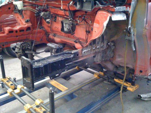

Drivers side leg, bent to fuck, but saveable

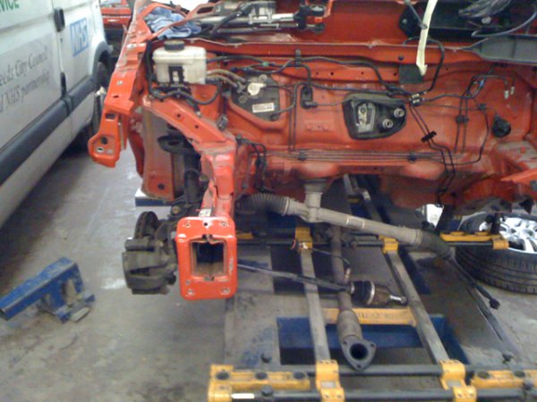

Passenger leg, too far gone to save.

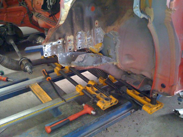

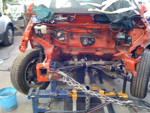

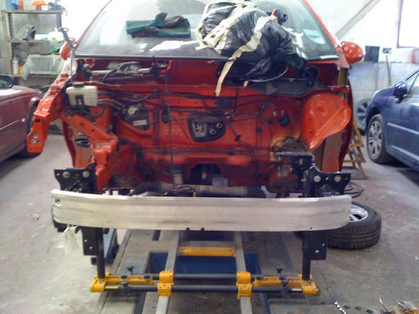

So i pulled drivers leg over, with help of a brace to tweak the front of it that little more
All straight

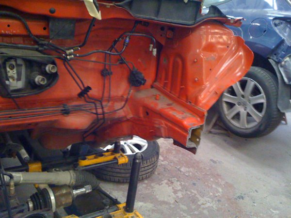

Passenger leg again

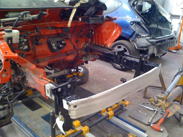

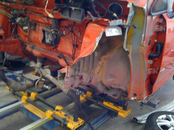

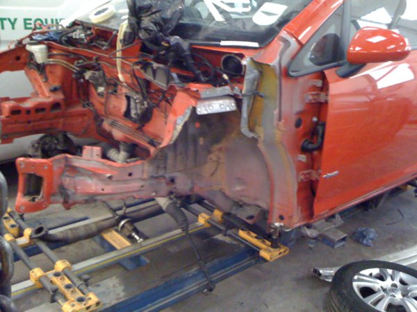

As you can see ive now removed the inner wing, i have also had to strip a lot more off the car to do the next process, subframe, passenger suspension, brake pipes and ABS unit.

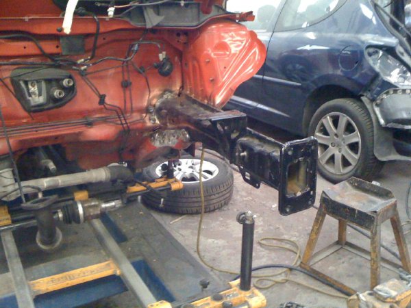

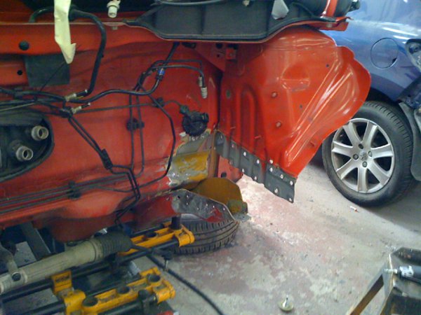

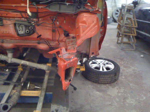

Now time to cut off the passenger chassis leg
Cut off the end:
Inside view

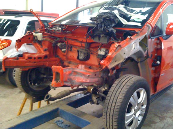

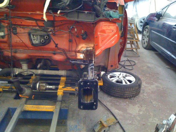

Then remove it all back to the bulk head - NOT easy:
Outside view
Thats as far as i have got so far, ill get more pics along the way
Any questions ill try get them answered

Yeah Graeme, nice to have engine out, wouldnt have been able to do it other wise. Supprisingly i only used 2 spot weld bits for the leg and the inner wing

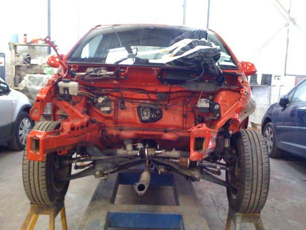

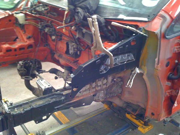

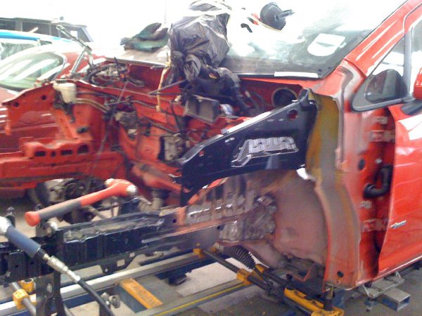

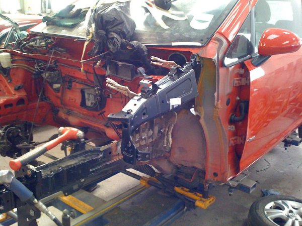

UPDATE:
Chassis leg put into place freely
Welded in
Front beam tried on, perfect fit after some minor adjustment
Trial fit inner wing
Screwed on tempory
Trial fit outer section

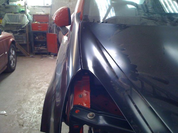

Bonnet and wings tried on
Gaps somewhat near (bear in mind the wings and bonnet are non-genuine also)
Thats all from me folks, sealed it all up now, ill stick subframe and suspension on tommorow, then they are collecting it and finishing the rest.
