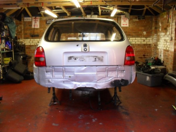

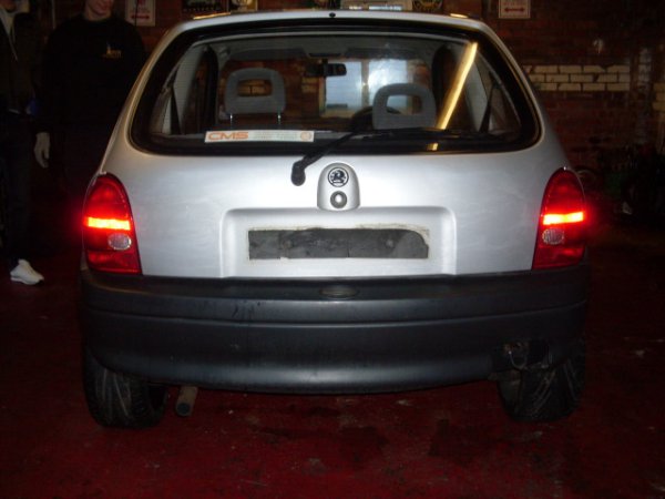

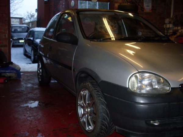

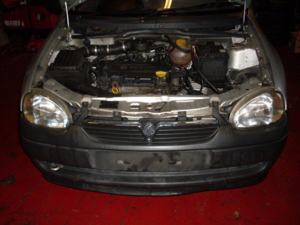

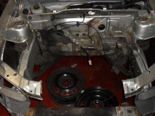

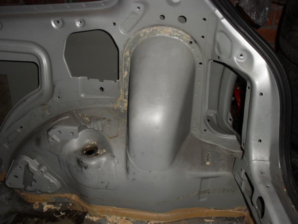

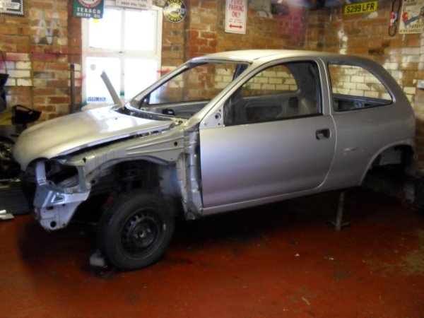

I have got a V reg 1.0 envoy in star silver
I picked it up cheap last year on the 21/12/2009
it had a popped head gasket so only payed £200
with only 56 thow on it and a full mot and a full tank good times
its going to be my new shell to fit my c20let

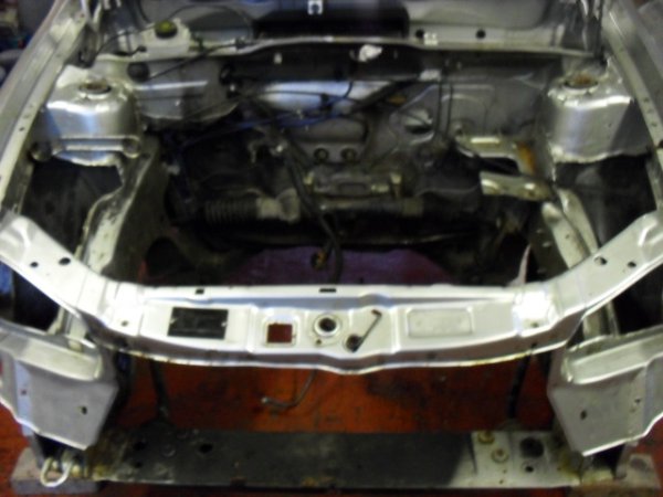

then stripped it all down then started cutting taking out the
slam panel
boot floor
filler neck
and removing sound dedning
[Edited on 22-08-2010 by GregGsi]

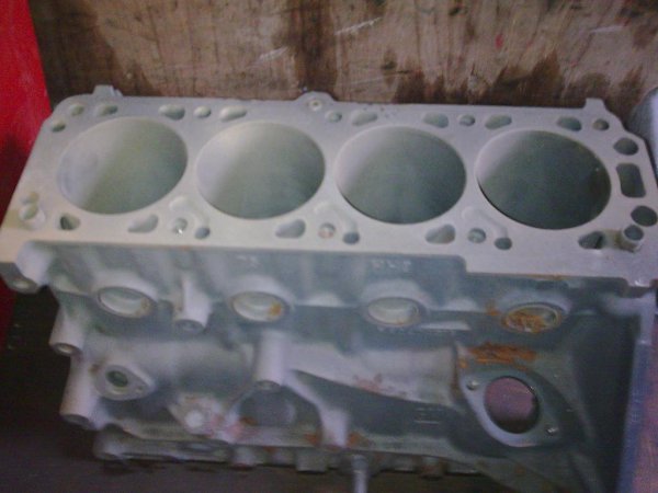

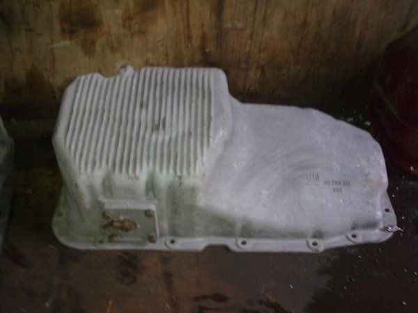

well then i moved on to rebillding my c20let that i got off daz1985
then pulled it to bits
then when it was all stripped down i took the block and sump to be acid dipped
