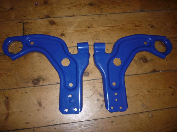

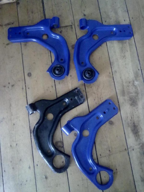

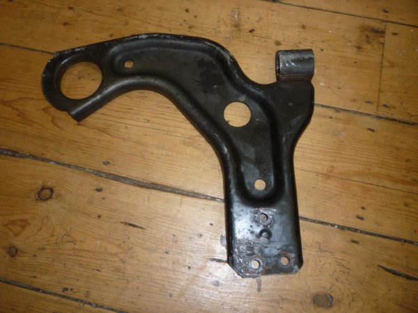

How to tell a Genuine lower arm from a pattern part:
Just a bit of info that anyone wishing to buy genuine 2nd hand ford items can look for so they arent tripped up buying a pattern part, which can look remarkably similar but when it comes to putting new bushes in the holes are slightly off size making them useless
Fake vs Genuine
Fake is on the left genuine on the right, look how similar they look, so similar i went to the extent of having the fake one powdercoated later found when offering a bush up to it its useless.
Differences
A real one has a marking stamped onto it L for left and R for right
A real one will have a hole drilled all the way through in th middle of the rivet holes
Real
Fake
If you think the fake one looks real enough to use then heres a bush mounted in the fake one
Looks ok doesnt it? until you realise I actually pushed that in there with my fingers and can push it back out with my fingers
Here is one of the aforementioned "dimple" type genuine lower arms
Again has the uneven end to it
And Ford stampings on the back
