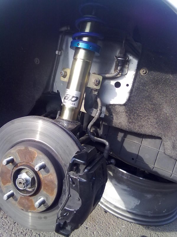

is it possible to get shorter brake hose lines, that go into the calipers, my standard ones are quite squashed up and bent now the cars been lowered, could do with replacing for shorter ones

What about when you jack your car up are the brake hoses still too long then?
You need to make sure the hose isnt going to go tight when the suspension is extended.

ian hoses are still very bent up when jacked up, thats when i noticed it was bad, so will only be worse when on the floor

pics Steve!!!
22nd Apr 10 at 11:51   View Garage View User's Profile U2U Member Reply With Quote
dont have any to hand, jacking car up again later to do abs sensor so can get pics then

If you speak to goodrich they will make you the hoses whatever length you specify. I had some made up for a motorbike with a non standard set of forks on it so they needed to be a custom length.
As already mentioned though measure the hose with the car jacked up and the wheels turned full lock so you get enough slack.
I'd imagine every single lowered car on here is running standard length brake hoses its not really a big issue.

Are they getting kinked or do they rub on the wheel/chassis?
If not i wouldnt worry about it.

yes thats a good point hoses bent too much can fail mot
22nd Apr 10 at 12:58   View Garage View User's Profile U2U Member Reply With Quote
Get some braided ones on there and it will be fine. They are less prove to kinking or getting damaged due to the way they are constructed

heres what they look like obviously not under compression

being honest steve, you are just trolling. nothing wrong there and you know it.
22nd Apr 10 at 17:57   View Garage View User's Profile U2U Member Reply With Quote
looks quite kinked near the banjo bolt imo

I think i would modify the hose bracket, if that was shorter/higher up there would be less kink.

I wouldn't even bother with the hassle, mine were quite curly with my Fiesta when it was lowered but it was never an issue, if it bothers you that much cable tie it back but remember they will stretch on full lock

Try Earls motorsport, they will make custom hoses.
http://www.earls.co.uk/index.php
Much better service, and prices compared to goodridge.
