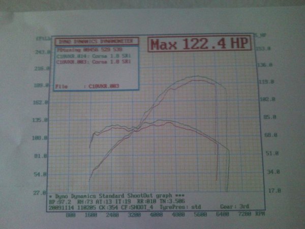

Long story short, my C used to have a dbilas turbo kit, but when it was sold, the ecu had to be swapped...
the ecu now on my car, was remapped by regal (EDS?) there was never a before read out, but rolled 139bhp on a standard engine with just a viper!
anyway, this remapped ecu made less power than standard!
made 122.4bhp on the 'remapped map' and 125bhp with the standard GM map reloaded over the map file!
mods, derestricted airbox, 1.9 astra intake pipe,
RED : 'regal map'
GREEN : Standard map reloaded!
it looks like all they had done was richen the fueling, and rasie the rev limit and scale the map to the rasied rev limit!
i dont have a afr graph, but on the standard map its going rich at the top end of the revs, which casues the power/torque to drop off
unfortantly never got time to do a proper remap

fueling isnt that far out ot be fair on the red trace, blue one is a bit rich tho.
Warren G
Registered: 14th May 06
22nd Nov 09 at 13:45   View User's Profile U2U Member Reply With Quote
red one is standard, blue one regal map lol
either somethings making it run rich at the top end, lambda poss ? or in the map
if it carried on running at 12.5 would pull nicer, as when fueling richens power/toque starts dropping
