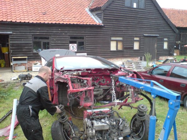

Yes I saw you pull a Honda Civic apart like it was mechano
