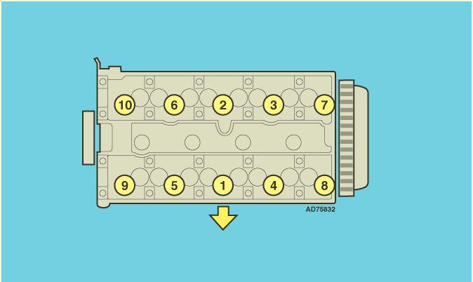

Author What order do i tighting my headbolts ? on my x16xe

8th Oct 09 at 18:41   View User's Profile U2U Member Reply With Quote
Start in a corner, then work opposites

no one no the actual order from haynes manual ?

CL4Y
Registered: 24th Apr 08
8th Oct 09 at 18:52   View User's Profile U2U Member Reply With Quote
if you started in corners will it not bend the head

you have a torque wrench i'll assume?
Tighten corner to corner, say to 7-9pounds, then round about 10-12...until you get tight enough

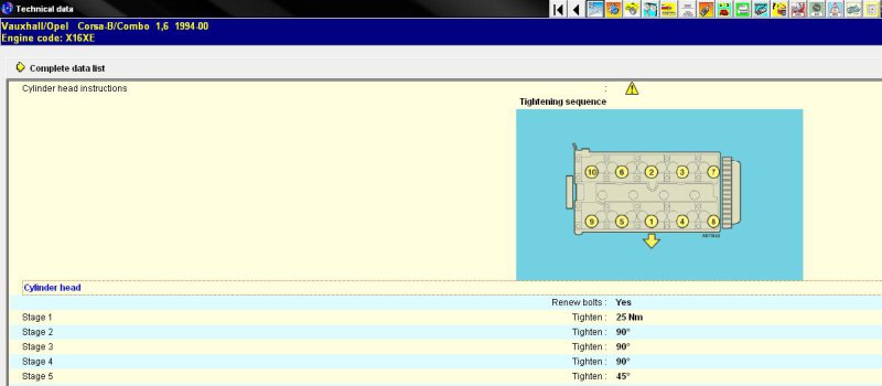

From Autodata:
gez bay
Registered: 14th Feb 08
8th Oct 09 at 21:49   View User's Profile U2U Member Reply With Quote
im glad you posted that up tom! cl4y would have a messed up head if he listened to kev.

CL4Y
8th Oct 09 at 22:54   View User's Profile U2U Member Reply With Quote
aye a relised that lads would of had a head the shape of a banana
