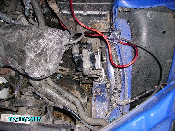

were do i find the bit on the clutch cable were i can tightn it up

On top of the gearbox on the right hand side!
Be carfull, u may cause it to slip if u mess about with it to much!

31st Aug 09 at 09:25   View Garage View User's Profile U2U Member Reply With Quote
Found this old school pic in my garage of my 1.2
The nut you adjust is the one on the end of the arm coming from under the plastic bag/cover thing
Get someone in the car to work the clutch pedal and you will see it moving as its at the end of the cable
