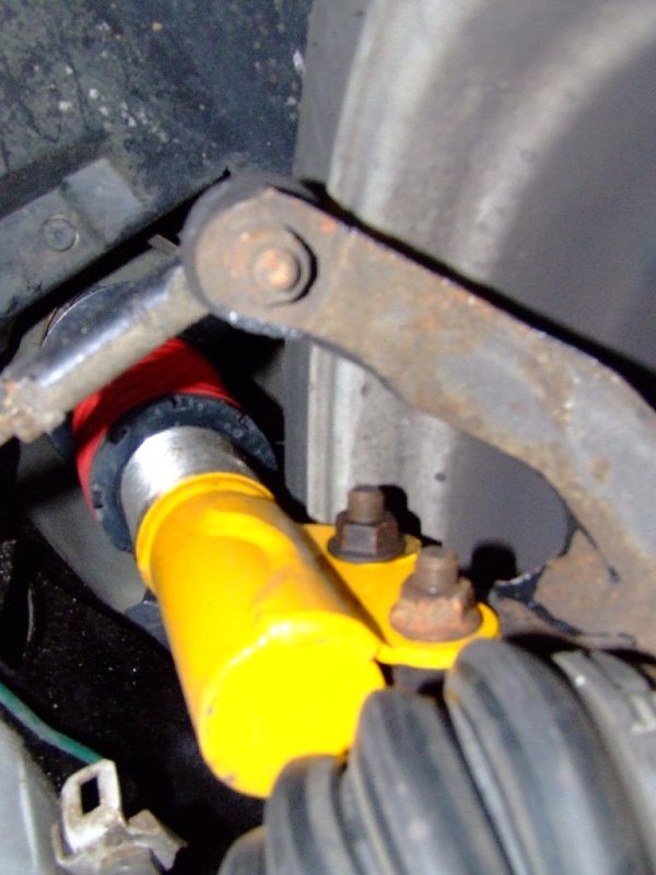

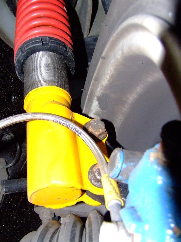

Anyways, the other night, i took a look at my fronts.
Passenger side coil -
Bags of room between coil and wheel.
Drivers side -
Er, thats not right

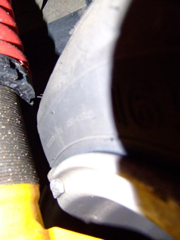

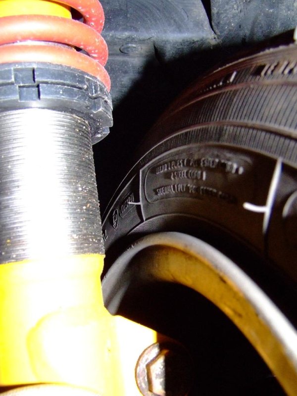

Passenger side wheel left ILLEGAL as a result -
Took it back to the garage, they said the camber was out on the drivers wheel and they adjusted something or other on the passenger side.

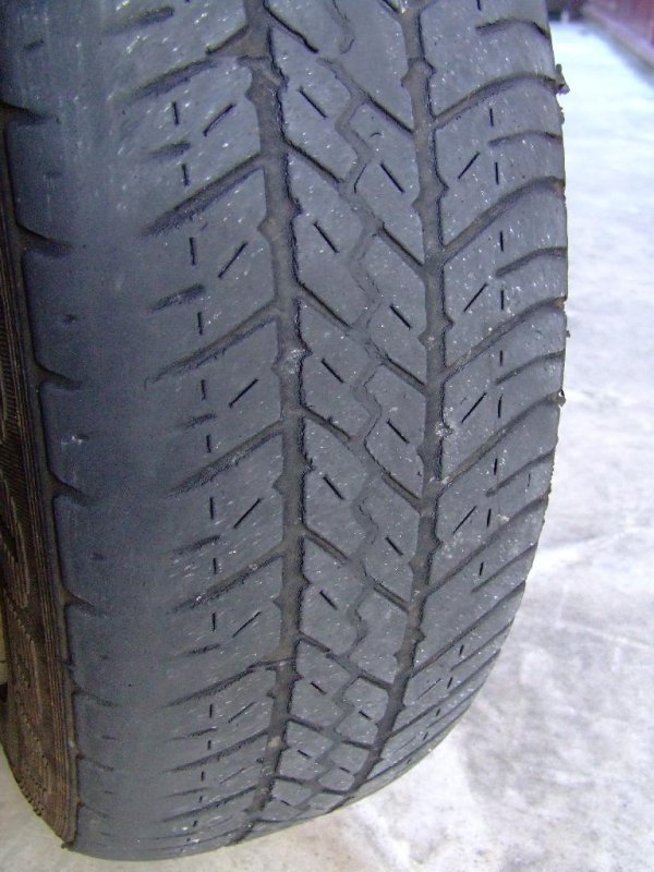

I was aware my fronts were low on tread, they were being sorted this pay day. They wont replace the wheel because of the wear across the whole tyre Even though they set the tracking so recently and they didnt reccommend new tyres then!?
Anyways, the guy said it catches on full lock - i dont see anywhere it can catch tbh when ive played with it and i cant hear a rubbing.
He said i wont sort it until there are low profile tyres on my alloys.
And i can expect uineven tyre wear because of how low its been lowered (-50mm)

There's no camber adjustment on a Corsa hub unless you have play in the bottom holes on the damper in which you case you will introduce it.
If it's not that then you then need to check the bottom ball joints to ensure they're tight and aligned.
Failing that, check the bushes where the lower arm meets the body to ensure that they are uniform. Shouldn't cause that much camber but it's worth checking.

There are a total of five parts bolted together to make your hub assembly, wear in any of these will move the wheel relative to the car.

if it has elongated holes and the camber isnt set up exactly, the old school tracking method will not work. it needs to be put on a hunter machine or similar which isnt cheap but it will get set up properly

Top hole might have been elongated.
Best pic i have of it.

14th Aug 09 at 00:22   View Garage View User's Profile U2U Member Reply With Quote
Yeah they're elongated, same as the FKs.
The problem you'll have going to a proper place is that camber adjustment on the bottom bolts is a bit of a ghetto way to do it. You would normally have adjustable top mounts, which you can also get for a Corsa if you wanted to do it more accurately/easier.
Adjusting on the bottom holes you need to basically nip it up, put the wheel back on, check the camber and if its out, wheel back off, move it, nip it up again, check it again and repeat until you're happy. That's why most places won't get it 100%, it's very time consuming to do so as its basically trial and error.
Its a bit of a cheat by coilover manufacturers as it allows you to fit wide wheels and go low and adjust the camber to get the tyre out the way of the coil. Otherwise wheels which fitted with regular dampers which have a thinner shaft below the spring seat wouldn't then fit with the coilovers. If you're running wide wheels and a high offset then you'll be in this position.
It can be adjusted out but then you'll have heaps of positive camber which is bad news indeed.
Welding a washer on and removing the ability to adjust is also a solution, just make sure the wheels fit in the position that you choose and make sure the welding is done accurately.

looking at the pictures again its clear whats happened. on the passenger side the top bolt is almost flush against the edge of the shock mount whereas on the drivers side its completely the opposite

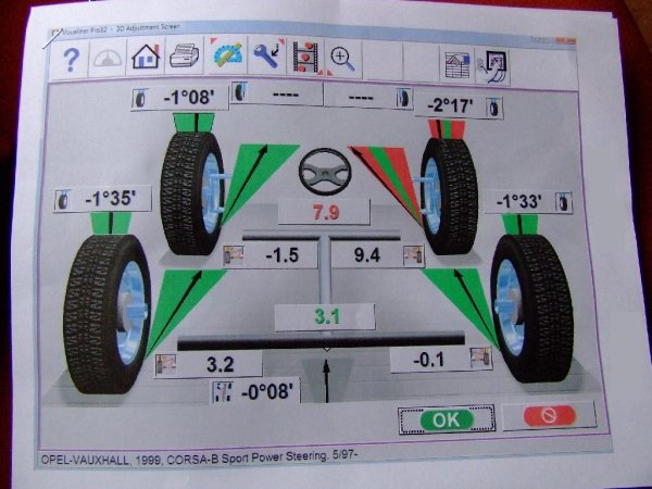

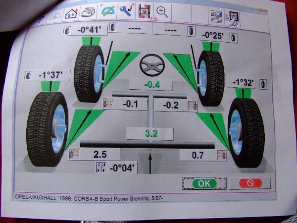

Doesnt matter anyways, i went to a different garage that offered geometric alignment and they have sorted it out - or at least look to have sorted it out.
I now have an equal space between the strut and the tyre on both sides. Not like it was above.
Thanks for the help as per usual.

Some pics of my print out.
Before -
Currently -

VegasPhil
Registered: 16th Jan 05
15th Aug 09 at 12:41   View Garage View User's Profile U2U Member Reply With Quote
Yeh that's right.
Can see why you wrecked that tyre now
