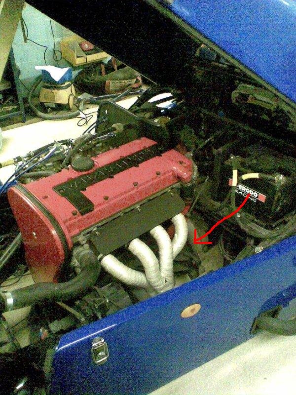

may help you a bit
[Edited on 28-06-2009 by john_c20xe]

Engine number can be found here
You may need to get the wire brush on it to make it clearer
