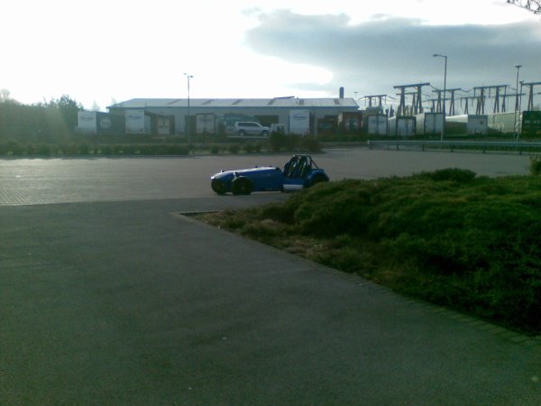

Here it is ready to go into the test
I couldn't take any more pictures incase I was a terrorist
Well the test took 4 hours and was very thorough. Needless to say, I failed first time, but the tester assured me that it is very rare a kit car passes first time. He did comment on the very high standards of build I had done and that the fail points were mostly cosmetic.

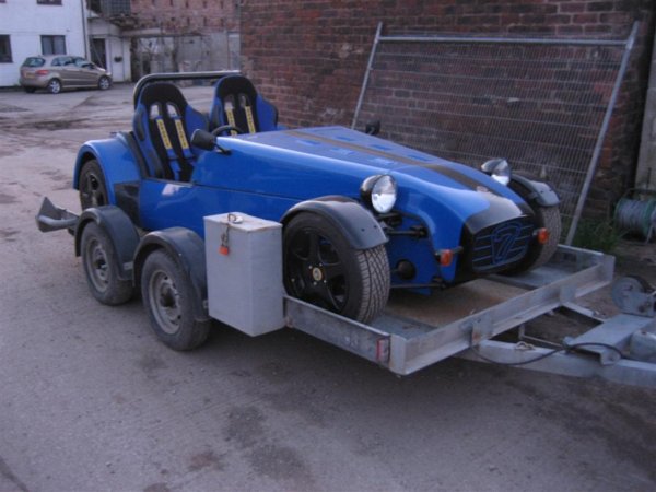

Yeah, from this:
to this:
3rd Apr 09 at 20:25   View User's Profile U2U Member Reply With Quote
the colour is lovely.
ian doesn't look too bad either
Ste
Registered: 5th Mar 03
Location: Taif, Saudi Arabia
3rd Apr 09 at 20:26   View Garage View User's Profile U2U Member Reply With Quote
Ford transit blue and gloss black. all the interior and engine bay is satin black.
