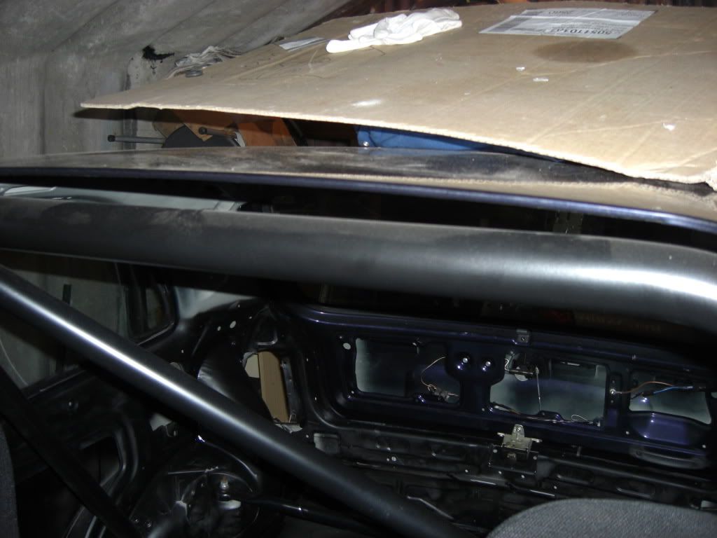

If its a normal cage, it wont fit.
The roll bar will foul the sunroof, the whole inside of the roof is lower due to the "slide" part.
mine
The problem
Good luck

defo need to chop the feet down so it's lower...
the inside roof sit's lower on tilt and slide's, like above

4th Mar 09 at 22:22   View User's Profile U2U Member Reply With Quote
Wish i'd just cut the feet down
