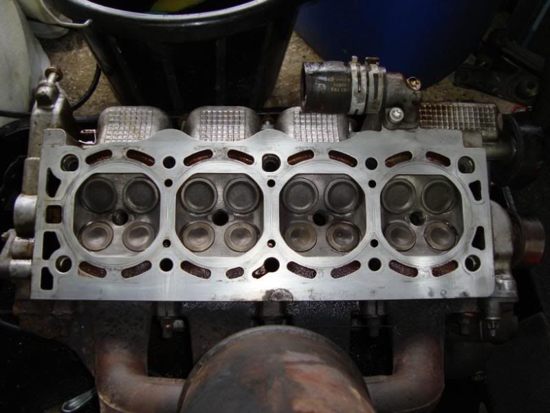

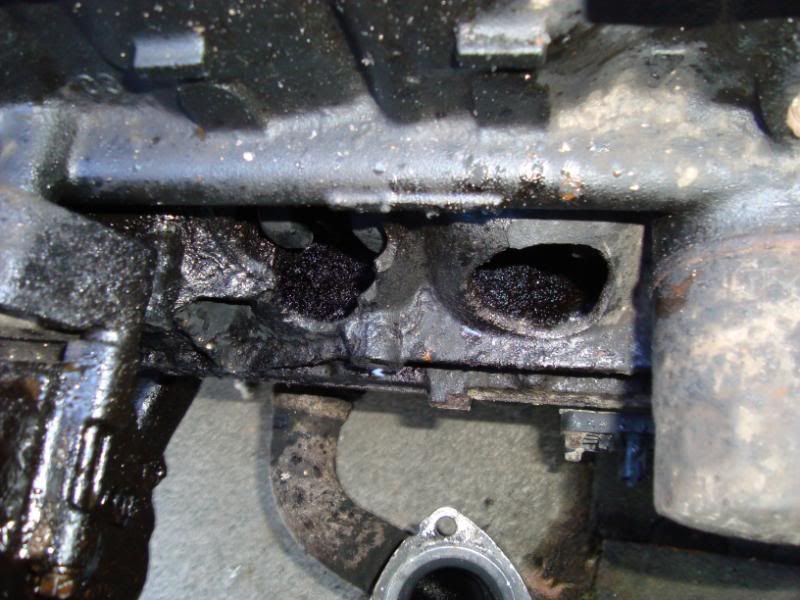

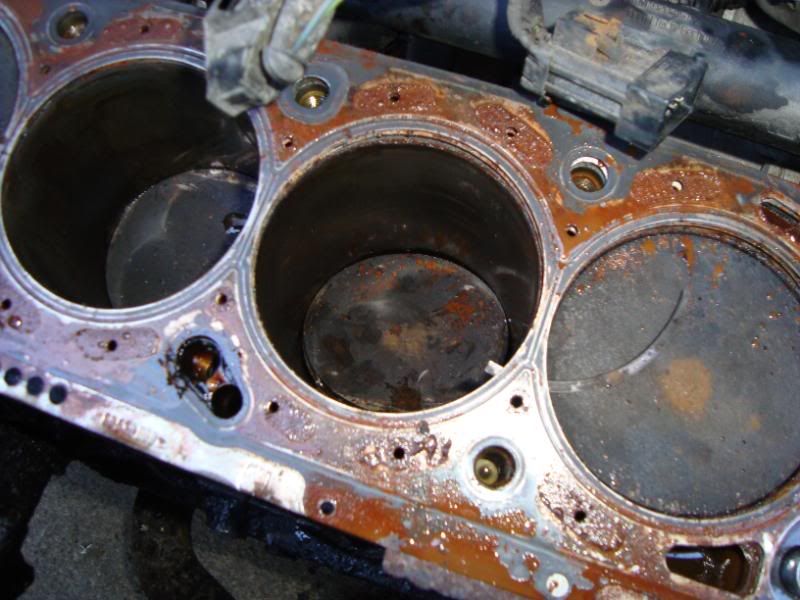

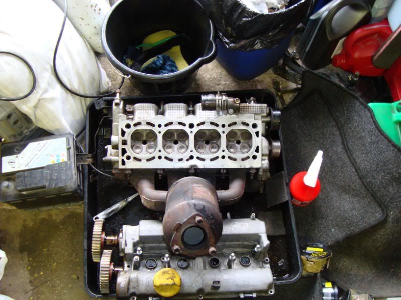

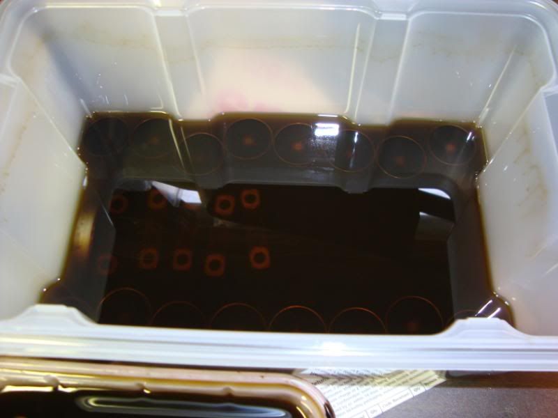

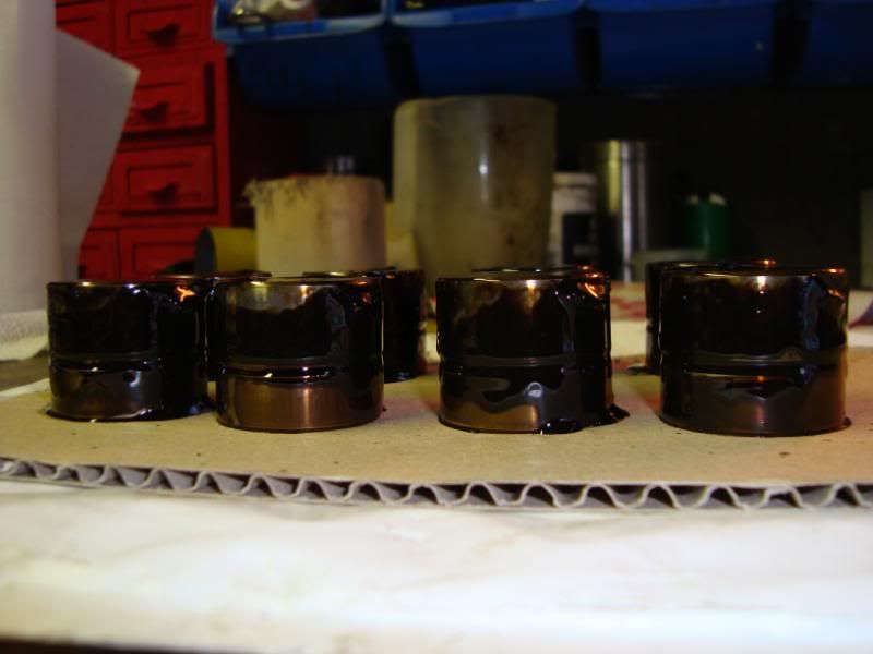

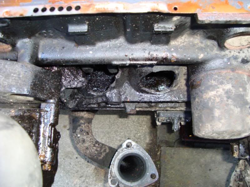

Just thought i'd stick a few pics up of my cousins 1.8 Vectra after 50k miles on the same oil
Looks like a conrod has snapped and caused this damage.

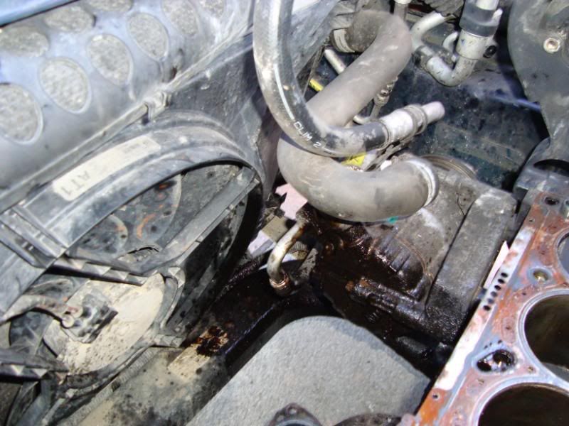

It had melted the plastic casing over some cables to the power steering but luckily not damaged the cabling so that has been salvaged.

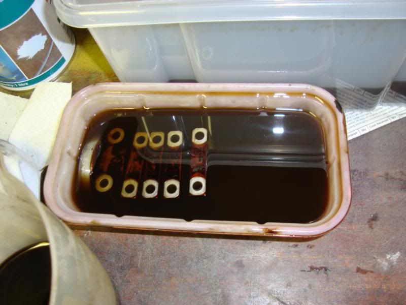

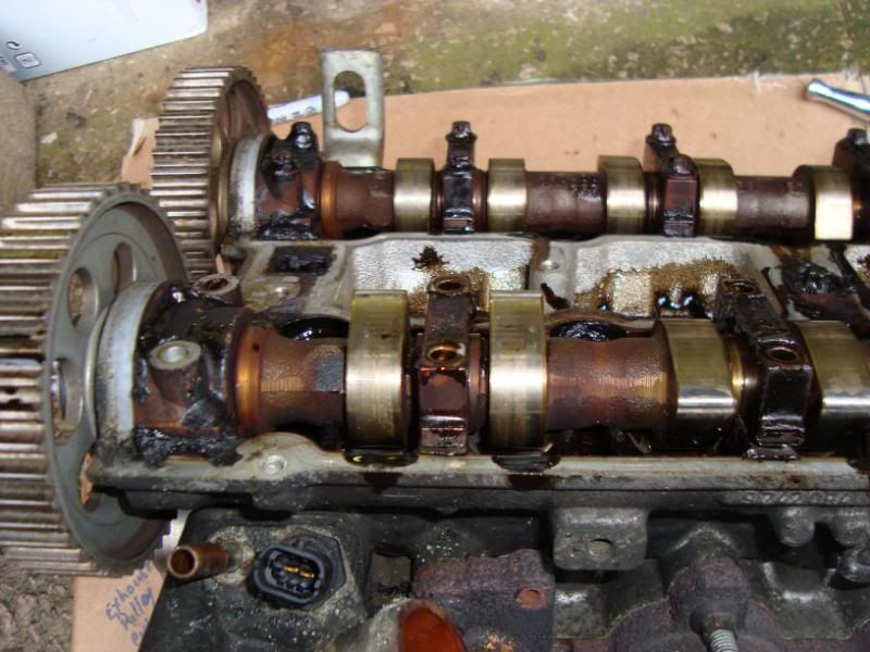

Check the oil on the lifters, It's like treacle

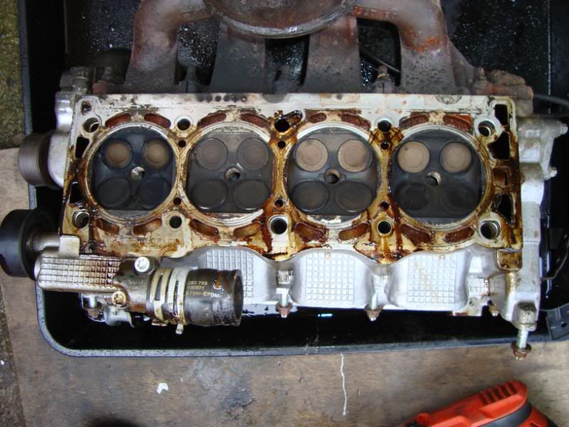

Luckily no valves were bent so I've sourced another block which his head will be going on.

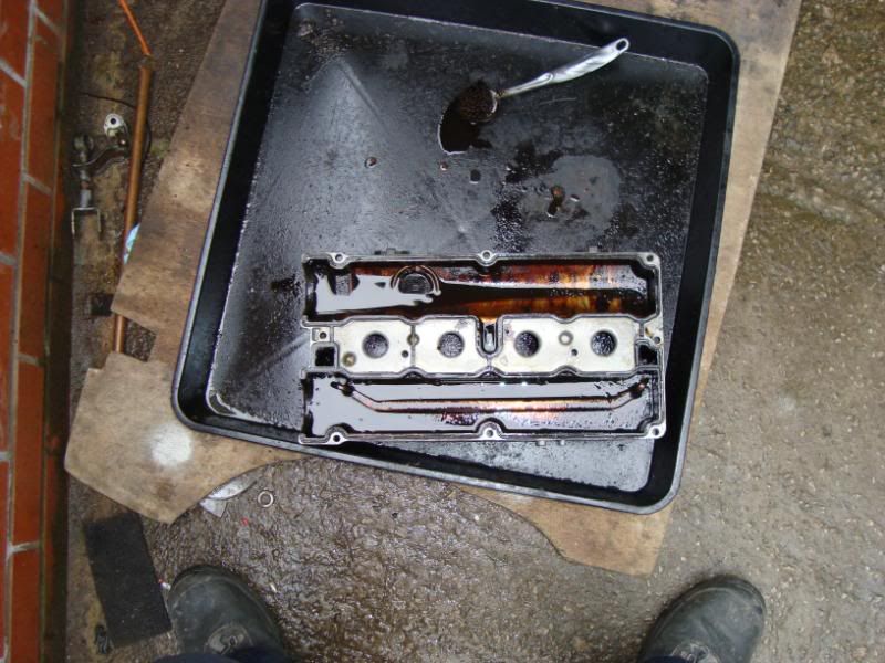

I've started to clean up the head.
Sorry for all the pics

tbh I haven't stripped the block down yet so don't know exactly what has happened, However if you look through the 2 holes in the block you can see the crappy old oil that has coated the crank.
Cylinder 3 is my guess that's caused the damage as the piston can be pushed down so obviously no conrod attached.
I'll bet he didn't check the oil much if at all but I haven't seen oil that bad ever, Not even in a scrapper.
Either way he's a bellend of the highest order
He has been lucky though as a couple of the valaves have hit the piston but not bent.
