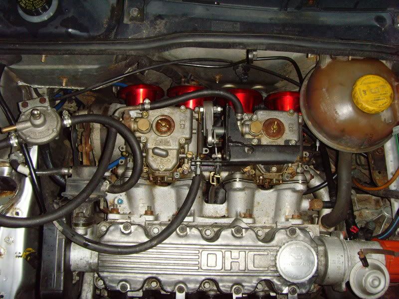

I like the filters you have on the carbs, I can't fit anything as nice as that to my 40s. I have had to get the shortest pipercross trumpets and I cover them with pipercross socks/filters. The bulkhead is just too close to them!

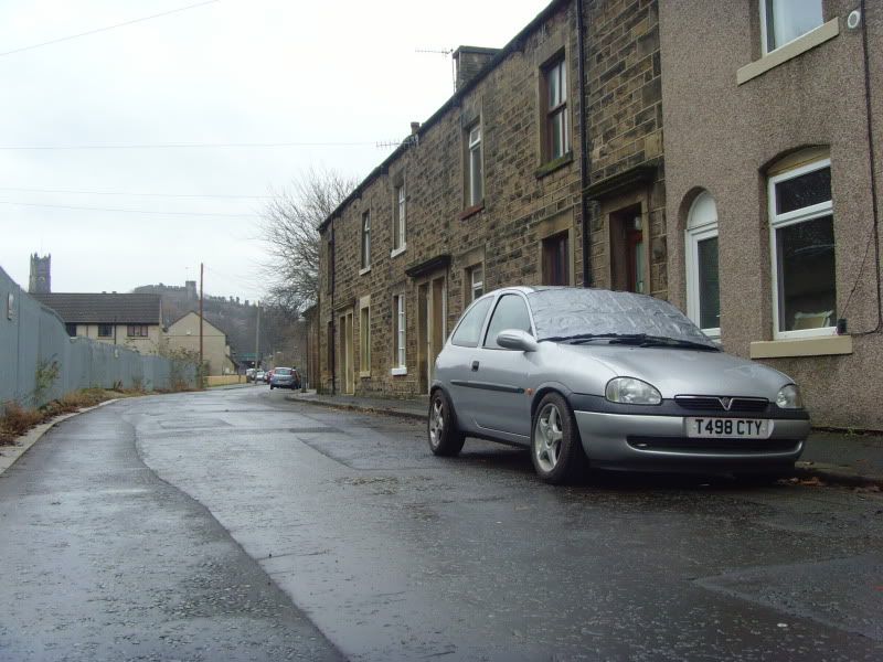

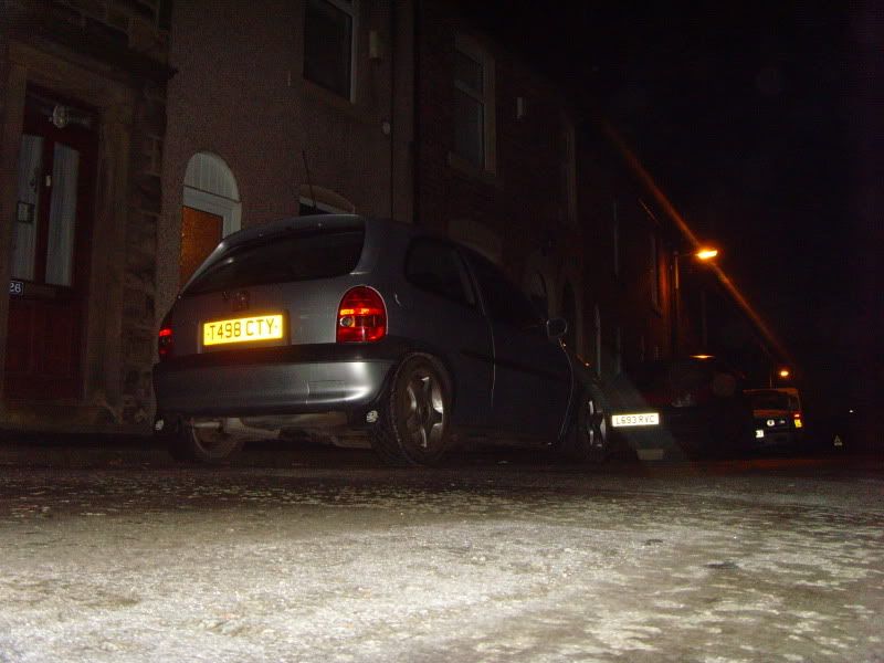

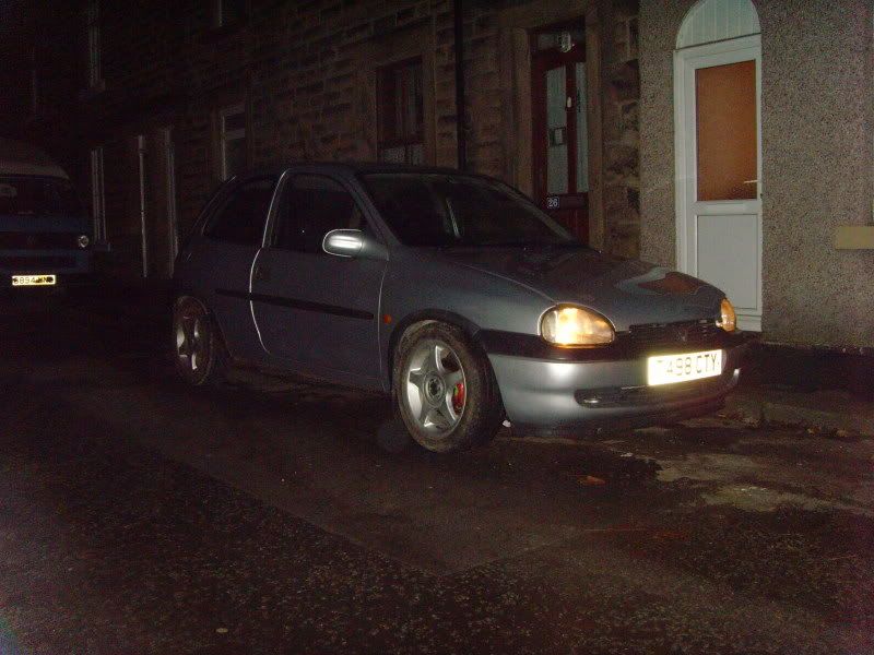

Right, as promised, here are a couple of pictures, but as I already said, the dark winter night and my camera do not agree with eachother!
It needs a wash!
It's nothing special, but when you learn that I spent £200 on this car as standard a few weeks ago with a fooked engine, and bought a second corsa (again with a knackered engine) for £100 just 2 days ago which had the wheels and suspension on... Bargain!
Christmas wish list is simply upper and lower front strut braces, and then in a couple of months, a high lift cam.

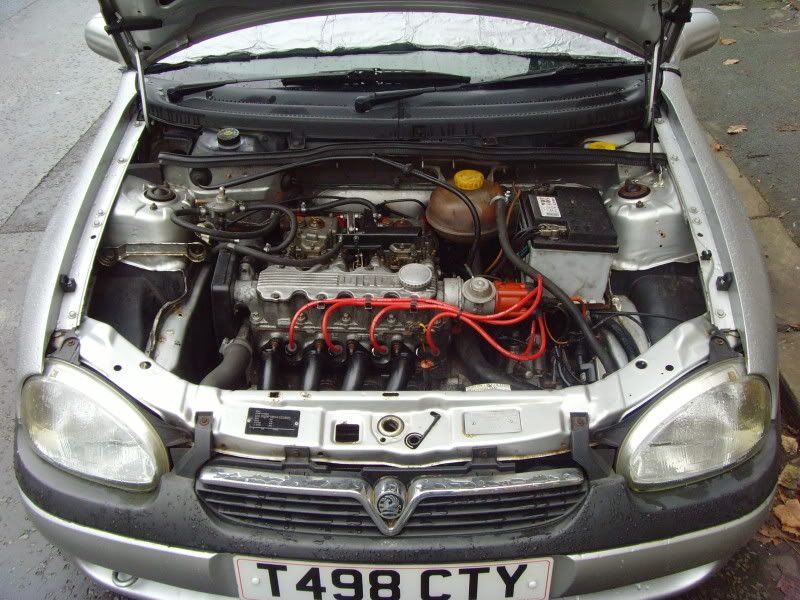

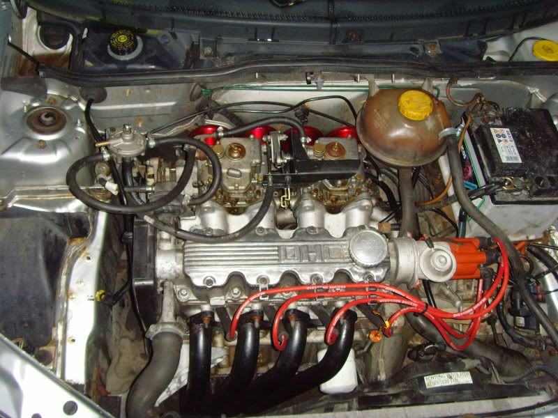

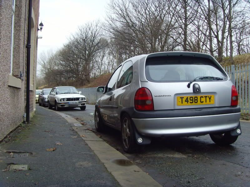

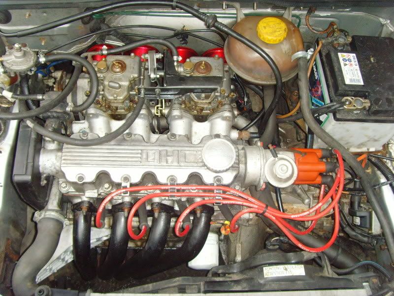

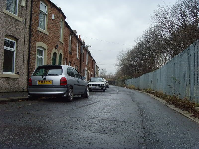

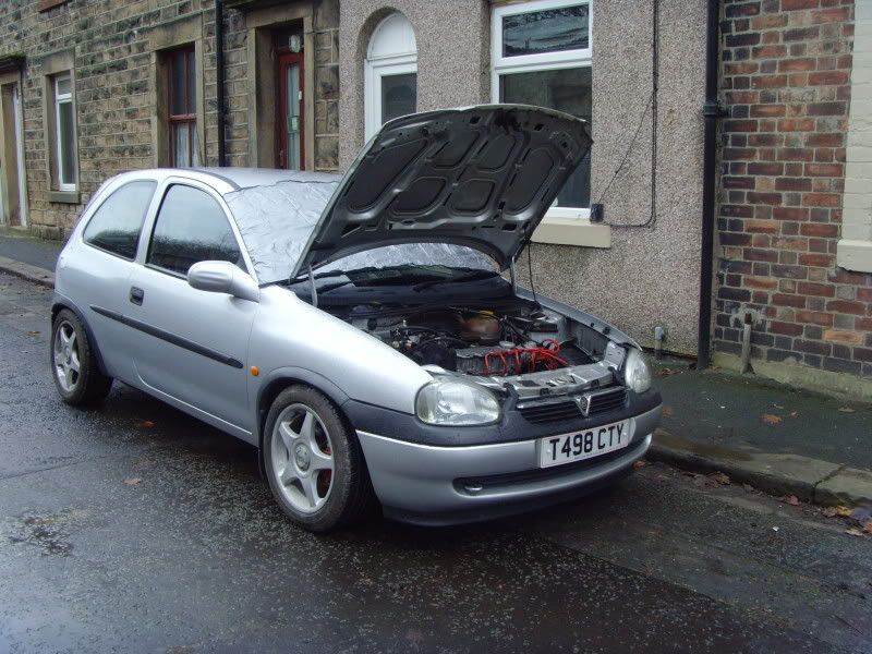

Daylight pics!
The car cost me £200
A donor car with the wheels, suspension, a load of things like bucket seats that I am selling, and a decent exhaust on it cost me £100
Engine cost me a LOT but I spent that money 4-5 years ago, so I just had to fit it, which I did right there in the street

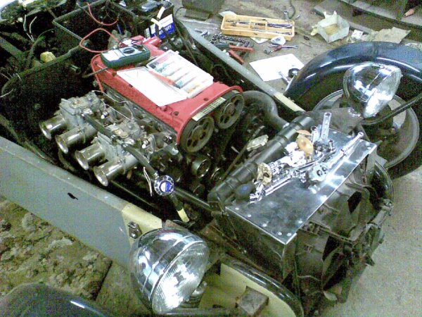

Anyways, yea...here is my GSi wit a 20SEH running 1999 R1 carbs. Sounds great but i have yet to drive it properly.
