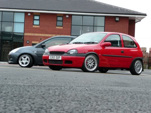

RMs...

27th Nov 08 at 13:32   View Garage View User's Profile U2U Member Reply With Quote
RSs, still no E30s or E50s.

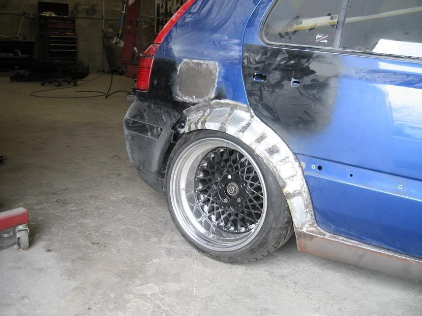

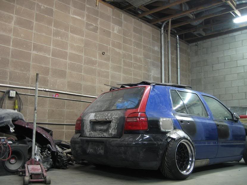

Do you think this will work on a corsa?

I'm pretty positive that width in that last pic of the golf won't fit!
Mine were BBS RM's which are two piece split rims. In standard form they are 6.5"x15 ET33. Mine were built up to 9" wide rears with a new offset of ET0 and 8" fronts with a new offset of ET13.
If i were trying to put them on standard arches, i'd try get 8's or 7.5's on the rear (offset on the 7.5's would be ET19) and 7's up front (offset on the 7's would be ET25) with 165/50 tyres all round. Hope this helps

that wall next to the golf looks strong.
got poke?
