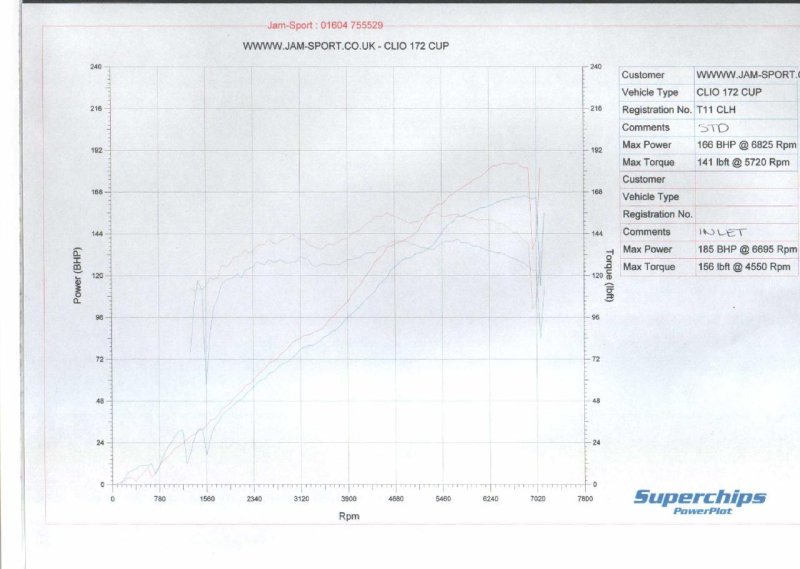

did a bit of work on the clio last night, people have always been saying the standard inlets are rubbish, very poor matching etc. so i took the liberty of finding a spare inlet and matching it, open it up to match the head etc...
to be honest i was impressed with the gain, but it matches what everyone else says.
i also added a new exhaust at the same time so i dont expect the gain to all be from the inlet!
as standard the car was:
166bhp 141lb ft
with matched inlet and cat back yozza sport system:
185bhp 156lb ft
***awaits rollers are out comments***

Cant argue with that. Was thier a big difference in the inlet size?
broster
Registered: 6th Dec 02
Location: Drives: E39
18th Nov 08 at 08:58   View Garage View User's Profile U2U Member Reply With Quote
yeah, each runner was 46mm on mine (had an elusive RS inlet) now they are 50mm, but its the step that there was on it to the head that caused the main problems

Nice gain in torque.
There is a lot of scepticism towards this mod but this silences the critics

Most of that gain will have come from matching the inlet, you can tell by the shape of the graphs. Good result!

yeah, the exhaust is a 2.5" bore on it now but still have the standard cat in there

when we do ported heads on the small block xe we match the inlets, they arn't that far out to be honest, id be suprised if the gain was as significant. will to do before and after runs on one if someone supplied a car and spare inlet

correct me if im wrong but wasnt it a modified inlet that was fitted to the 182's to bring them up to 182bhp from the claimed 172bhp the 172s make?
cams and map sounds good aswell, go for that next
broster
18th Nov 08 at 13:46   View Garage View User's Profile U2U Member Reply With Quote
mk4 astra, it was the exhaust manifold and system that made the main difference between the 172 and the 182.
GSI 16v, i dont normally expect gains from an exhaust on its own, especially if there is a standard cat still in place
