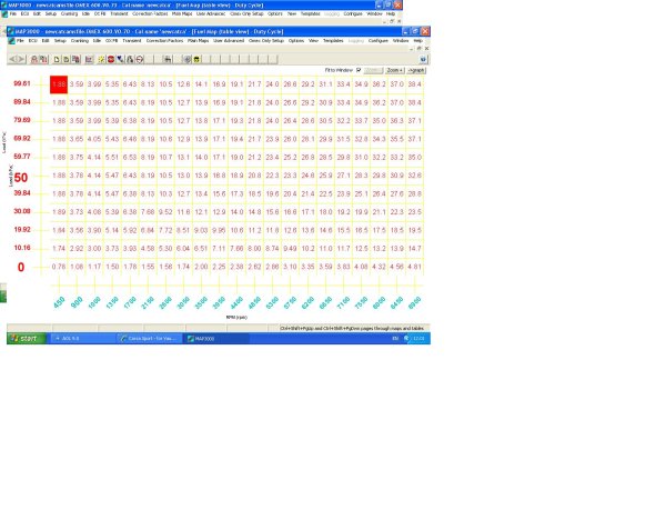

we do a LOT of these:
http://www.econotune.com/

Dave A
Registered: 10th Dec 03
26th Jun 08 at 10:53   View User's Profile U2U Member Reply With Quote
We map economy points into most road cars we map, only at low throttle sites in 4th/5th gear at whatever Rpm 30, 50 AND 70-80MPH (or whatever suits the customers driving) so long runs onb motorways, dual carriage ways and round town mean a decent saving in fuel over standard. But if you drive it hard everywhere then you wont see any gain in MPG.
I mapped an economy point into my ecu on the way back from PVS @ whatever RPM 75 mph was in 5th (3850 I think). on the way there I got 29 mpg and I got about 45 mpg on the way back after altering a few of the fuelling sites

Thats a clever thing to do. Hows that accomplished then? Worked into a certain rev band or something?

Dave A
26th Jun 08 at 11:09   View User's Profile U2U Member Reply With Quote
this pic is a typical fuel map:
the numbers relate to the injector pulse duration (how long the injector is open each time it fires)
on the bottom is the engine RPM and on the vertical line is the engine load (throttle position in this case)
by working out your throttle position and RPM's at a paticular speed using the dyno you can identify the typical load sites that would be used under varying driving speeds, can even simulate slight inclines (hills) in the road. Usually throttle position under cruising speeds is between 6% and 20% so you can accurately map in some economy at any given throttle or RPM amount. the top 5 lines of data are rarley mapped for anything except power.
