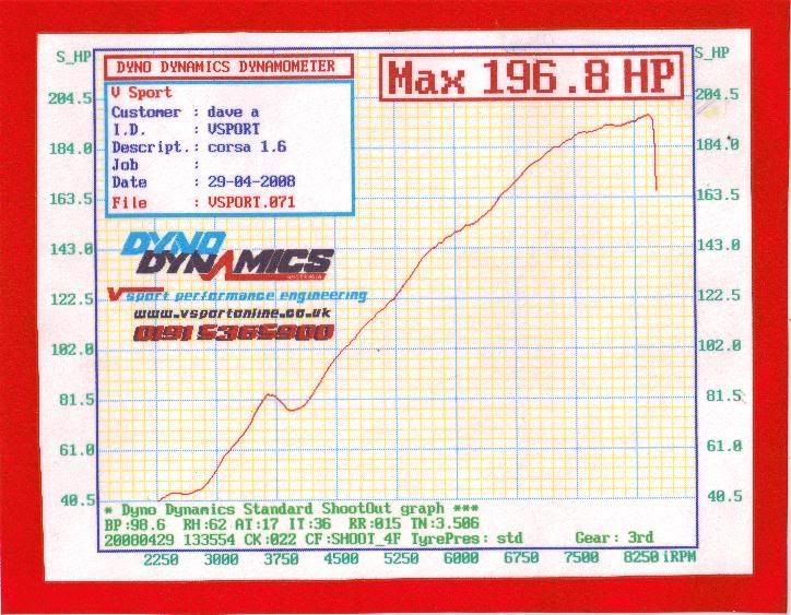

spec is:
1640cc
wossener forged pistons
Steel conrods
lightened and balanced crank and flywheel
standard oil and waterpump
jenvey twin tb's (45mm)
90mm trumpets
ITG sausage filter
Vsport 30 degree inlet
c20xe blue injectors
extensive headwork
Ivey 1 piece stainless valves
Solid lifters
double valve springs
Vsport spring platforms
O.E forged upper spring retainers
Custom cams (12.5mm lift 290 degree inlet 12mm lift 280 degree exhaust)
Kent vernier cam pulleys
SBD cambelt rollers
Fixed tensioner (cambelt tensioned by waterpump)
SBD alternator
ARP conrod bolts
ARP head studs
Cometic head gasket
Vsport high spec 4-2-1 manifold
Vsport 2.5" twin box exhaust system
Omex 600 ecu and loom

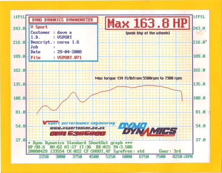

the dip at 4000 rpm is down to cam timing, a bit more mapping will iron it out a bit but its not noticable on the road.

Looks good Dave, that the same kinda power as you had before the rebuild though isn't it?
I guess the delivery is much better etc, just expected the peak figures to be in the 200's tbh.
Nice power and torque figures from an N/A 1.6 though!!

I'm gonna be honest, I'm a little underwhelmed by the power/torque figures
Can you not continue to map higher? Or have you decided that the BHP gain isn't worth the reduction in engine life/reliability?

it will rev and make power to 8900 rpm. makes 208 bhp up there but the torque was dropping off so didnt bother. as it is (apart from the dip at 4000 rpm) it is a nice drivable engine with power everywhere in the revs and pulls hard everywhere. Its not all about peak bhp, its more about what happens between 0rpm and peak. If you go chasing bhp figures whilst mapping you can quickly forget that you spend virtually no time at all at 8600 rpm in the real world.
also, 164 bhp @ the wheels is going to be fun

and on a more productive note, the dip at 4000 rpm is now gone
Nick-S
Registered: 3rd Mar 04
29th Apr 08 at 16:12   View User's Profile U2U Member Reply With Quote
weres it gone
Dave A
Registered: 10th Dec 03
29th Apr 08 at 16:13   View User's Profile U2U Member Reply With Quote
it wasnt a cam timing issue as first thought, it was a mistake in the fuel map. now pulls hard from 2700-8600 with no dips or flatspots.

Have you got a pic of the latest map?
29th Apr 08 at 16:38   View User's Profile U2U Member Reply With Quote
oh my. I bet this will be awesome on a track.
Any idea of the power to weight ratio considering the car is fully stripped with perspex etc?
Dave A
29th Apr 08 at 16:51   View User's Profile U2U Member Reply With Quote
looks identical to the graph above but without the dip.
