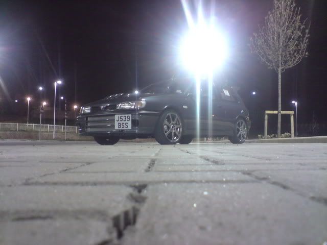

Ive just sold mine and to say im gutted isnt a lie.
Theres alot of horror stories about them but if u look about and pay good money for a good example u WILL get a good 1.But if ur looking at 1s for like £1k,dont expect it too last long.
Ok on standard internals u can run up to 400bhp IF its set up properly i.e fuelling and the likes.Standard T28 will be maxed at 350 tho.The SR20DET is a good engine but it needs to be looked after with regular servicing and oil changes.The gearboxes are quite crap but as i said if u get a good 1 thats been looked after it will be fine.The reason they break is new owners tend to launch them from 6k and above on a regular basis resulting in it firing cogs thro the casing.But tbh u dont need to launch them unless ur on the 1/4mile.
Also the standard brakes are crap but u know that anyway.
If ur buying a standard 1 and are planning to up the boost to 1bar u will need an organic clutch,walbro 255lph fuel pump,cooler plugs,FMIC(not essential but standard TM does suffer from heat soak) and possiblya bigger bore exhaust and filter.
To give u an idea i just sold mine for £3500 and it was well specced with all the right upgrades to make it a very cappable fast road/track car.Infatc i let my mate take it around Knockhill a few months back and the only thing keeping up(he couldnt pass tho)was a E46 M3 CSL thats up at every opportunity whereas my mate has never driven the track.
Mines was running a safe and proven 313bhp and 276lb/ft at 1.1bar.It was insanely quick.
Pics......
They are not the best looking cars,but thats what makes them desireable.U dont know what it is till uv had ur doors sooked off.lol.
